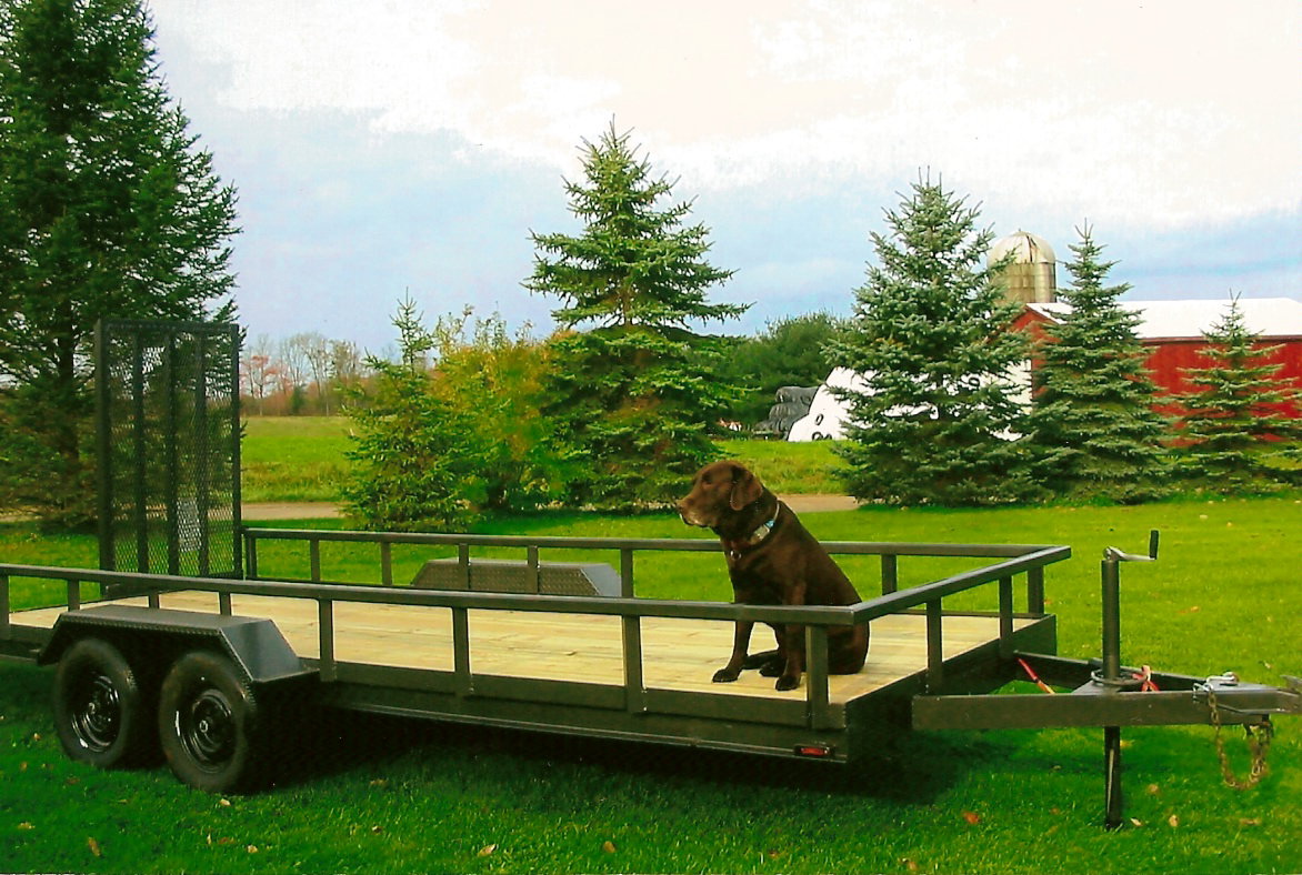

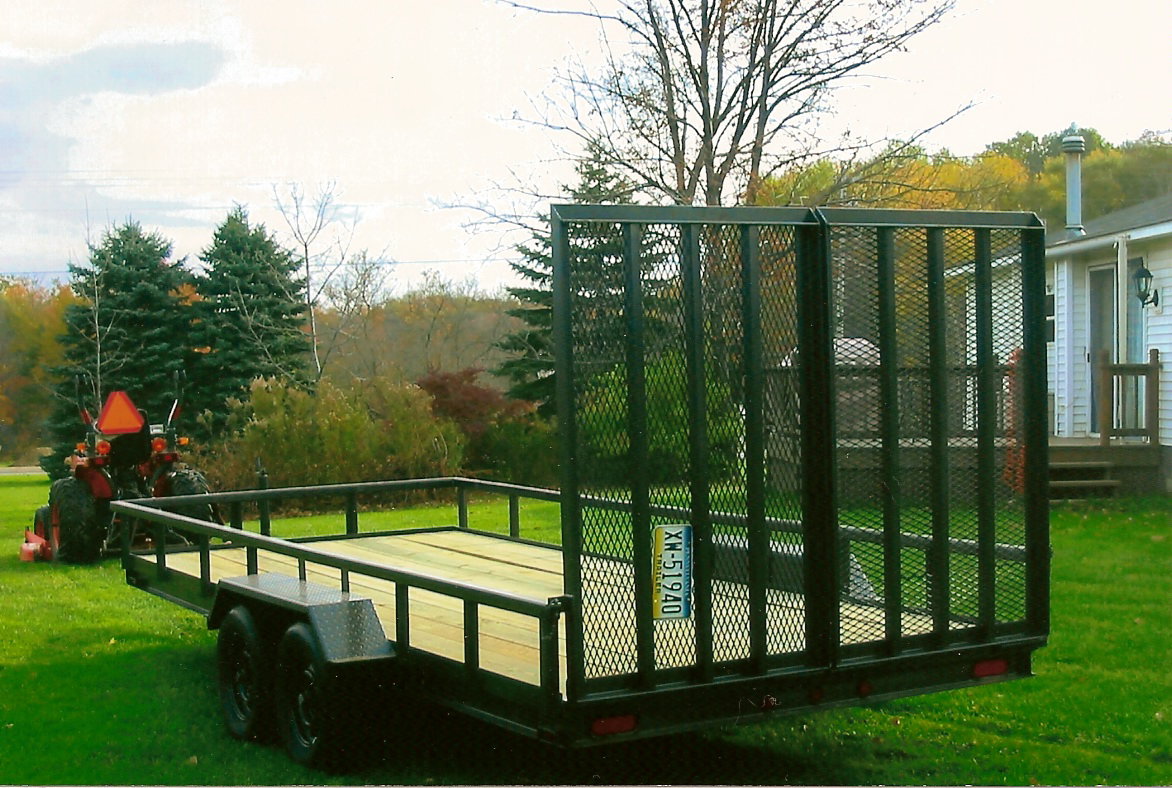

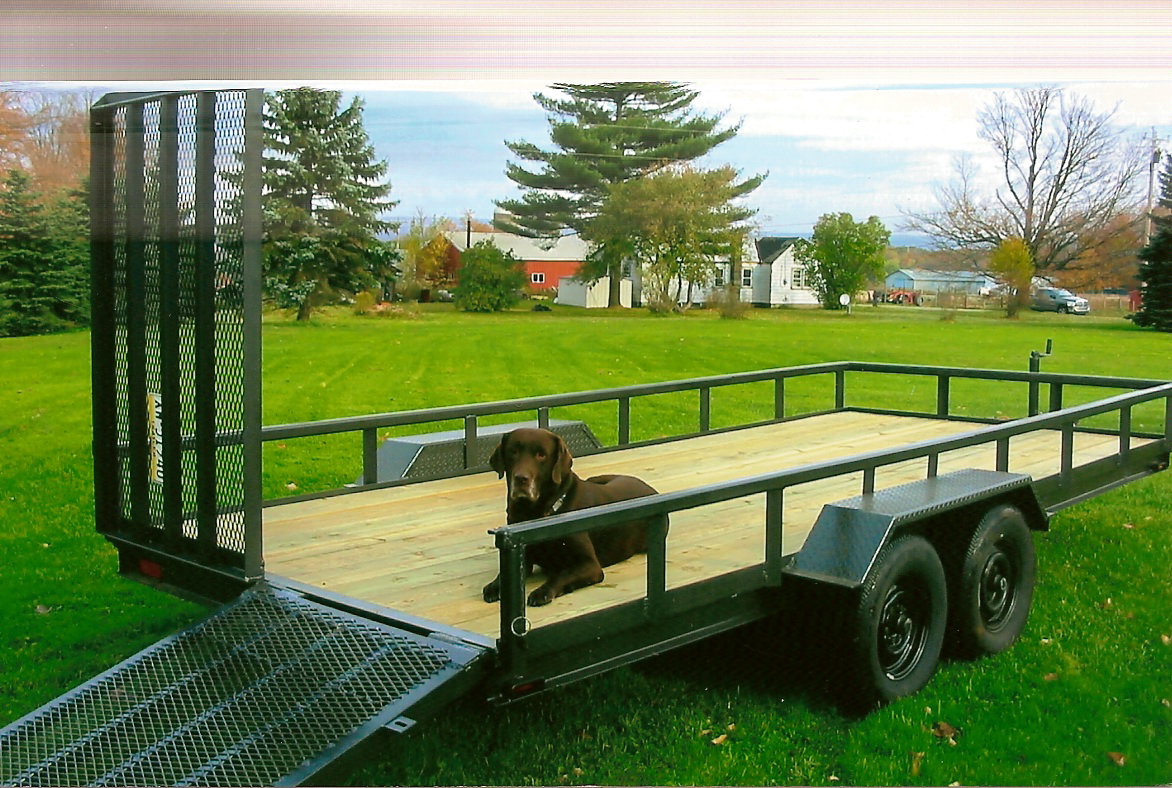

I built a 16'x61/2' trailer from an 18 foot travel trailer last year. I used the 4" c chanel that was the main frame, the tounge and axels and that was it. Where I work I can get scrap steel for .15 cents a pound and also have a scrap yard not to far from work where I used to work, (still friendly with the boss and ex-coworkers, translate good deals!!). I used 3x3x1/4" angle on top of the "c" run the length of the trailer and also about every 30"s across the width, then 2x2x1/4" square tube for the uprights and top rail. The fenders are 1/6" diamond plate that I took to work and bent in my press brake. I put all LED lights on it and all new tires, I usaed 2x8x16 treated for the deck. For the ramps I used 21/2x21/2x1/4" angle for the frame and 2x3x1/8" rectange tube for the supports and expanded metal on the field. the axels had a tag on them and was able to discern that they 3500# dexters. all told I have about less than $600 dollars in it and I pull my B7510 and 5' woods brush hog with only one problem.... the brush hog is to big for my tractor!!!!! This is a very sturdy trailer and was worth the effort to build as a new trailer that size was about $1800. P.S. That is Mocha he is my 9 year old chocolate lab. He was the forman on the job ...made sure project was on time and under budjet. Hope this helps, Ken.
