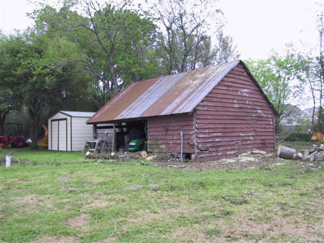

I am not sure if the local codes require it, but I thought the bigger the better. Slabs are typically designed to float here because of the drastic soil moisture changes we experience.
I see so many PHDs that are recommended for augers 6, 9 and 12" The ones that are rated for 18 and 24" are usually a little more HD and more $. It is conceivable that I could get away with using a lighter duty model to bore the 50 or so 18" holes that I plan to use it for. That is not how I usually buy tools however, so hence all the research.
Here is a little pic of the barn I want to tear down and replace. The B7800 in the background needs a home...
