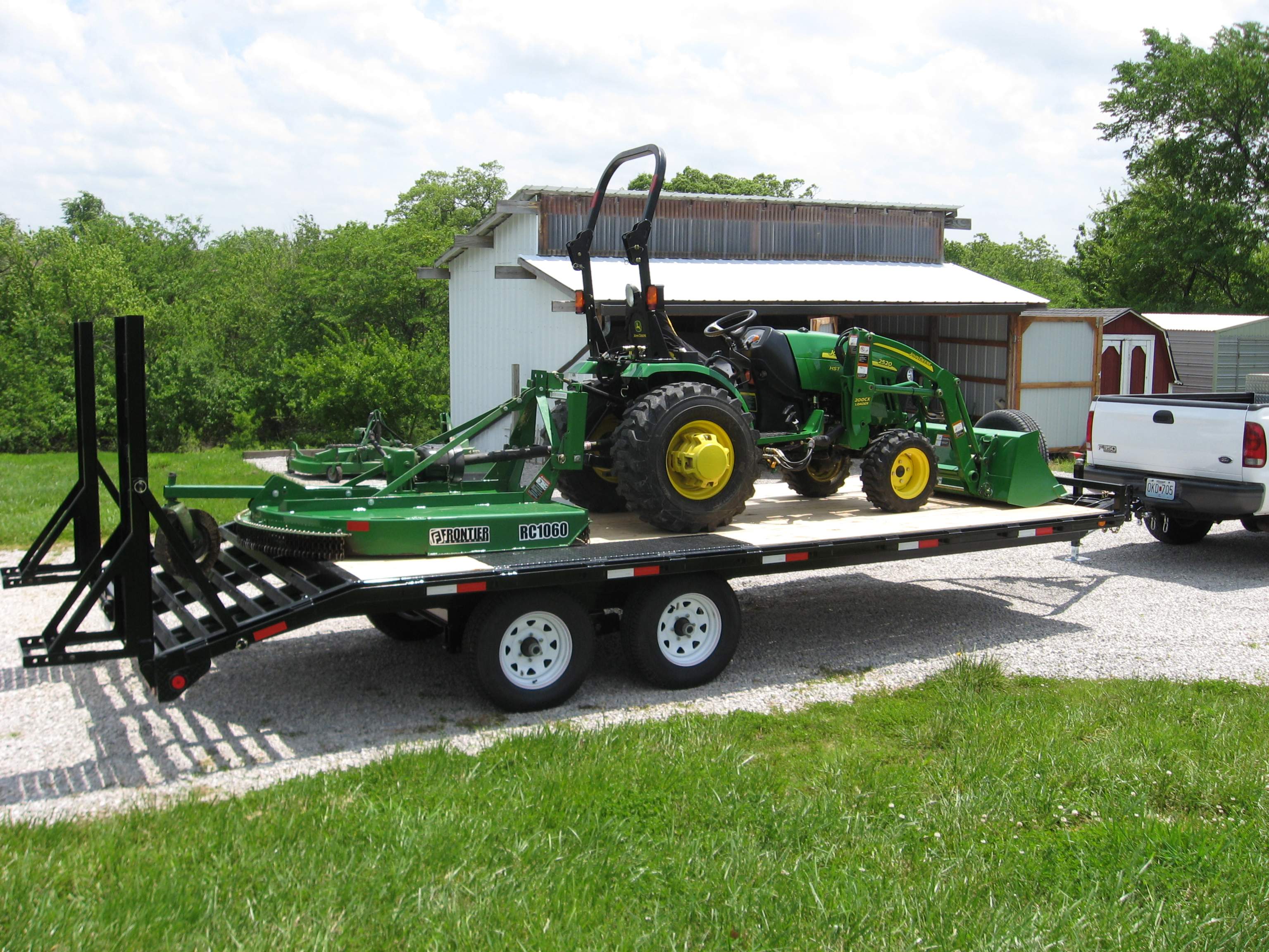

My tractor and bush hog are about 19' long with the bucket removed(but the loader still attached). I haul them on a 16' trailer with no problems, I just let the bush hog hang off the back about three feet(I do strap it down and put a red flag on the end of it). I have also hauled them on the same trailer with the bucket attached by hanging the bucket over the front rail and resting it on the A-frame. If you can afford it, then I would go with the 20 footer, but if price is a concern, then you would probably be just fine with an 18, or even a 16 footer.

I have a Deere 2520 with a FEL and rotary cutter. The FEL acts as front ballast to balance the tractor when using the cutter. Total length is 19' from bucket tip to cutter real wheel. The FEL is 2'. Can I get by with having the loader raised a bit to overhang the front of the trailer with an 18 footer, or is that asking for trouble?
Why do you need front end ballast with a rear rotary cutter?
/ 18' vs 20' Trailer #30
Because the front of the tractor will get very light when you lift the mower if you don't have any. Because of how long rotary cutters are, they can weigh less than a boxblade or some other attachment but make your front end ligher.
Ed
/ 18' vs 20' Trailer #31
yep.. the farther to the rear you go with the weight, the more mechanical advantage it has.. keeping in mind that the rear wheels are the fulcrum.
soundguy
/ 18' vs 20' Trailer #32
"Because the front of the tractor will get very light when you lift the mower if you don't have any. Because of how long rotary cutters are, they can weigh less than a boxblade or some other attachment but make your front end ligher."
...and, even when it's riding on the tail wheel, there is still half the weight (or more) hanging on the rear of the tractor. Really helps the steering to have a little weight on the front, particularly if you're turning on uneven ground and the tail wheel of the cutter is bouncing off the ground.

For reference, here's an ad photo of an 18 sitting next to a 20. The difference is minor. I never really notice a trailers length until the deck gets out past 24 feet... then they become mailbox catchers real quick.
