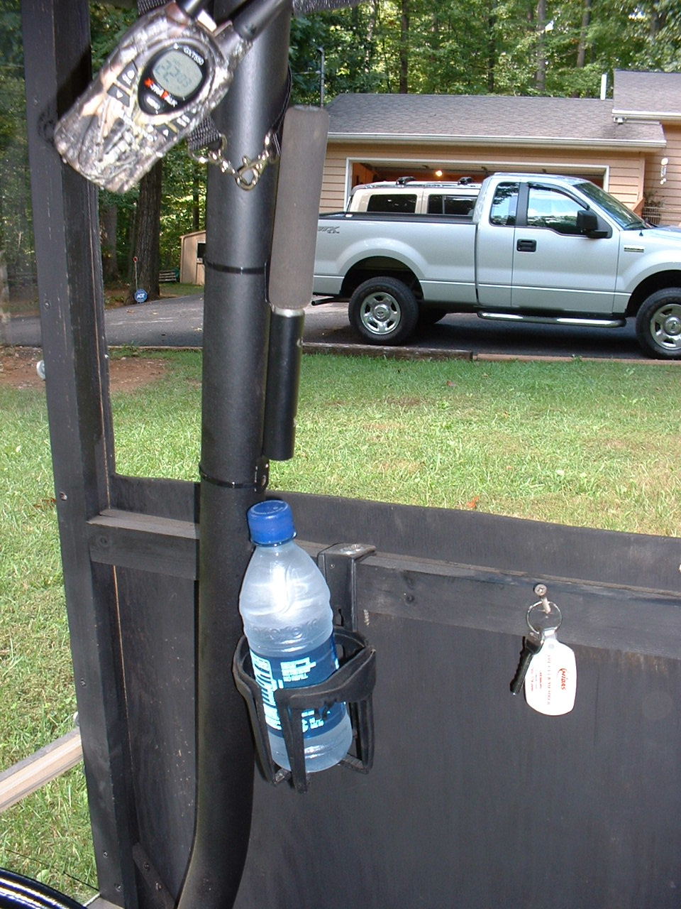

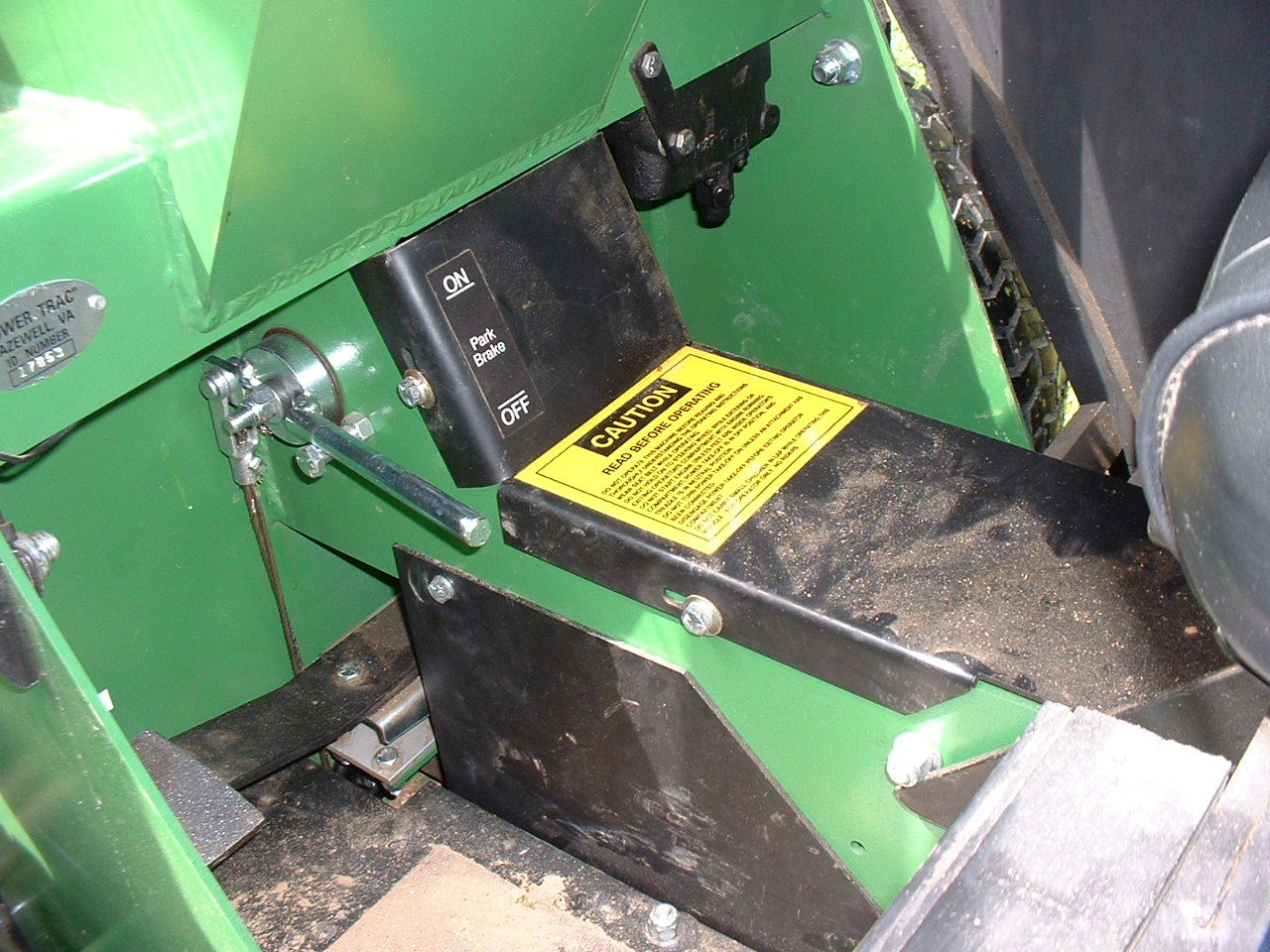

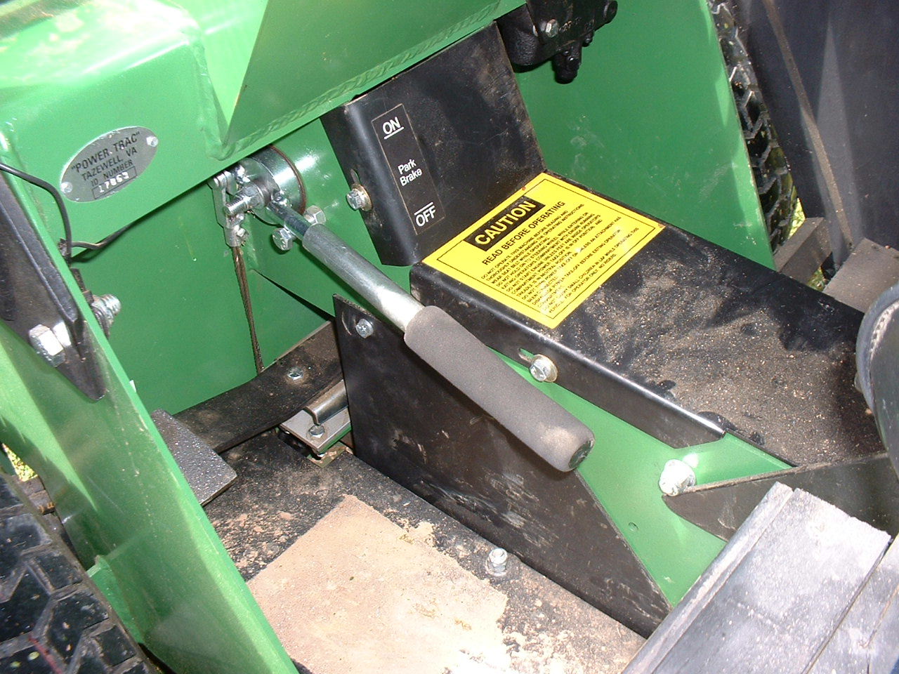

Thought I would start my own little thread for fixes and improvements for the 180. Of course anyone can jump in here with any added improvements for their particular model (no worries.) Here are a few pictures for anyone that might want to save some time on a brake upgrade.
First picture, I loosened the brake handle, and added a little grease to the black rotating plastic washer between the handle and frame, then retightened it down very snug. I then took my plastic handle off the brake lever. In my case, I just made a slit, and cut it off as I had another softer handle I wanted to use. I’m sure a bicycle handle or the original would just work fine.

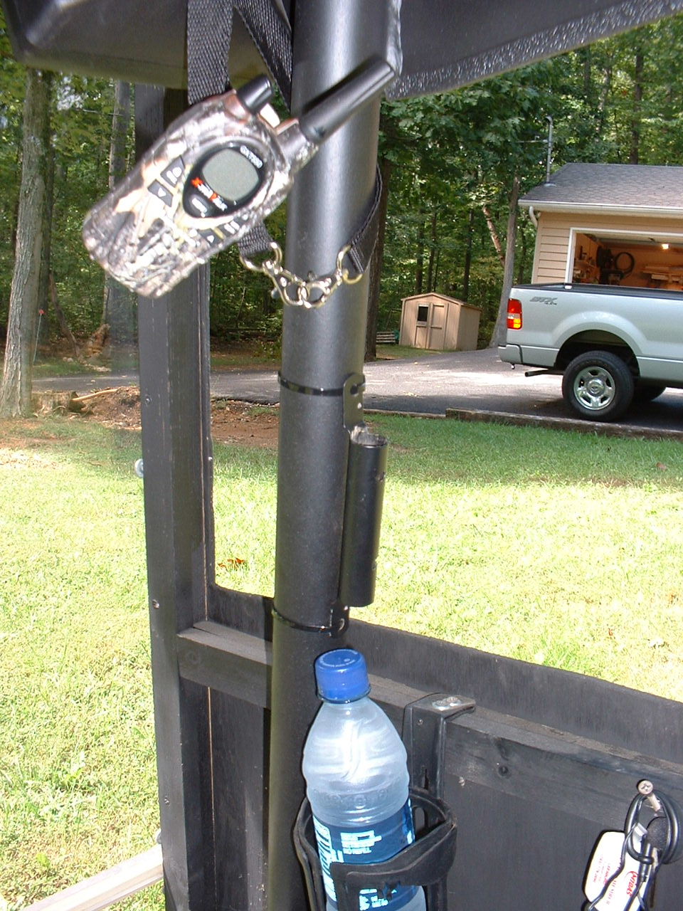

I then cut a piece of aluminum pipe to add for a breaker bar effect, more leverage. As you can see, it is well out of the way of your left foot. I then made a handle holder, and mounted it up on the ROP'S with some plastic tie strips. I didn't want to drill any holes in my ROP'S. Now when I use the brake it's very easy to use to the tenth power.
I just take the extended handle out of its holder, slide it on the brake handle lock, and unlock then back put it back in the holder when done. The lever holds secure and is easy to use also much smoother with the added grease.

Second picture with handle extention.

Third picture of extention holder mounted to ROP'S. Excuse my muddy tree stump work in the background. That is coming out so I can enlarge my driveway.

Last Picture of extention handle nice and neat back in it's holder.

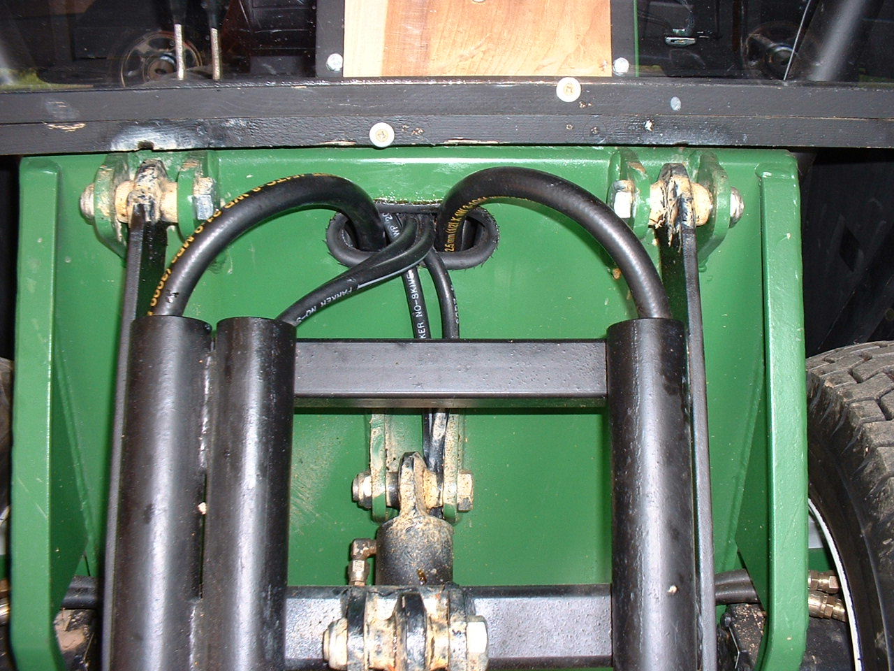

Another small improvement that has worked out really well. I may have already posted this somewhere, but I feel it was worth mentioning again. I think someone else on here, also did this?
I took a piece of rubber gas hose cut it down the middle, and lined the inside of the hydraulic hose cut out. I applied a small amount of glue that may not even be needed. This keeps the cutout from wearing through your hydraulic hose's when the you lift and lower the arms.
That is a great idea, thank you.
PJ
   / 180-Quick Fixes
Not a problem,
If you buy a precut gas hose (rolled up in a box) like I did, it works better. Install it against the curl, and it will hold in place all by it's self, if you know what I am trying to say.
I just added glue for extra hold but, I could have gotten along with out it. Also you may want to spread a little grease on the hydraulic hose's helps reduce friction and keeps the rubber hose's from pulling at each other.
I put a quick clamp on the hydraulic hose's to hold them up out of my way while I installed the lining.
   / 180-Quick Fixes #8
Barryh said:
Not a problem,
I did the same to my 422 several years ago and did not use glue. I did not use preslit hose. It is coming out now. I think the glue is a good idea.
