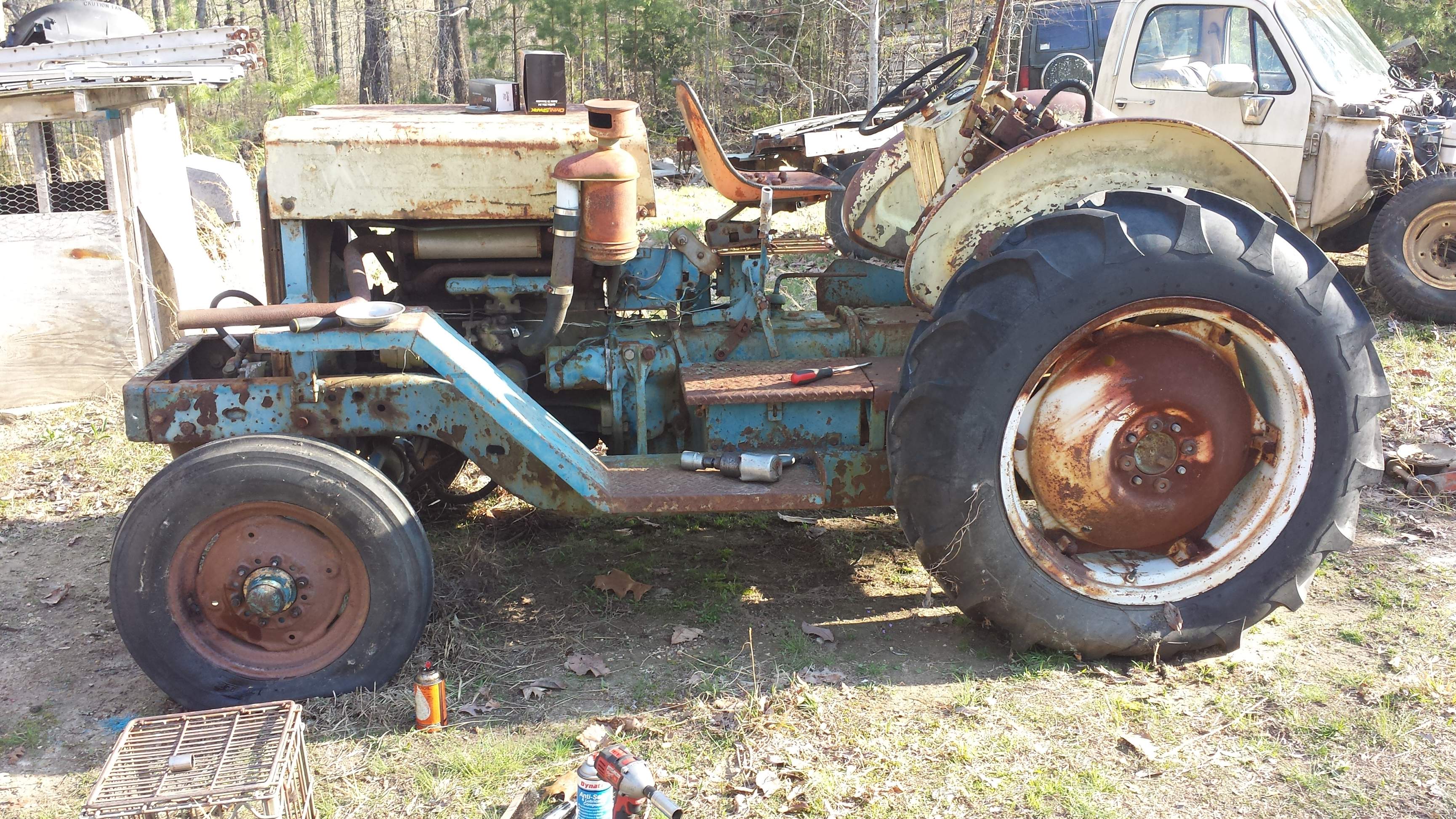

I finally got it home yesterday. It looked so broken sitting flat on the ground, I had to do something
So I dug some tires and wheels out of the shed, picked the tractor up and put them on it.
So, new points, distributor cap, coil, plugs, and plug wires and a little gas sprayed into the carb....She Runs!! I didn't run it long, though. The suction line for the front hydraulic pump is broke and the hyd tank is empty. I didn't want to damage the pump by running it dry. So, today, I am pulling the carb for a strip and dip, and going to check out the fuel tank and lines. Also going to repair the broken suction line so I can refill the hyd tank.
Mike
