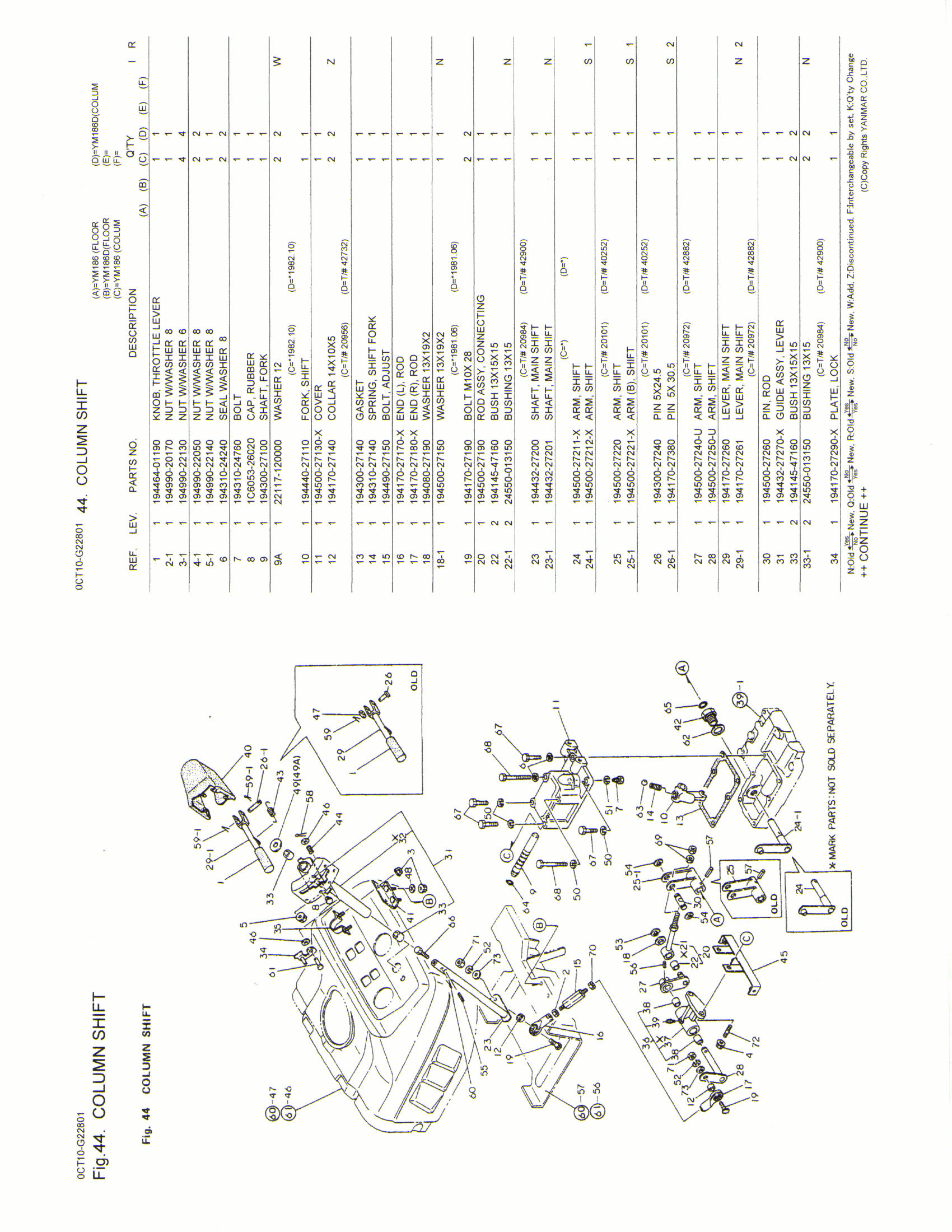

May 15, 2018 / 186d Stuck in 2 powershift dash shift #1 Pete Judd Veteran Member Joined Aug 18, 2010 Messages 1,013 Location The Thin Gravy Ranch in The wet PNW Tractor Yanmar 186d, JD 314 I hav a 186D and the dash linkage is free but the powershift trany is stuck in 2nd, any thoughts?
May 16, 2018 / 186d Stuck in 2 powershift dash shift #2 W winston1 Super Member Joined Dec 16, 2009 Messages 5,615 Location gilmer tx Tractor Bobcat CT235 I believe you have had problems with your shifter in the past. Sounds to me like you need to remove the cover (11) and have a close look at the shift fork (10) and related components. Attachments 2018-05-16-054826.jpg 741.7 KB · Views: 146
