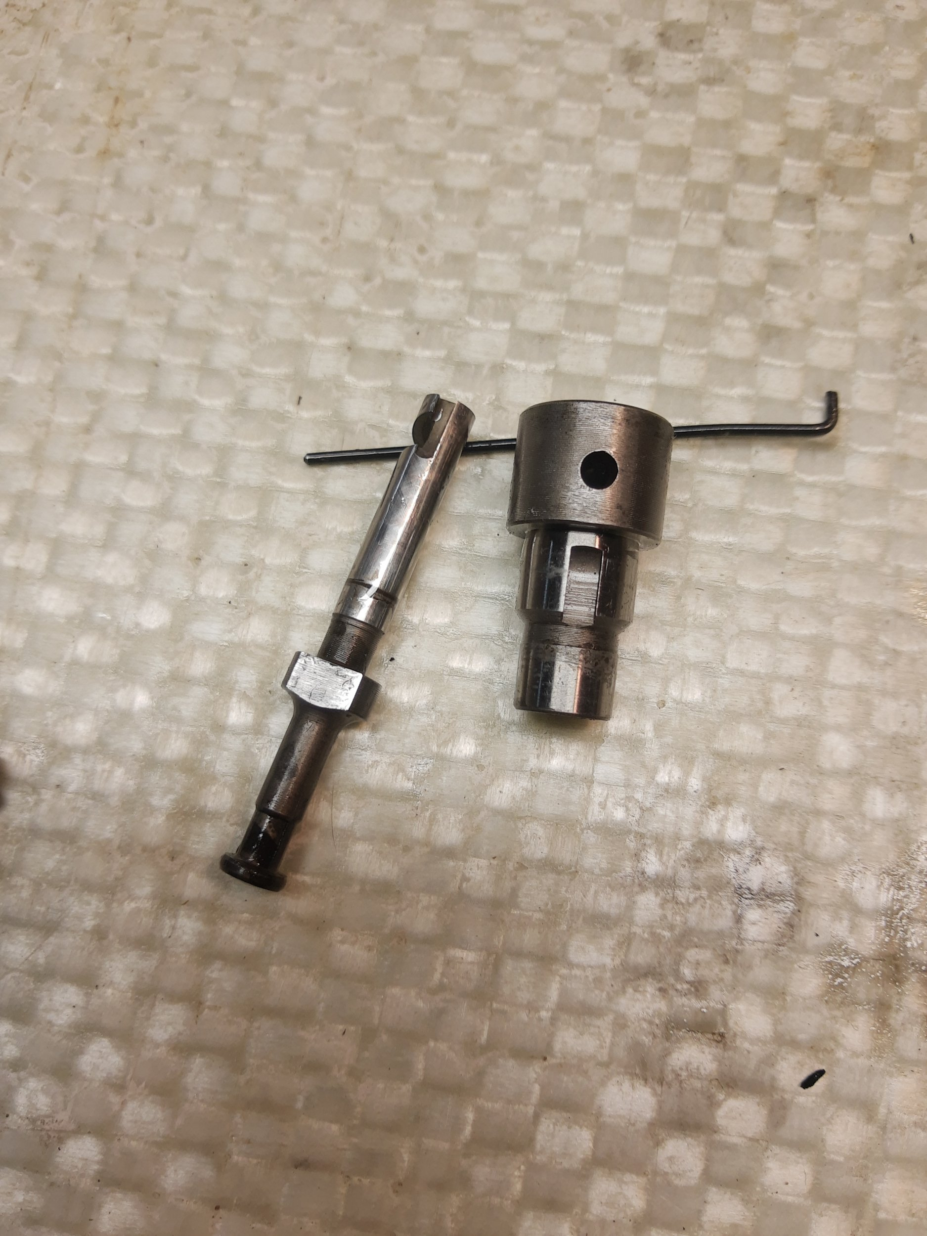

The plungers are mated to its barrel and r not to be swapped.!!
Unless u mean injectors..??

Ok, now I'm officially confused. I swapped plungers between 2-3 and reinstalled. Cranking with the lines off the pump produces a nice even pattern between all 3 cylinders. Fired it up and all three cylinders over fuel producing tons of black smoke and uncontrollable high rev. My thought is this pump was rebuild with the wrong plungers. any chance someone has a photo of part# H124950-51100 to compare?

Just eliminated the glow plug from the equation. No change. Also I just noticed in the injection pump diagram which shows 2 spacers below the pump. Mine has a very thing copper gasket only. Looks like they are available from hoye.

Those copper looking parts are TIMING SHIMS.. do not mess w them..
Another thing that’s overlooked is, if u use some type of sealant under the pump.. it must b used sparingly.!!! It will change the timing of gobbed on..

I'm still working on the plunger theory. From what I can see online, mine differ from the correct part number.

Have u thought about the theory that someone turned the fuel up.??
Your not gonna fix anything until u can get from running away..
And u can’t do that until u get the injectors checked and get the pump gone thru by someone who KNOWS WHAT THEY’RE DOING..
