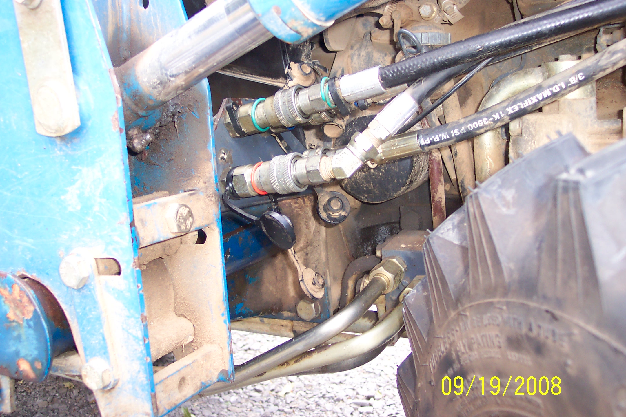

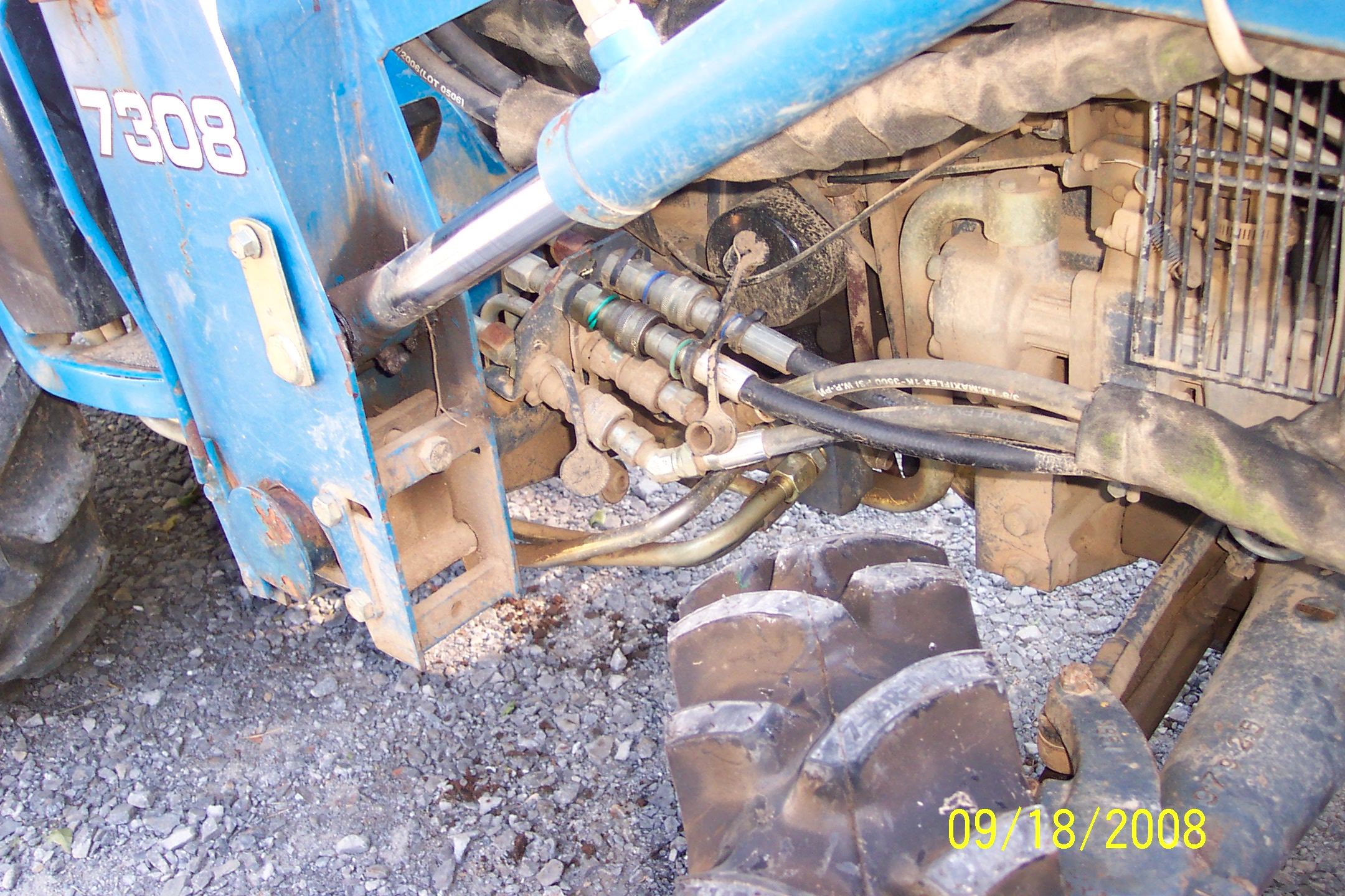

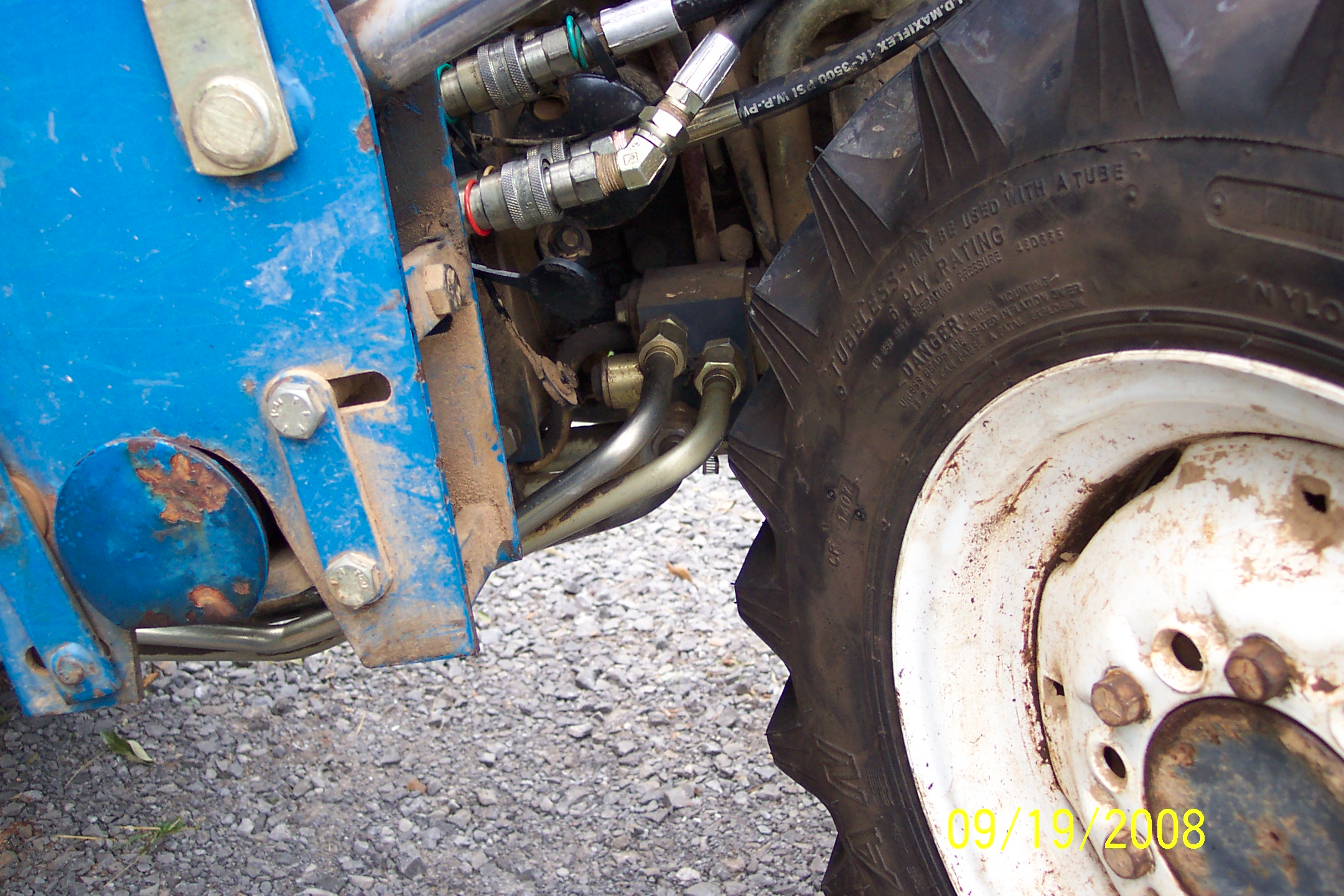

I need some help, I put a new set of Titan 7-14 R1, 6 ply tires on the front of my 1925 and when you turn full right lock, and the body is rolled full right on the front axle stop, the tire contacts the hydrualic lines for the loader.
Last time I put new tires on, I put on Firestone 4 ply 7-14 R1 Tires. I remember having to put 45 degree elbows on the lower lines to get some additional clearance, but they cleared.
I believe the cleats on the Titan's are taller.
I am almost positive that I replaced Titans when I installed the Firestones.
7-14 is the reccomended tire size for this tractor.

Do you have an adjustable bolt as your stop like the larger tractors? I know they use longer bolts to control the stop when a loader is used on the TC55 for example.
How's your air pressure in those tires? Can you reduce to pressure a bit to give you more clearance?
   / 1925 (TC33)/7308 R1 Tires hit hydraulics
Well after staring at it for a while, I just decided that over time, and a couple of breaks of the mount, the hydraulic lines have just slowly curved downward. So, the fix was to take it all apart so I could bend one hydraulic line at a time (I could not pry them all up at once) and straighten out the bracket and just "do it right".
So, no fun, but other then a cut o-ring when I re-hooked my hydraulics, and some serious head scratching when I dropped two hydralic tubes at once, that were not marked it went ok and is back out and working on the job site.
