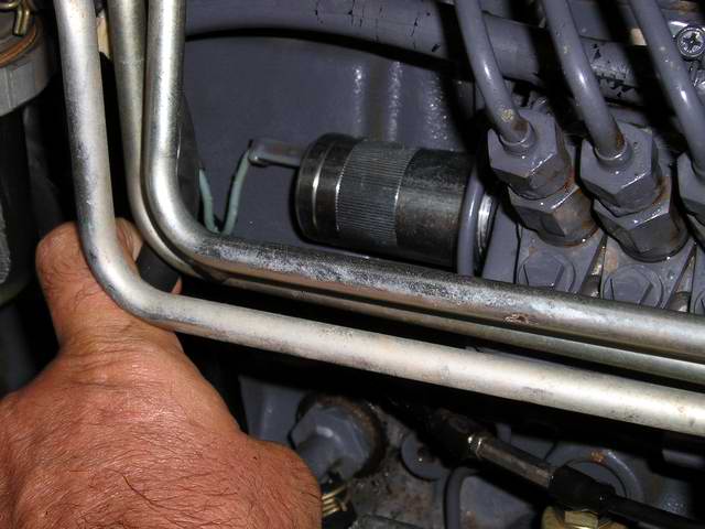

My New Holland won't start. Bled fuel at banjo nut on injector pump, injectors, checked continuity on glow plugs, took off return fuel line. Fuel to low pressure end of injector pump ok. Some fuel to injectors through fuel lines,. Could the cut off switch be stuck? When I tapped on injector pump, it sounded like it wanted to start, but would not. Knowledgeable individual thinks it's not getting fuel, nothing coming out of return nipple???

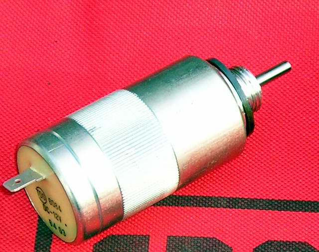

   / 1925wont start #6
On the back side of your injector pump is a round cylinder shaped fuel-cutoff solenoid. It has one spade connector that gets +12vdc when the solenoid is energized. It is grounded through the body where it screws into the injector pump. I would try jumping 12 volts to that solenoid or listen/feel for it to energize when the key is turned on. If that solenoid is not getting power or not working, you will not start the engine.
