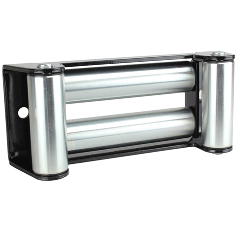

A fairlead is a device that guides the cable onto the drum. Typically rectangular, typically has 4 fixed rollers that define the shape and size. Google once again can be your friend.
Oh right on. It's a guide to help the cable spool up evenly then. I imagine with a drum that wide the fairlead would sweep from end to end with the cable as it's spooling?
The fairlead is generally as wide as the winch drum, and is fixed to the same anchor point as the winch.
