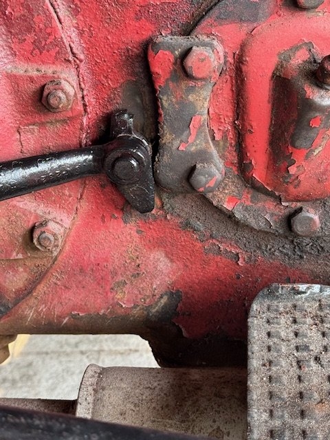

Have another query. Rebuilding the rear axles, no real problem. But when doing the passenger side, the brake actuating camshaft (lever with foot pad to the brakes inside the drum) came out when I pulled everything apart, I didn't see how the brake pawl was positioned. Can anyone advise if it is positioned correctly ? Can't find a picture of how it goes yet...

/ 1948 8N #27
I cannot find any pics in my files but found this from the Ford parts manual.
Scratch last, found a YouTube and determined I had it correct.

#29
I saw that too, but it wasn't very clear. Found a you tube where this guy explained how they worked and I saw I had it correct.

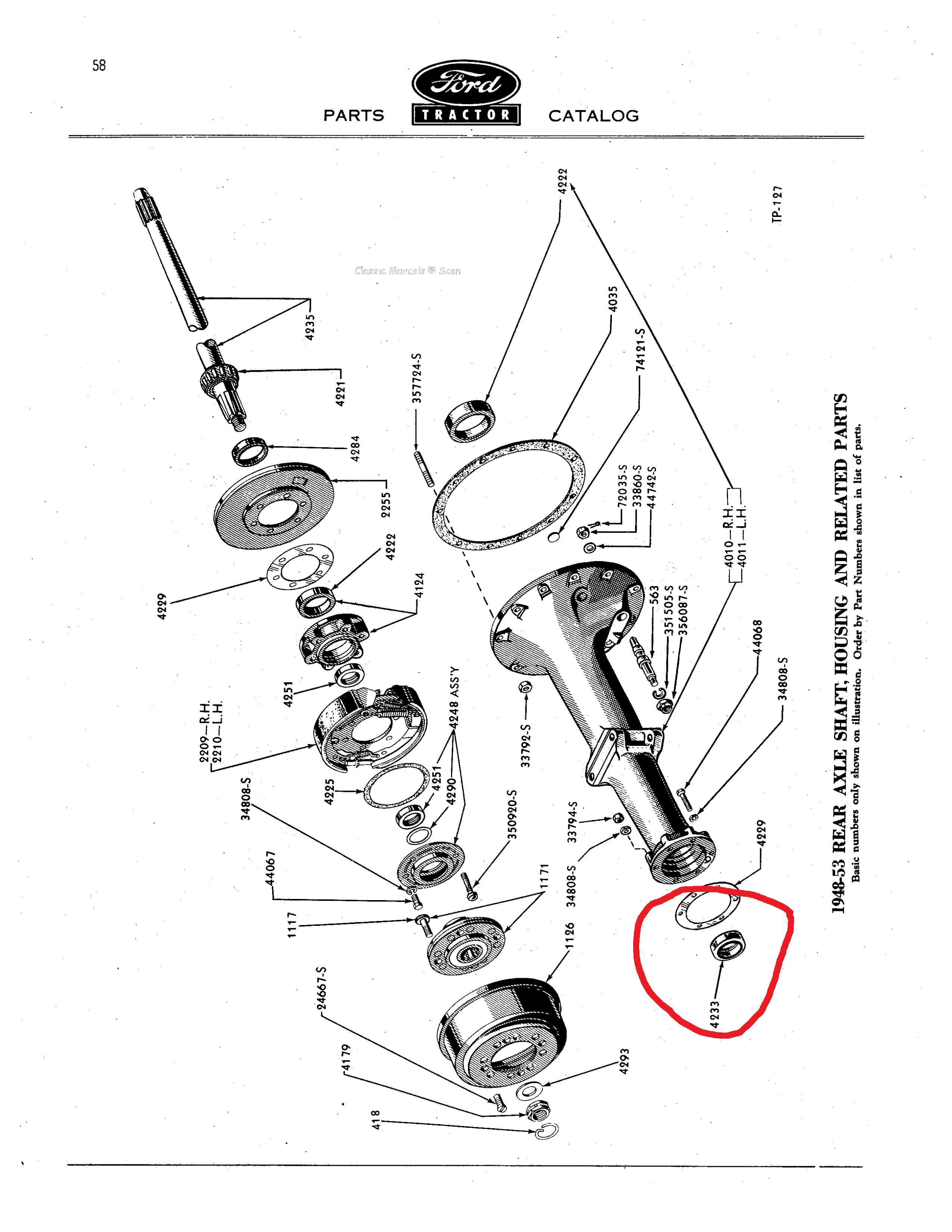

Need to pick a brain again. Doing the rear axles/brakes. All went well until when finishing I saw I had a seal left, 8N-4233-A1, item #13 in parts catalog, page 1-35. Didn't take one off, but can't see any place for it to go. I'm guessing it goes on the axle further inside the housing, but I didn't pull axle out. Also, there is an asterisk next to the part number, and at the bottom of the page it says "No Longer Serviced". Not sure what that means.
Can someone shed a little light here please ? Wife wants the tractor off the carport...
/ 1948 8N #34
The 4233 is the inner seal and it goes in the end of the axle trumpet, to replace it you would need to remove the axle.

#35
Thanks John, that's kinda what I figured. That's why I never saw one cleaning everything up, I never removed the axle.
