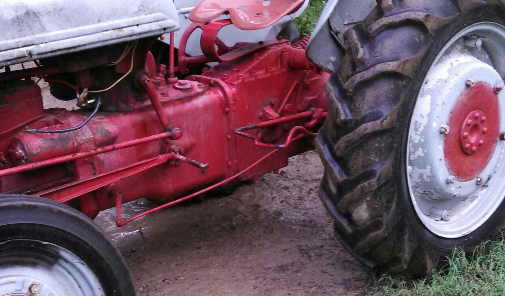

I will take pictures of the tractor and the push button in the morning for your review
   / 1949 Ford 8N (converted to 12 volts) starter issue
#12
Here is a picture

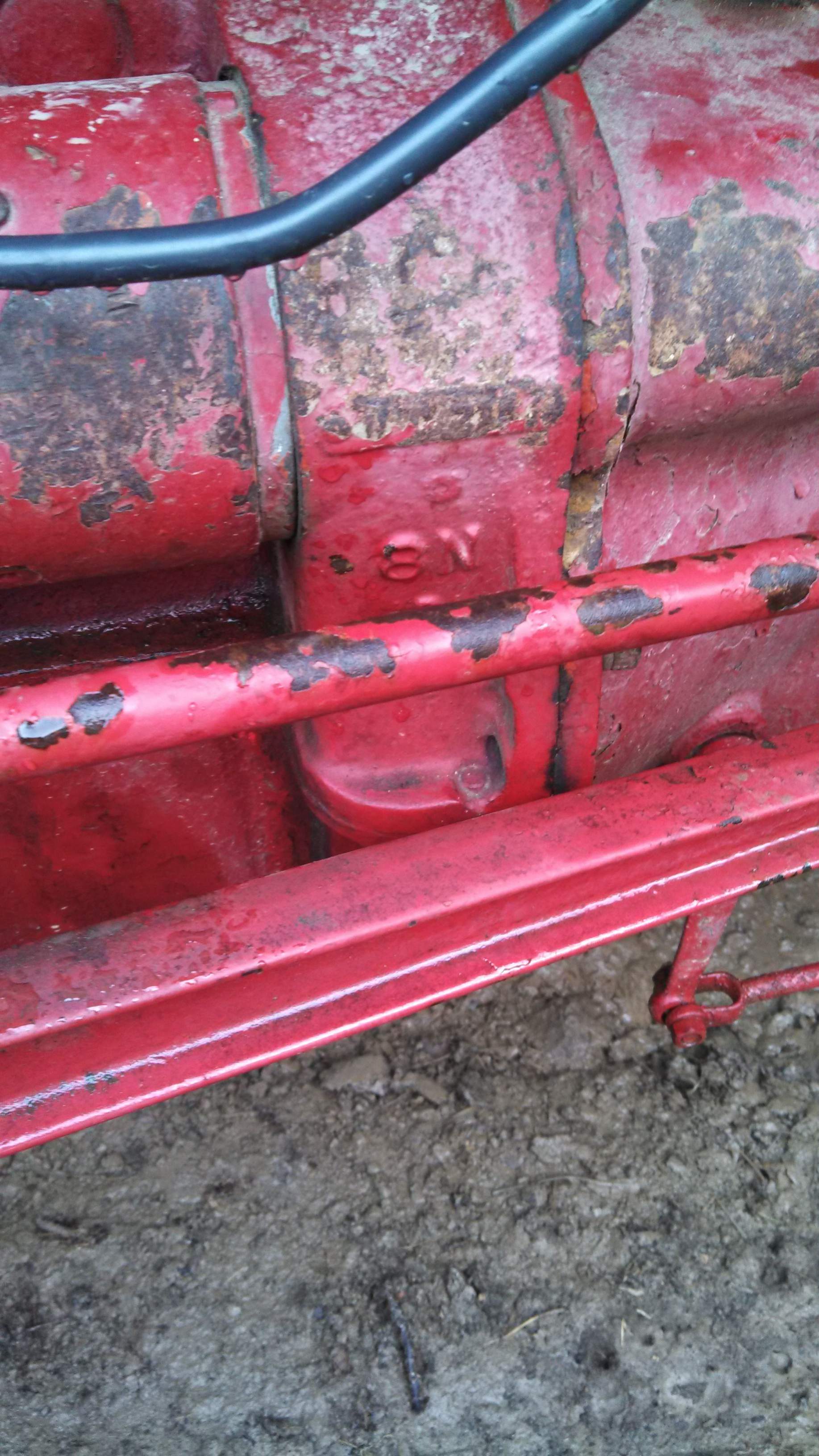

Also, on the block where the starter is mounted and behind the steering linkage are raised letters "8N"
#14
Hope this helps

as suspected. you DO NOT have an 8n. you have a 9n or 2n. and it is somewhere before a mid 44 model.. as it has i beam radius rods. .. Oval came out in 44.
big difference.
no solenoid on a 9n/2n.
and the trans safety interlock switch is a mechanical starter switch. not a grounding switch to a solenoid.
can't help you with your problems without knowing what tractor you had.
