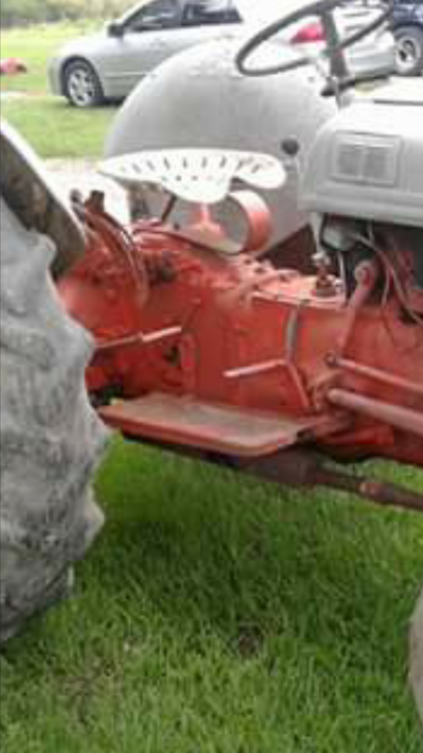

i'd like to see pics of the brake drum / pedal arangement for that frankenstein!

this is the best I have as of now of the brake pedal
I'm out of town i will get more next week

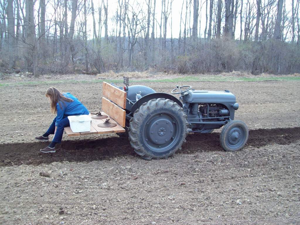

Look to me like they either changed out the trumpets, with or without the center housing. If it's an 8n center housing it will have 4 bolt holes underneath for drawbar and looking at the rear of your toplink there will be ears on each side which may or maynot have a long pin installed. It also looks like you might have a lever on the round cover which could be a howard trans. If so with the howard in low range and the sherman in low range you can walk on you hands and still be faster than the tractor. Here's a shot of my wife planting potatoes. Tractor is running/driving when I step of to take a couple of photos.

I see they 'golberg'd the brake pedals. :)
