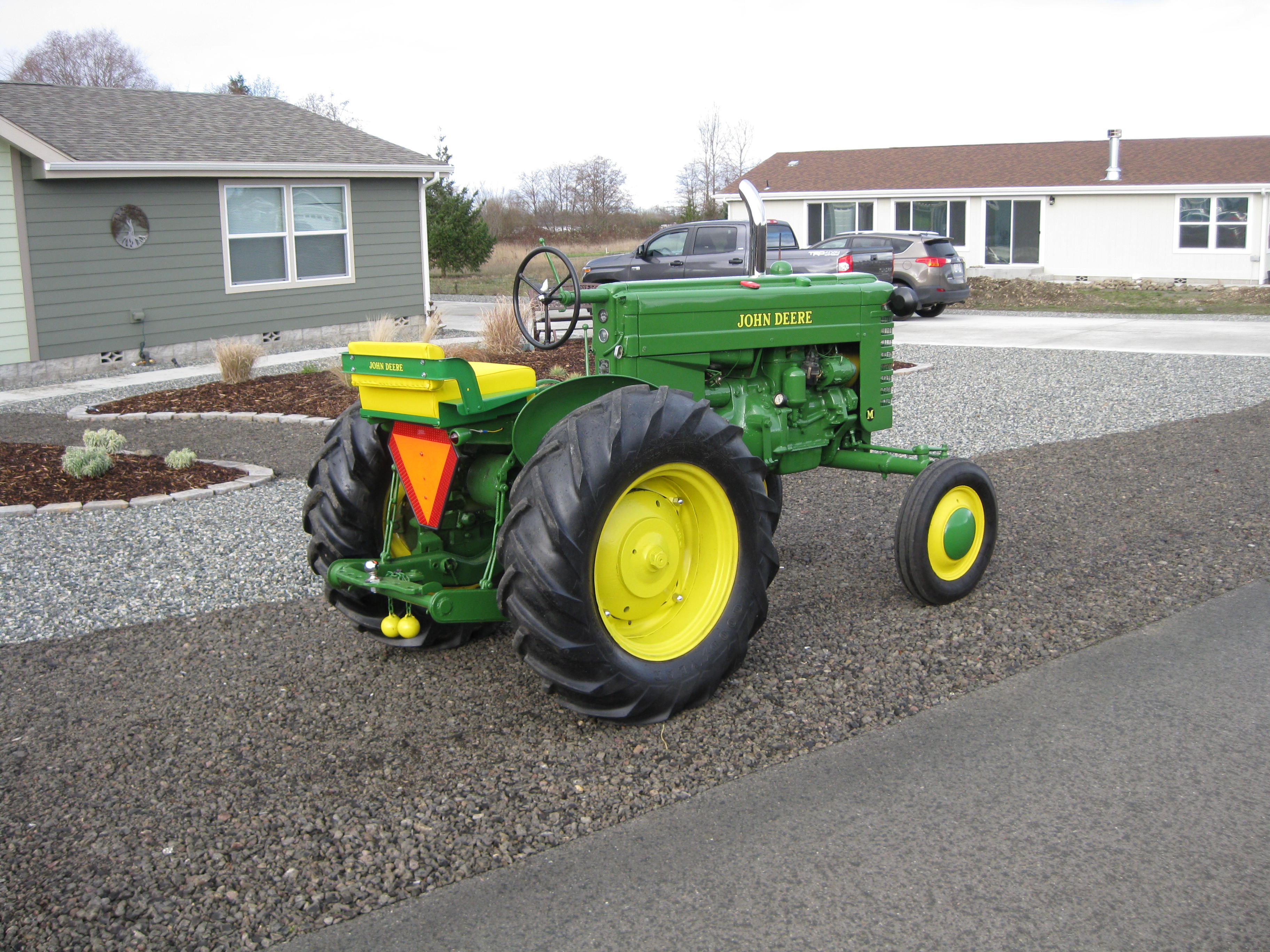

#16
here it is my parade queen:)

   / 1950 john deere m oil problem #18
Looks like a straight exhaust...
Very distinctive sound and my nephew won't hear of any talk to muffle it... it is loud and can be heard acres away...
Always a crowd pleaser.
   / 1950 john deere m oil problem #19
My "40" has a muffler but it still is a distinctive sound. My neighbour says he likes to hear it when I have it up in the field. I think some call the machines from that era Johnny Poppers because of the sound they make.
