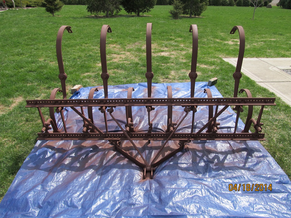

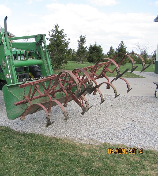

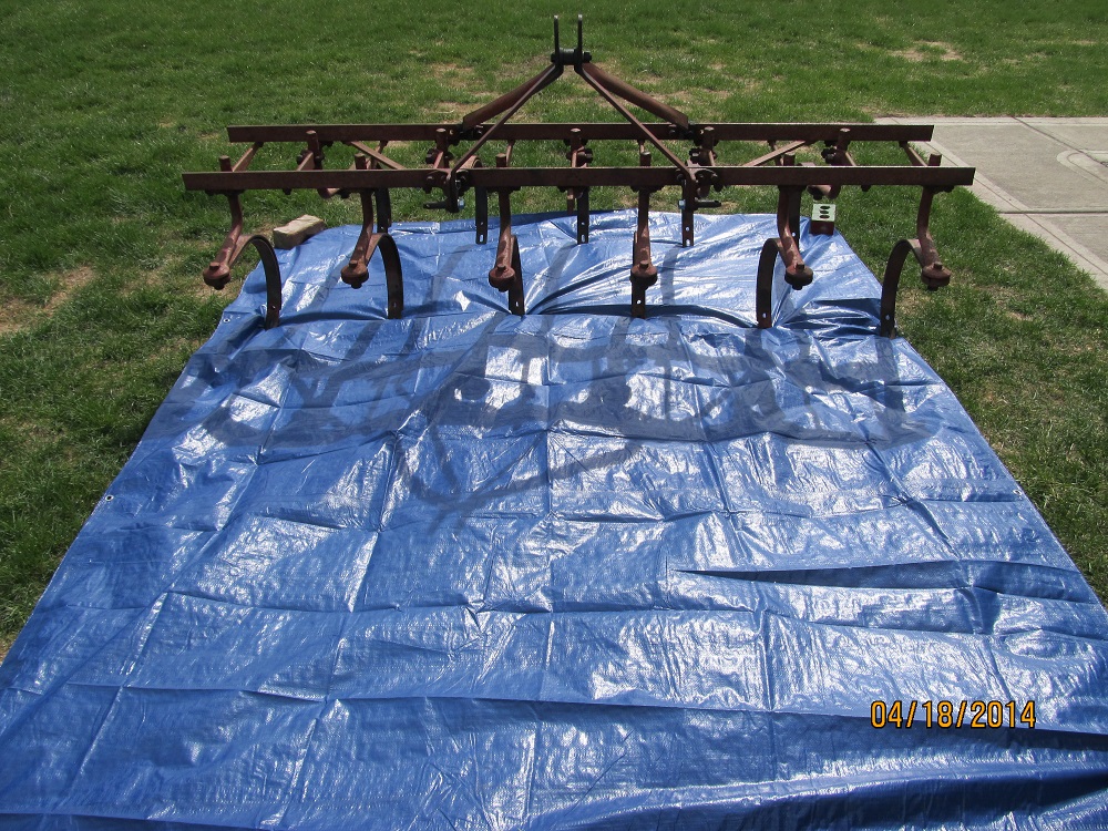

Found this 8 ft wide Dearborn cultivator at a local auction about 10 miles away. They forgot it and it was almost the last to sell so I got a good deal. These are great cultivators for the small tractor. There was no loader tractor so I just decided to drive over with my JD5520 and bring it back in the loader. 20 miles in an open station tractor on a windy and cool day is no fun.
20 miles like this on the back roads. Never passed a car.

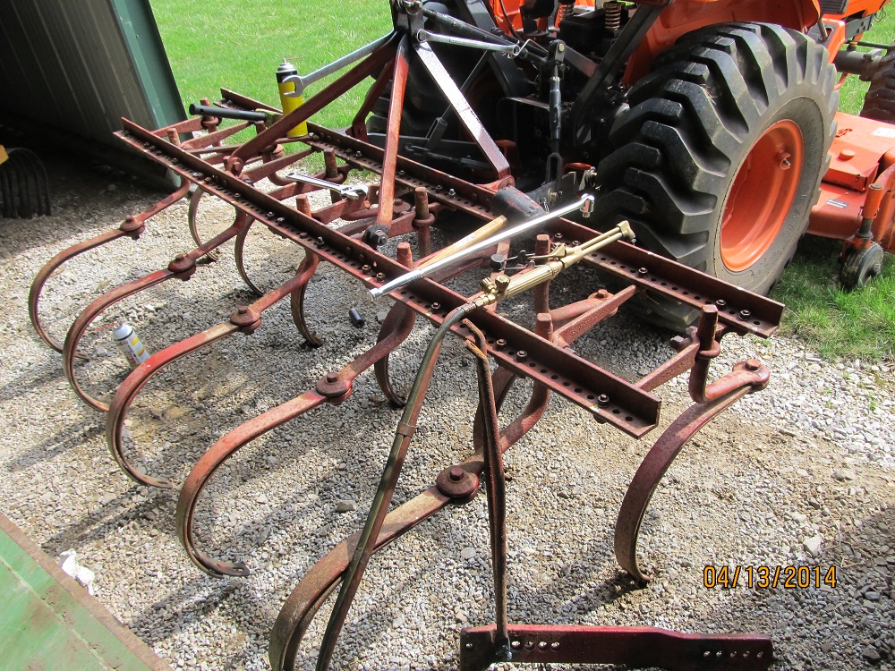

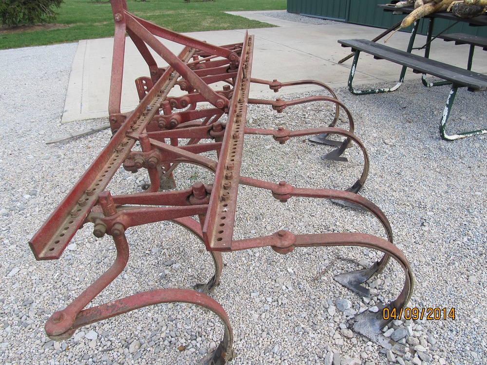

The prior owner did some dumb stuff to it and shovels were not correct and were blocked up or bent to change operating angle. That's a no-no.
I corrected the spacing for starters but some things were stuck and needed heat. All the washers got replaced and everything got loosened with oil and threads cleaned up.

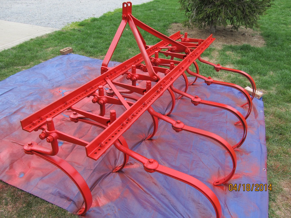

Got a can of genuine Dearborn Ford Red acrylic enamel from my New Holland dealer. This is the correct--and only--brand and color for this cultivator and it looks like a million bucks. Lookee here.
EDIT--Note this is 1950's Ford Red and not more modern New Holland Red.

Final picture with new and correct angle shovels. I'm going to use this setup to keep weeds down but I could also use narrow shovels as well. These are very useful, made of quality steel and fit the compact tractors most of us have. I wouldn't be afraid to use it on a 50 HP tractor either.
I used to use one of these to pull big rocks (25-75 lbs, etc) out of the ground in gravel New England soil and never even broke a tine despite great abuse.
