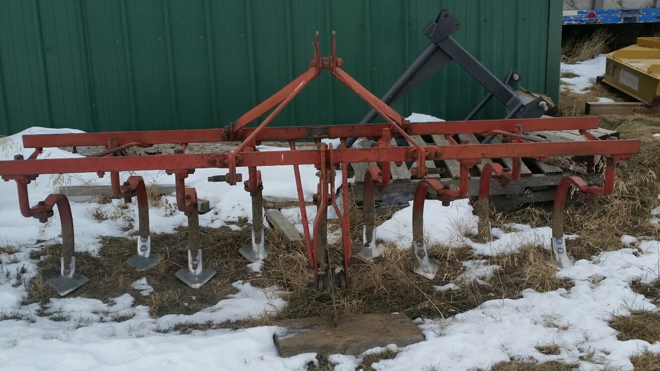

I took a couple of pictures of mine this morning. This motivates me to get it painted up. It actually still has quite a bit of red on it, just faded.
That's in excellent condition and would paint up well. Get everything where you want it and then spray away with real NH paint. It's the 1950's Ford red and not New Holland Red. If need be, you can touch up with a spray can. In fact, the factory paint is so good you could paint the whole thing with spray cans and it would come out almost excellent.
