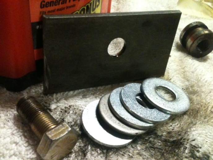

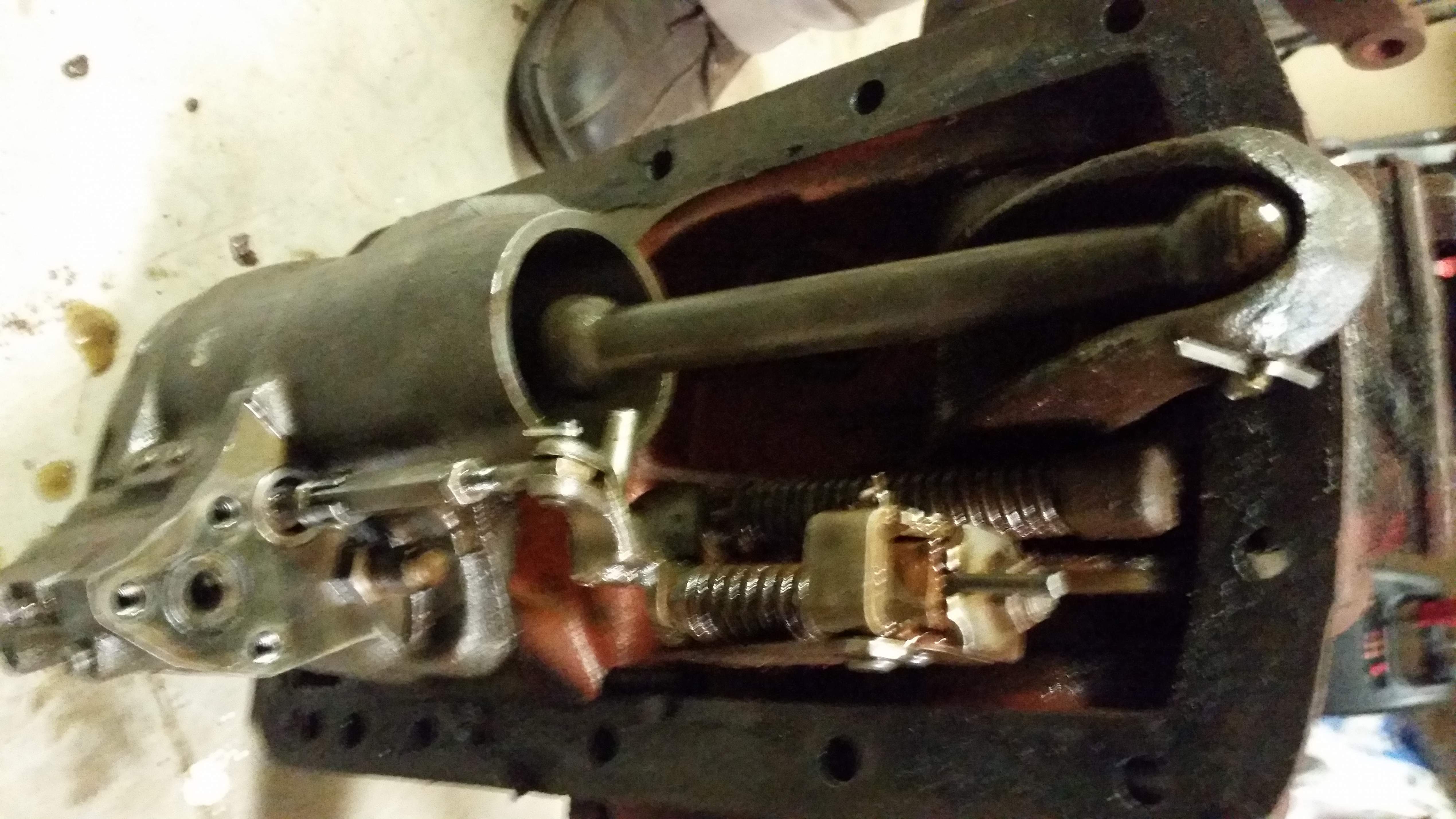

Ok so both my manuals came in today and this is how far I have gotten. I am not sure how or where to insert the bolt with washers that I have been reading about. See attached pictures and please give guidance. The piston in the large cylinder appears to be stuck.

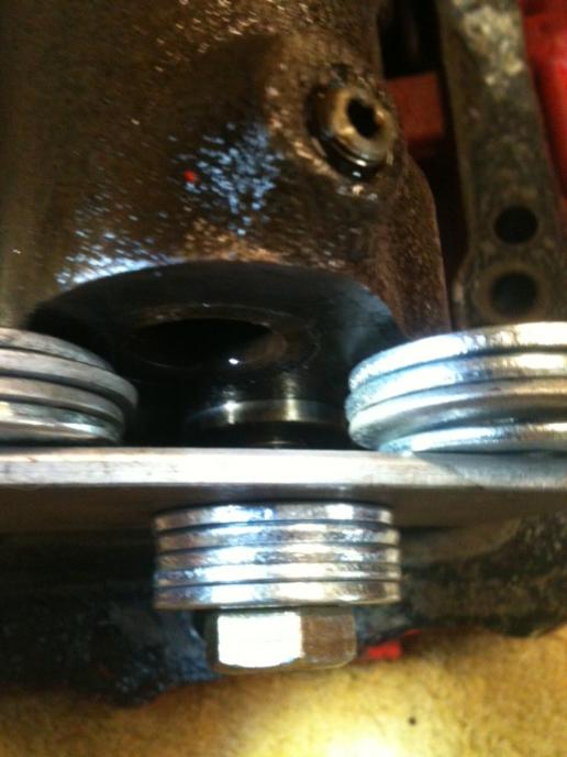

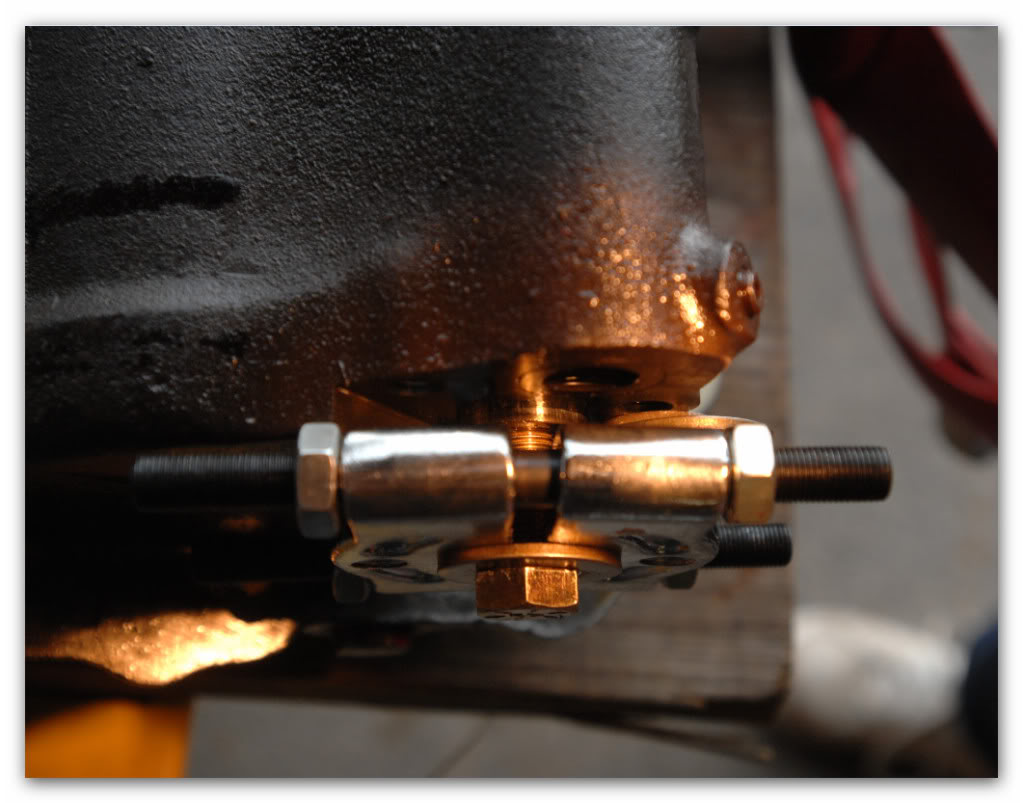

here
As shown, metal plate and washers.. or a bearing splitter.
