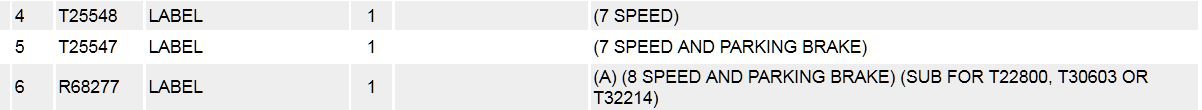

The sliding gear shifter rails have a stops(parts key #24) that the collar shift doesn't have. Plus the shift rail tabs that shift handles sit in are different for each type trans.

UPDATE: Dealer just verified that it is indeed a 7 speed sliding gear transmission. He was going to order the correct label (part no. t25547) but it is not available anywhere. I guess my next step is to have a label made. Thank you for the wealth of knowledge you folks here offer!
Tractor Data: TractorData.com John Deere 820 tractor transmission information
I may have the sliding gear label you need. Having bought the label kits in the past the 7 speed label wasn't used, if I find it you can have it.
