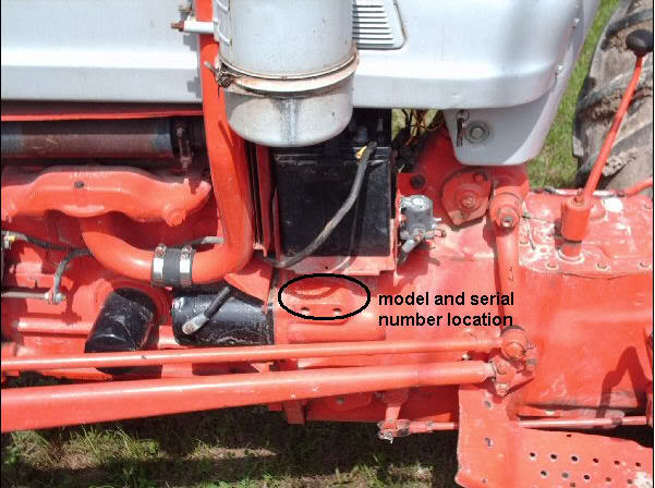

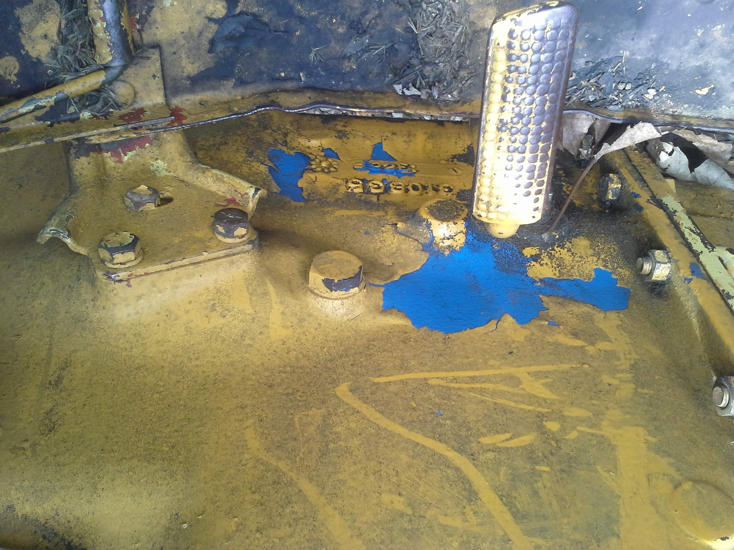

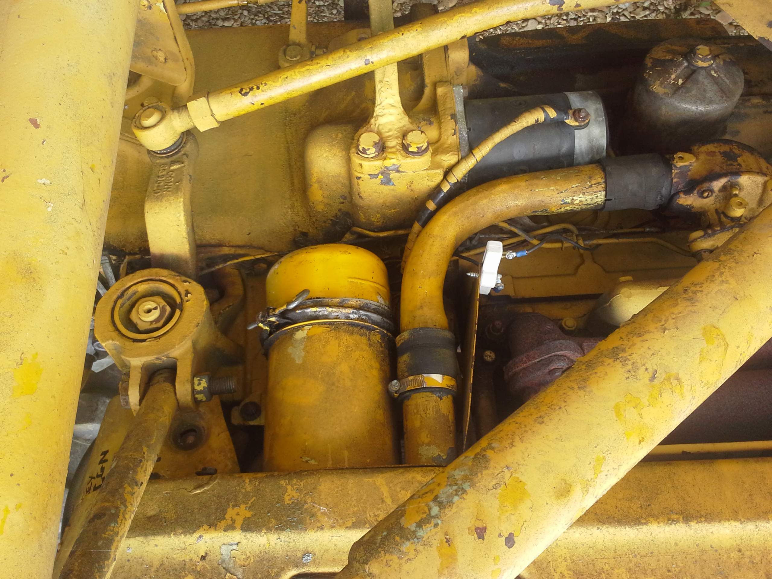

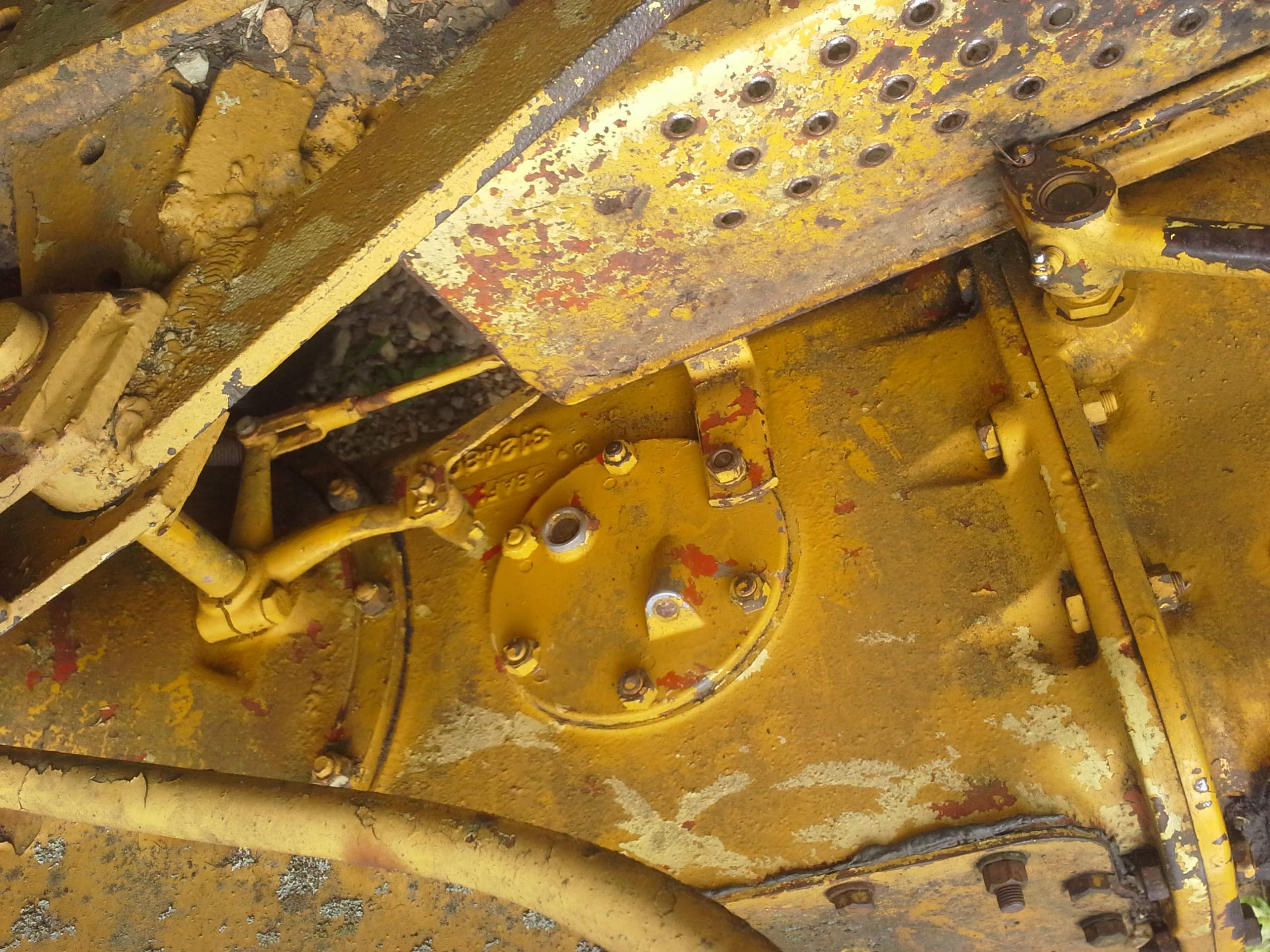

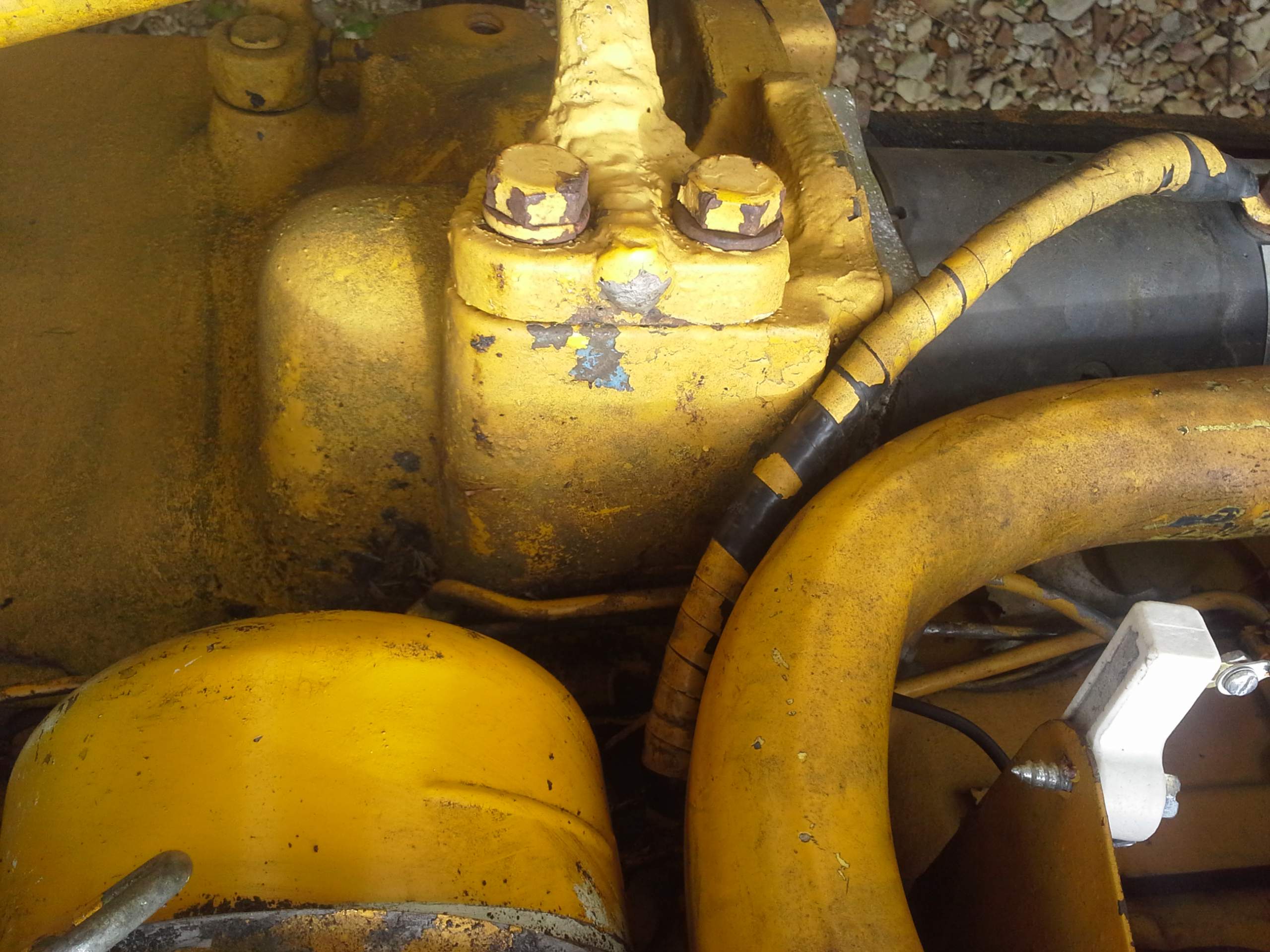

The bracket in the 3rd photo indicates a heavy industrial whit a frame. Early models would be the 1841, with cable steering system, later would be the 4000. I suspect it's the later 4000 model with the better steering. Serial and model numbers will be above the bracket. Here is a photo of one off my 4000 with the hoe dropped off.
Kirk

Thank you, Soundguy. I don't get on line very often so I just now saw your remark. I guess that I will just have to get some paint remover and clean up that area. I will do that and then come back with more questions.
Ron

we are here, so ask away. Kirk has more experience with the industrials, but we are both good with the 55-64 machiens in general.

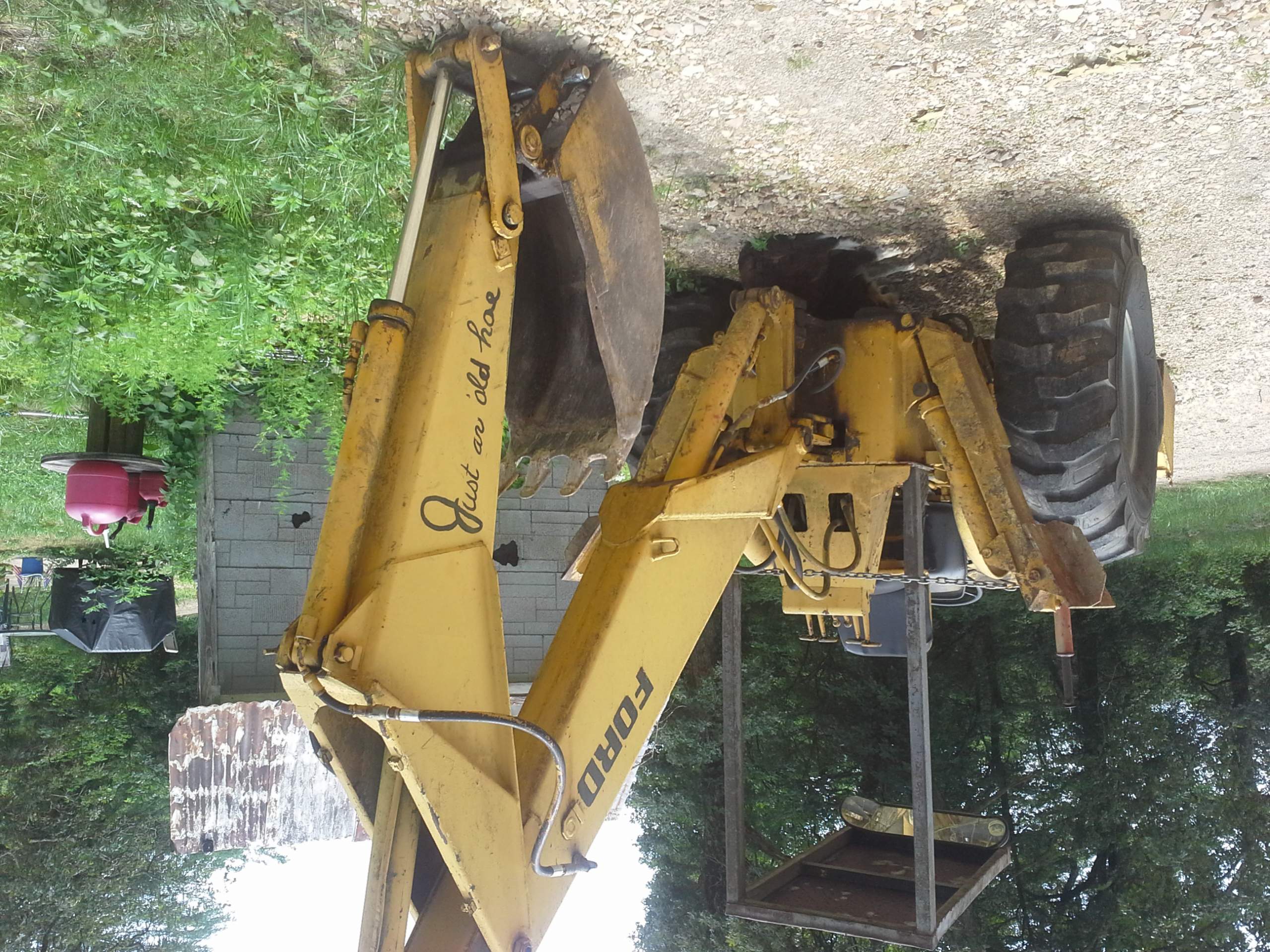

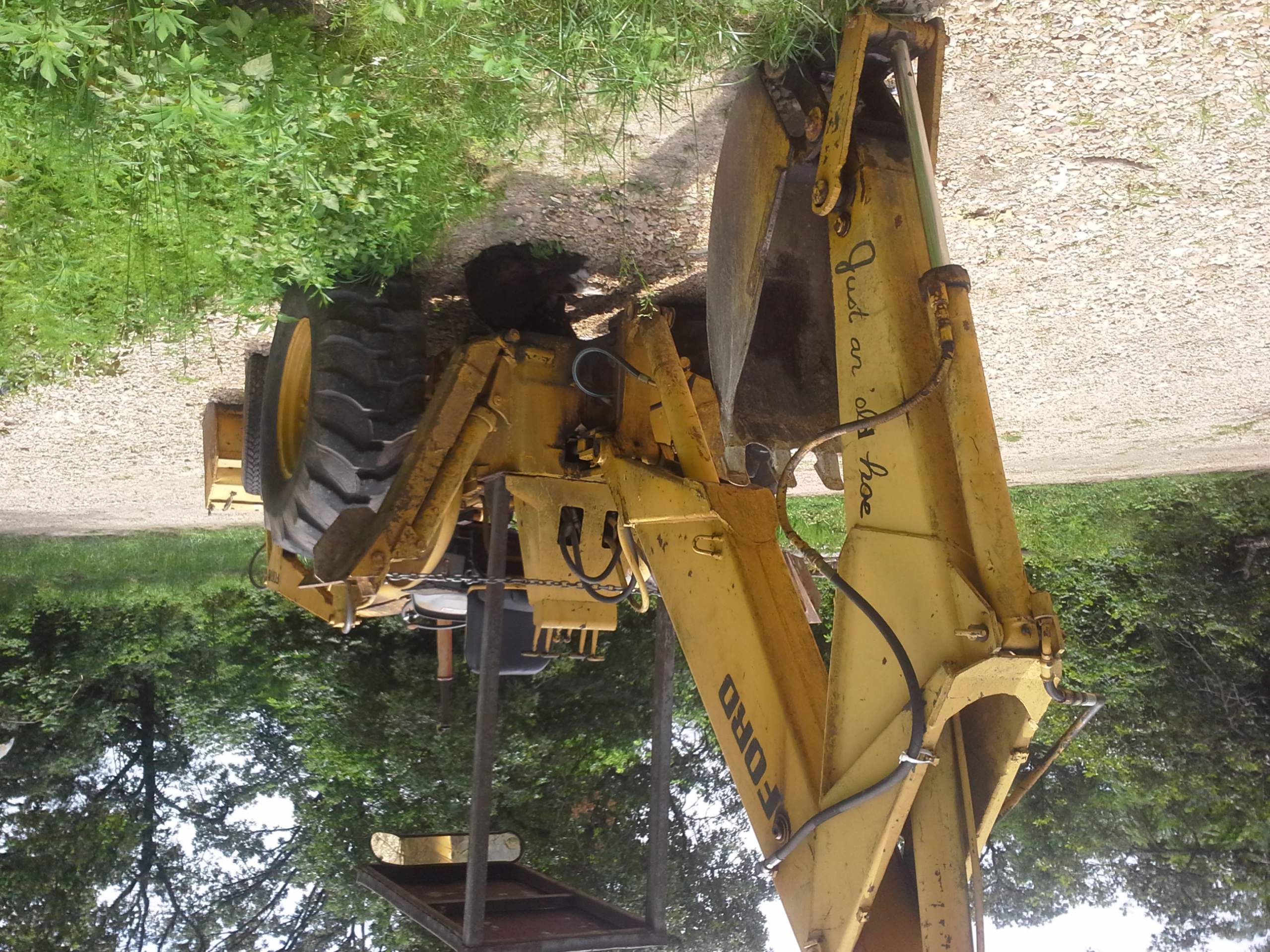

That hoe looks like a Warner Swazey probably not spelled right but they built backhoes for ford in the early 60's. From the pics it looks like it has not been abused like a lot of them were
