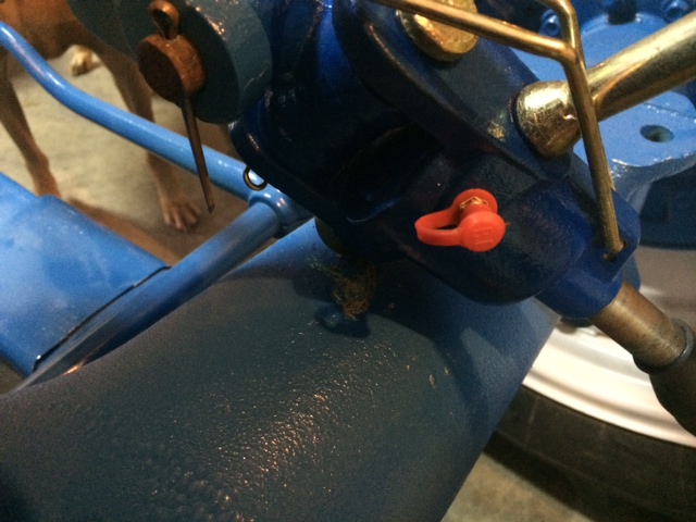

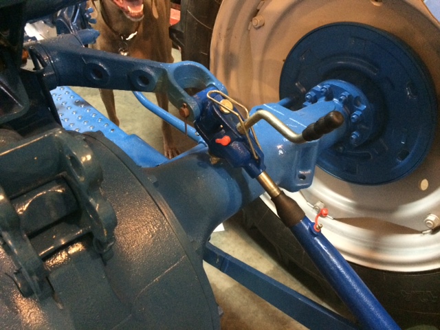

Working on restoring my grandpa's Ford 2000 (4 cyl). I've got three questions. All three are very simple but nonetheless problems.
1. I am having problems with my box adjustment arm rubbing against the rear axle. The way I figure it I either have the wrong part or the hydraulic arm is too low. Is there another possibility? I am attempting to attach pictures.
2. I have converted the tractor to 12 volts. Do I need a voltage reducer at my distributor?
3. I purchased a temperature gauge, however, the tractor did not have one prior to restoration. Does the temp gauge go in the drain plug on the block?
Yes, I'm very green! Thanks for the help.

i would say it's nearly identical to a 601 series, not a 600. 600 had an amp gauge.. 601 had a charge indicator lamp like that 2000 should.
If it was me, i'd ditcht he resistor and just get the correct coil.. but you've already bought the resistor.. so a moot point. The correct coil is a napa IC14SB ( 16$ or so ) coil that runs natively on 12v with no series resistance.
that machine most certaintly left the factory with a temp probe. look on the right side , just a bit below the valve cover., back towards the battery.
as for the arms resting on the axles... yup.. real common...
