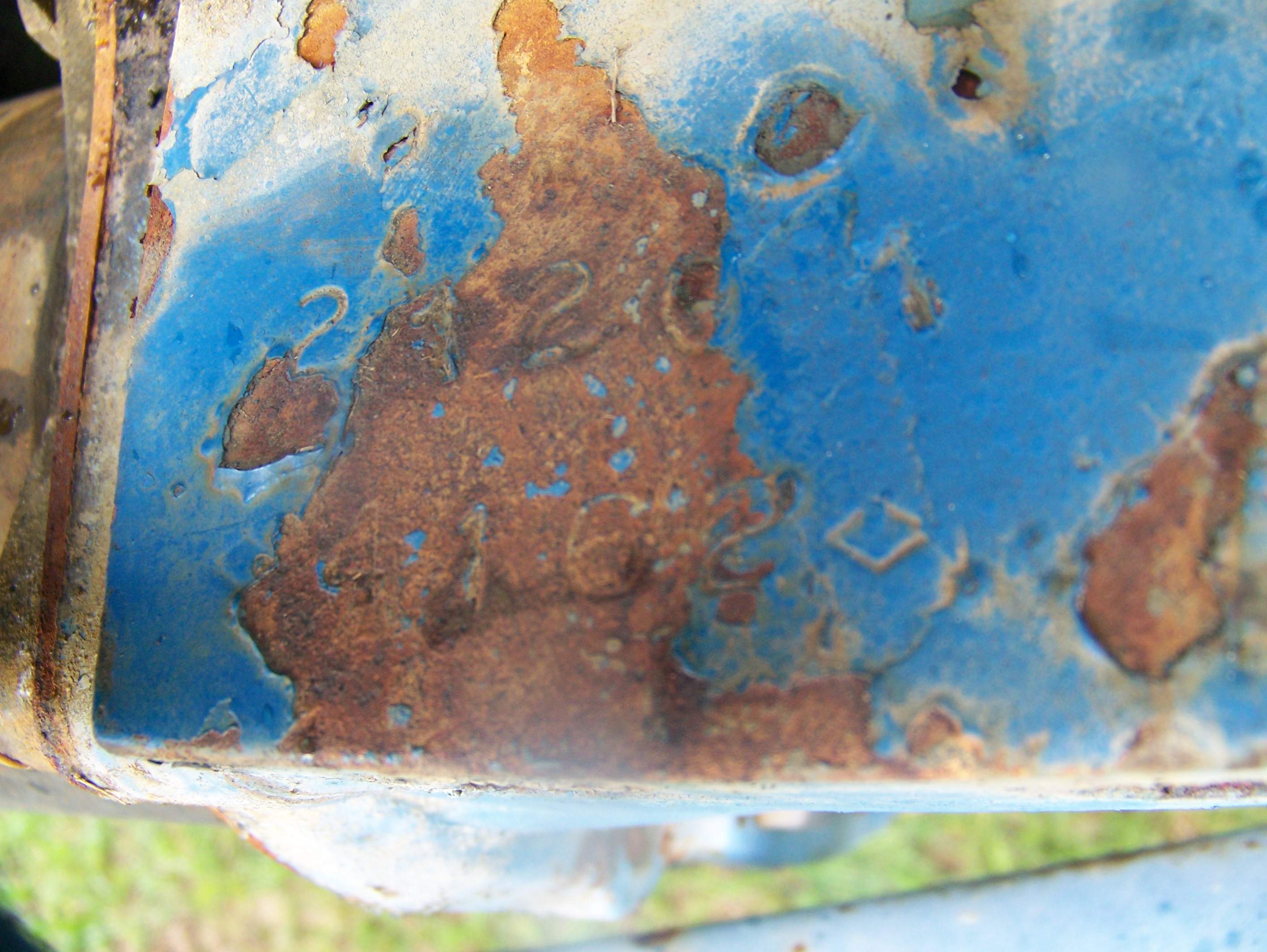

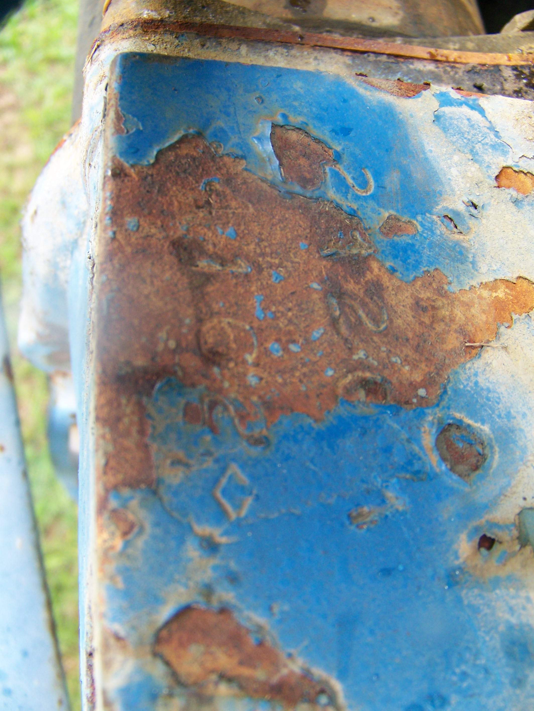

Thank you Soundguy.
Yes...I checked and rechecked several times.
Here's a shot of it.
The model number on top has the last digit (1) sort of mis-spaced way out to the right.
There doesn't seem to be any room left for an additional digit between the diamond symbols in the serial number on the bottom.
The numbers are clearly legible in person. The photo is a little more difficult to read.

hard to say.. I'd use a 3m wheel and buff that piant off. I've seen numbers hid well before.
and again.. it won't be the first model year aberation i've ever seen either.. 62 was the end of the 01 series, and beginning of the 000 series for the model year 63.. that said.. the first ones were surely built in the end of 62. i'll look at my charts closer when i get off work

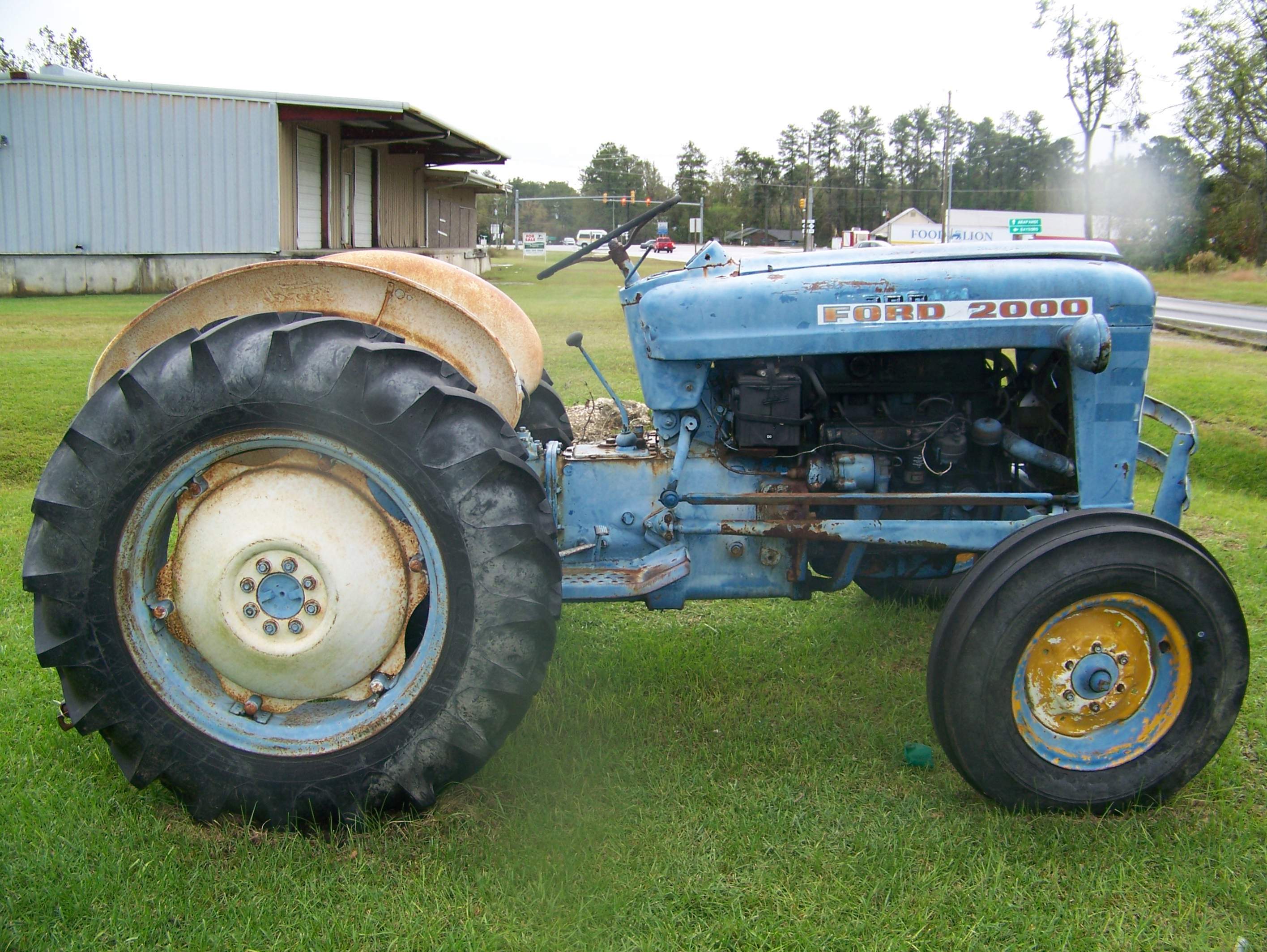

   / 1962 Ford 2000 Produced in 1963?
Thank you.

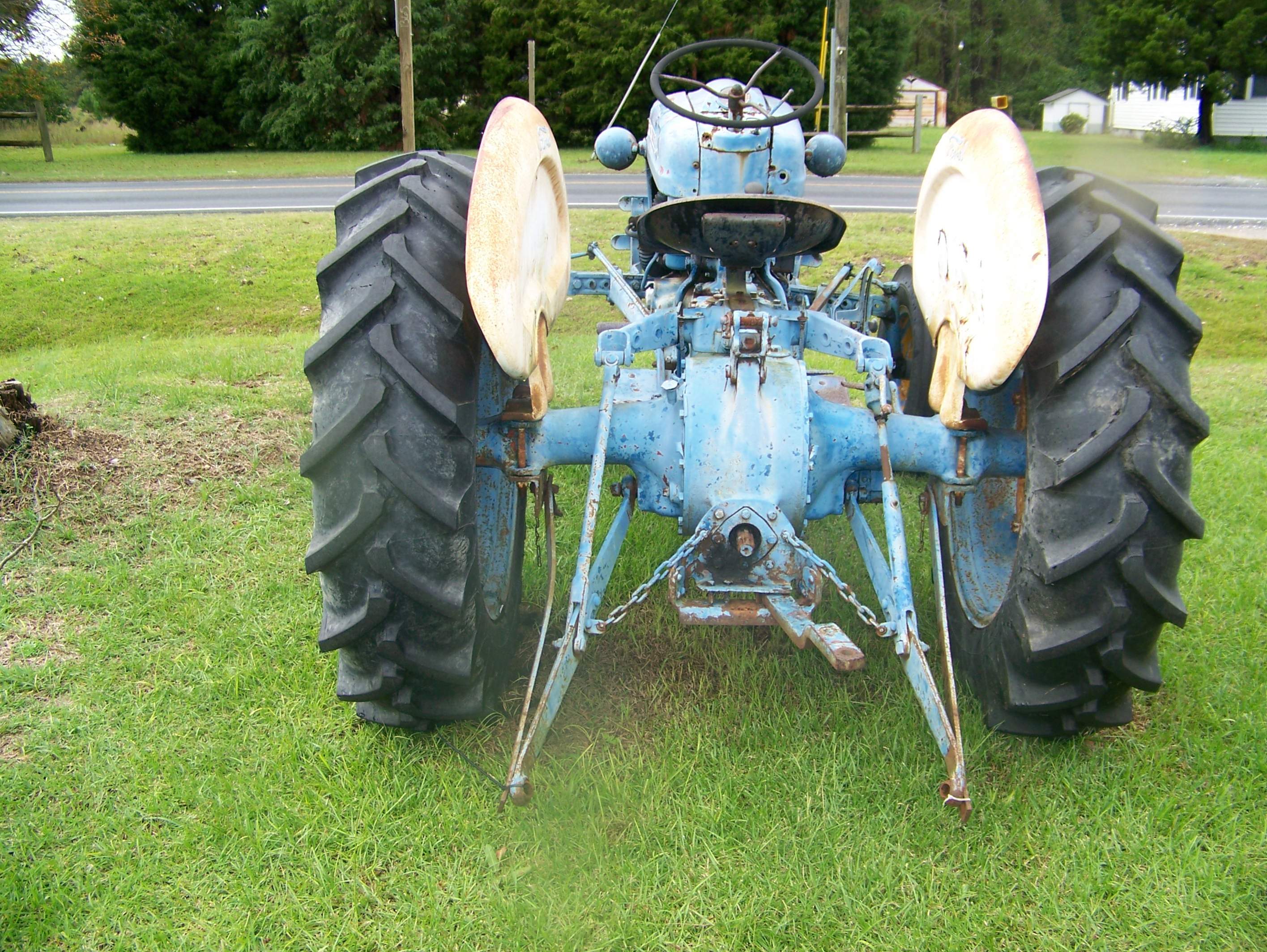

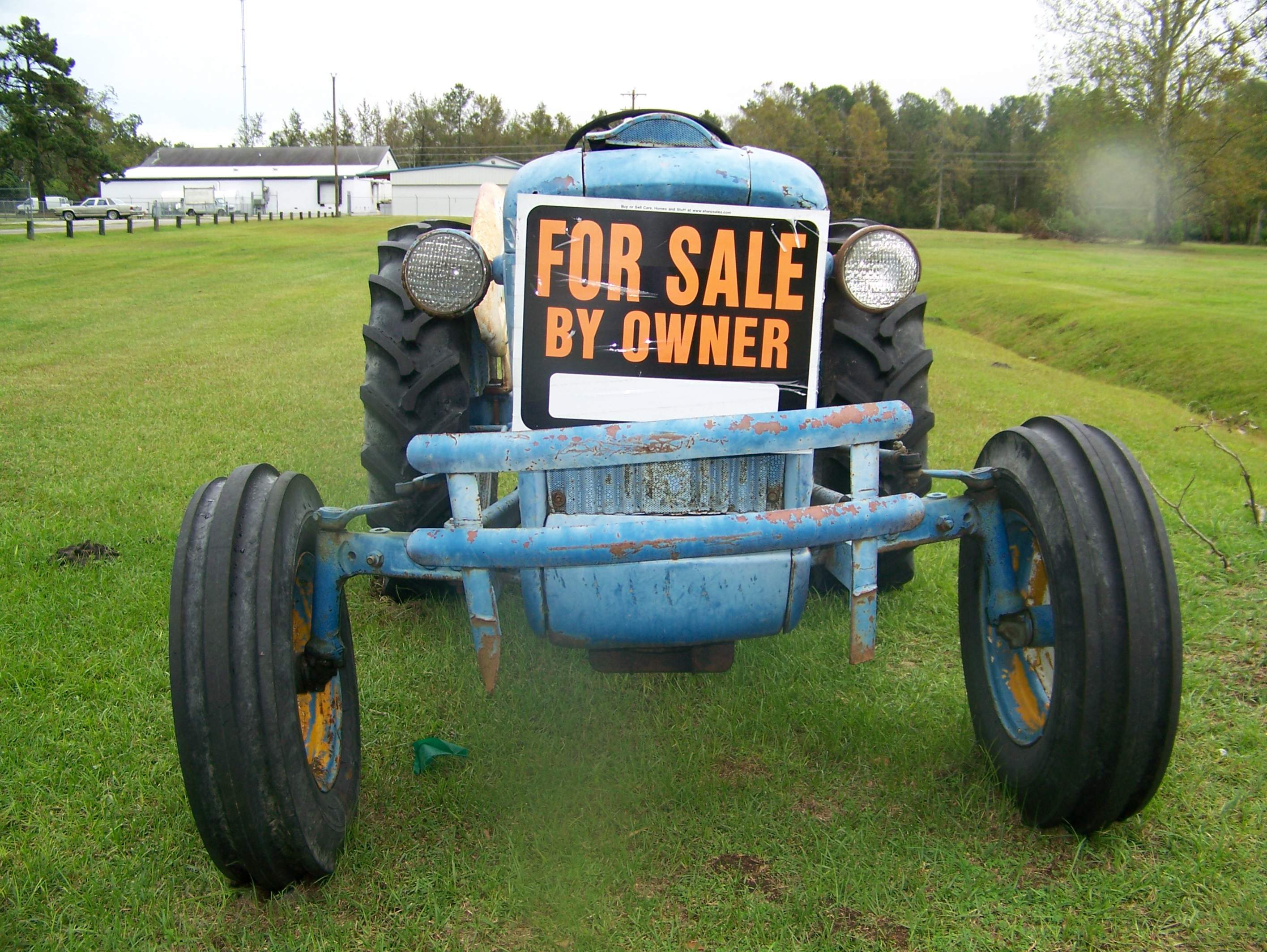

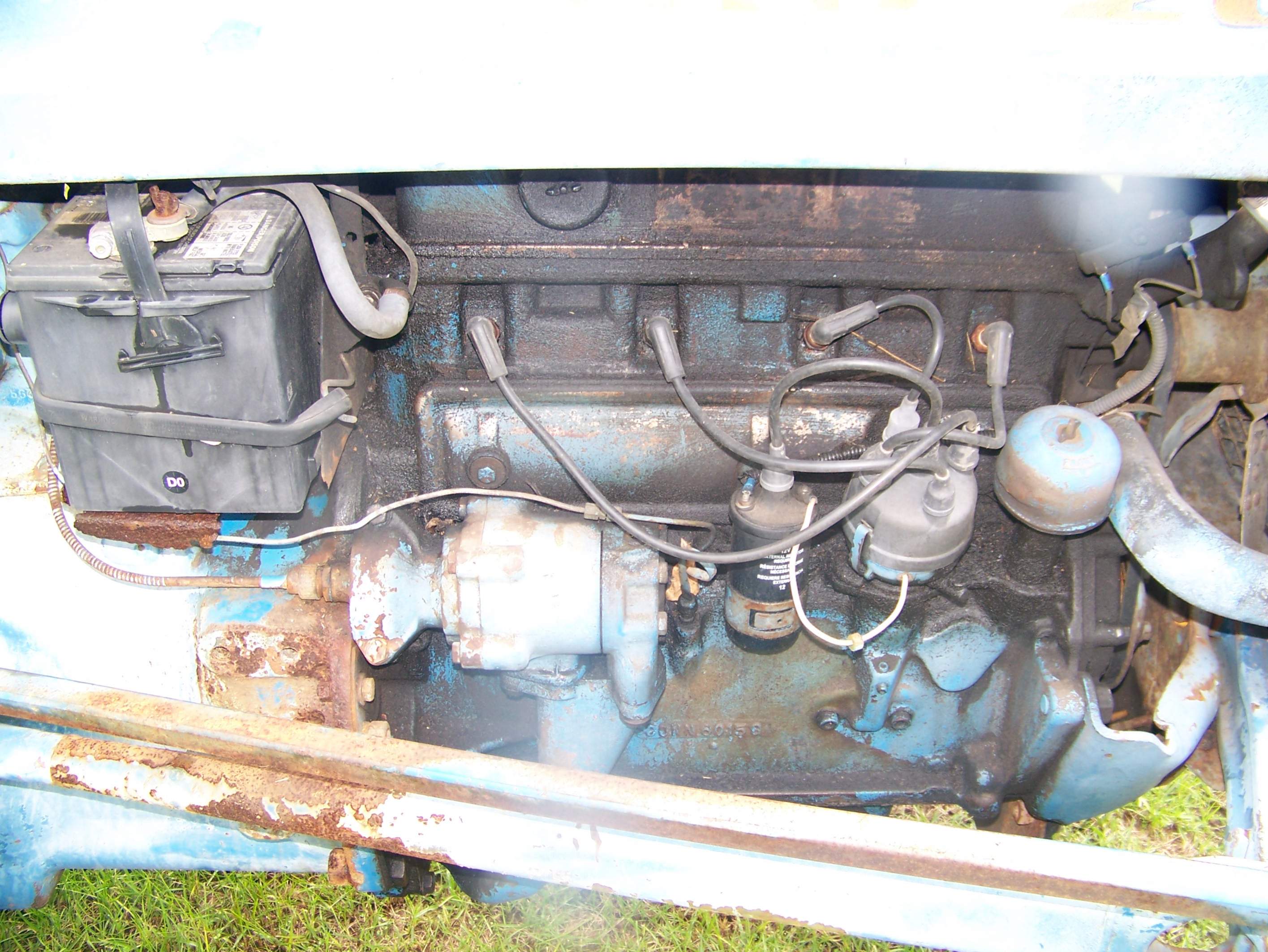

I was thinking of buying this tractor to use for brush hogging and scraping driveways a few times a year.

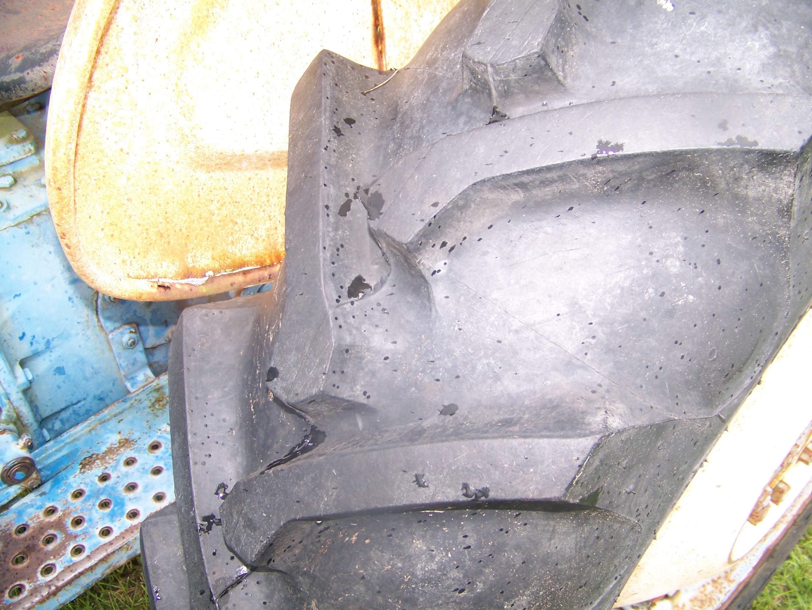

The owner won't take any less than $2,200.00. He said he just spent almost $600.00 on all new tires. He said he's owned it twenty years and only used it to box blade his driveway a few times a year.

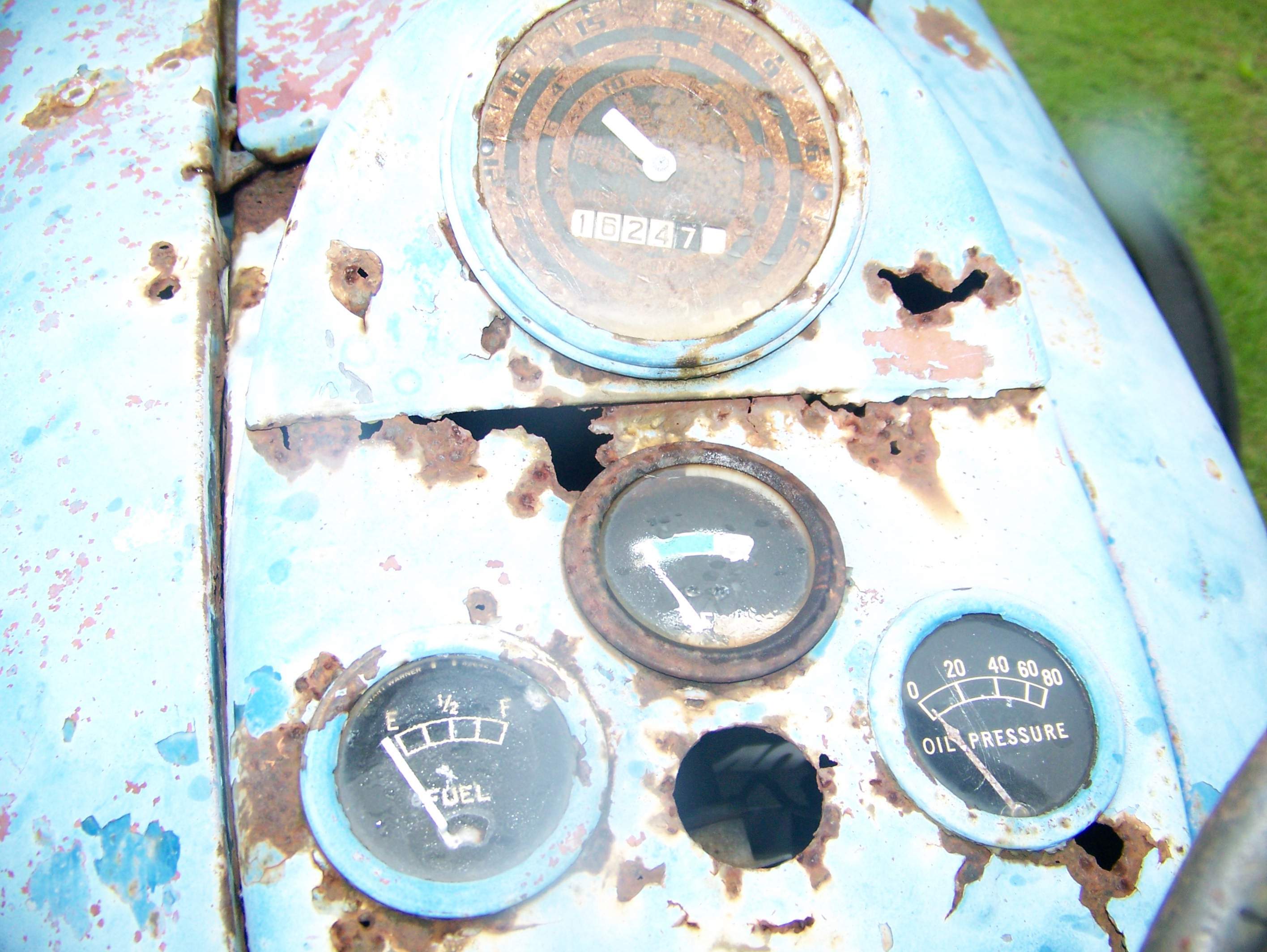

It runs well. I drove it around the yard in each gear for a minute or so. The lift and PTO each work. It was a workout steering it. The proofmeter doesn't work so who knows how many hours are on it...shows 1,6XX.
There are no implements or extra parts included.
I've never owned a tractor so this would be my first. That amount would be about my limit to spend and I'm not into financing one.
Is this too much money for this tractor? Should I look for something else?
Here's some photo's.

The published serial number ranges by year are approximate. Serial numbers were assigned when the order was entered into the system, not when the unit was actually built. The build was scheduled when all the neccessary components were available. A significant amount of time could elapse between the two events.

price rang is about right.

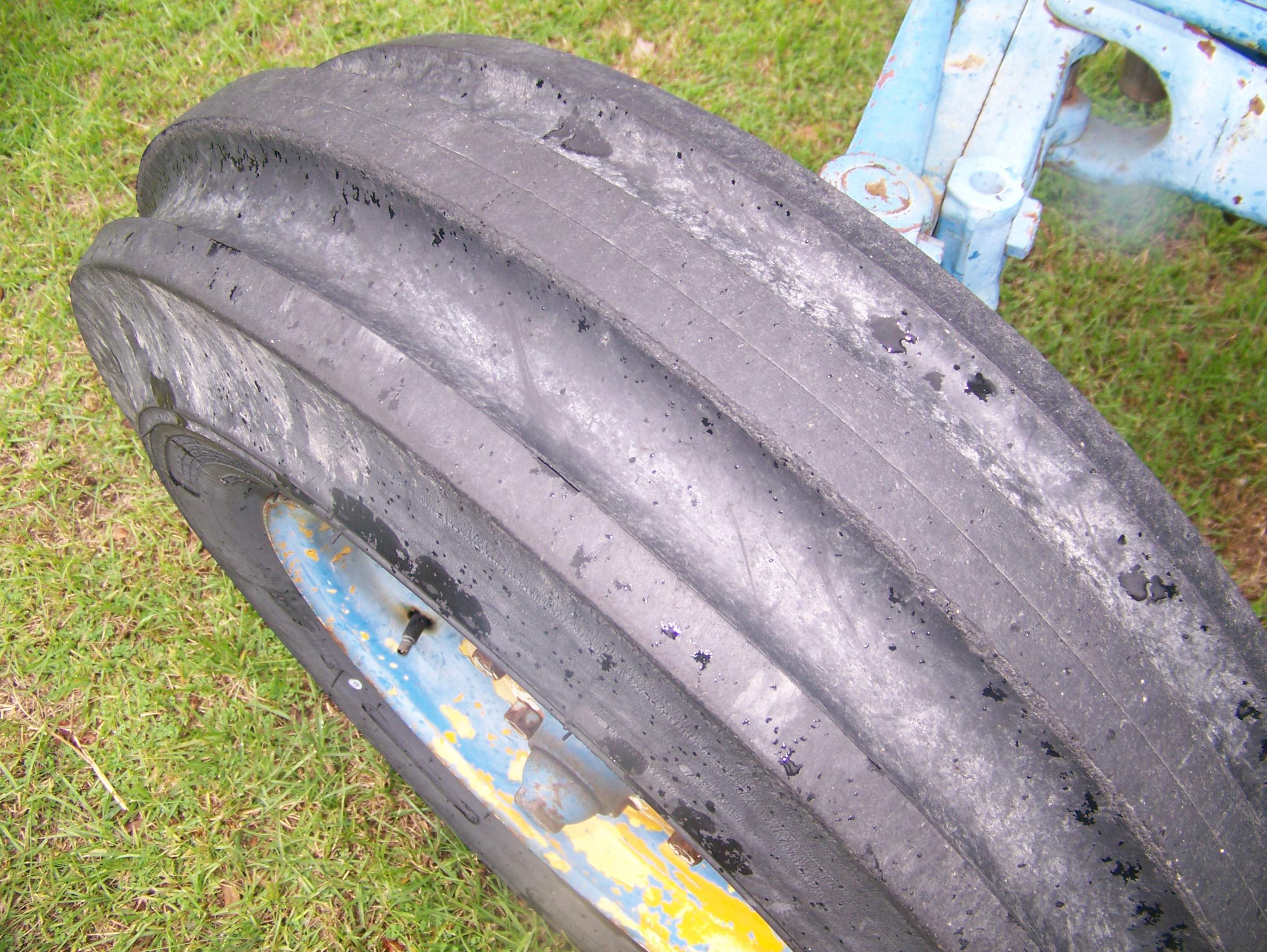

tires do look good. i see one draglink has angle iron brace on it..no biggie.
tight steering may mean no lube int he box. if the steering wheel rises and falls as you turn side to side, it likely needs 50$ of bearings, and 16$ of lube int he box. manual for steering boxes are pretty esy to rebuild. i've probably done every manual box on my old fords. most recent one early this years.. and.. it was a 63 2000 :)

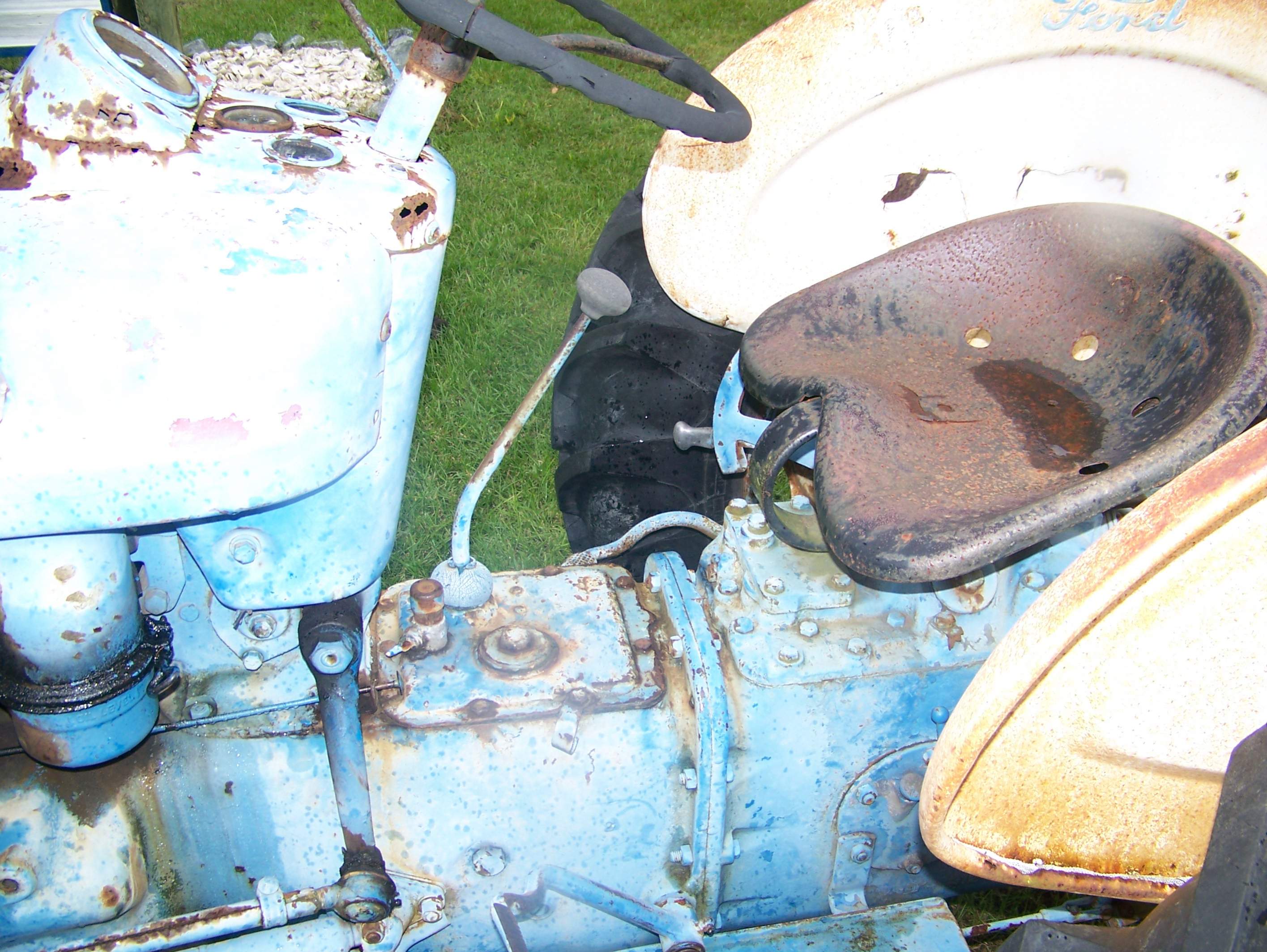

it's a basic 4 speed. i see it has some expanded metal grill protection.. so check water pump and fan.. proof meter might be a cable, the meter itself or the drive int he pump head. pull the cable from the pump head.. if the pump head has a lil turning bit when running.. then figure on a a cable or meter or both ( 65$ ).. no biggie )
dash is shot, ut then.. I expect some rust on an old machine. if you needed new dash metal.. you can find it.. probably 25-50$ max.. most of us collectors have odds n bits of tins laying around. someone is boud to have one if you intende don restoringit.. otherwise.. for just mowing.. it will run :)
I assume front end is showing kilter due to being parked on a grade.
about the only thing I'd do once purchased is do a fluid change on her ( engine, oil filter, air filter sump, trans fluid, hyd fluid and diffy oil, and then rebuild that steering and go..
I bought one that.. well.. looked just like that a few months ago. had to rebuild the steering box too.. dash had less rust... but I paid a hundred more.. so.. sounds about right.. :)
make sure she has no water in the oil or oil in the water.. if she starts and runs good, have fun.

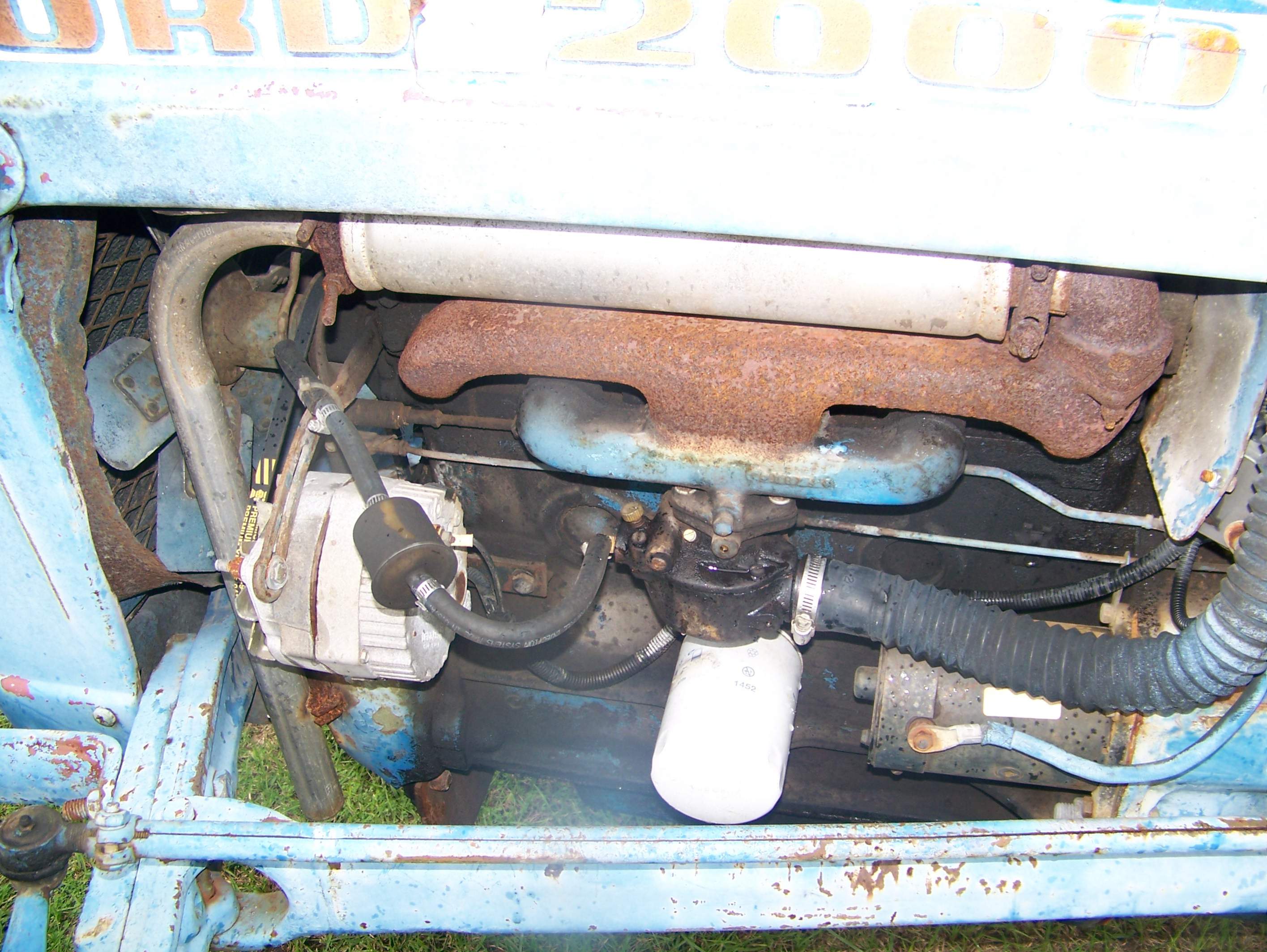

It has a 12 volt conversion which is a good thing. I am not a fan of that exhaust exiting like it does.

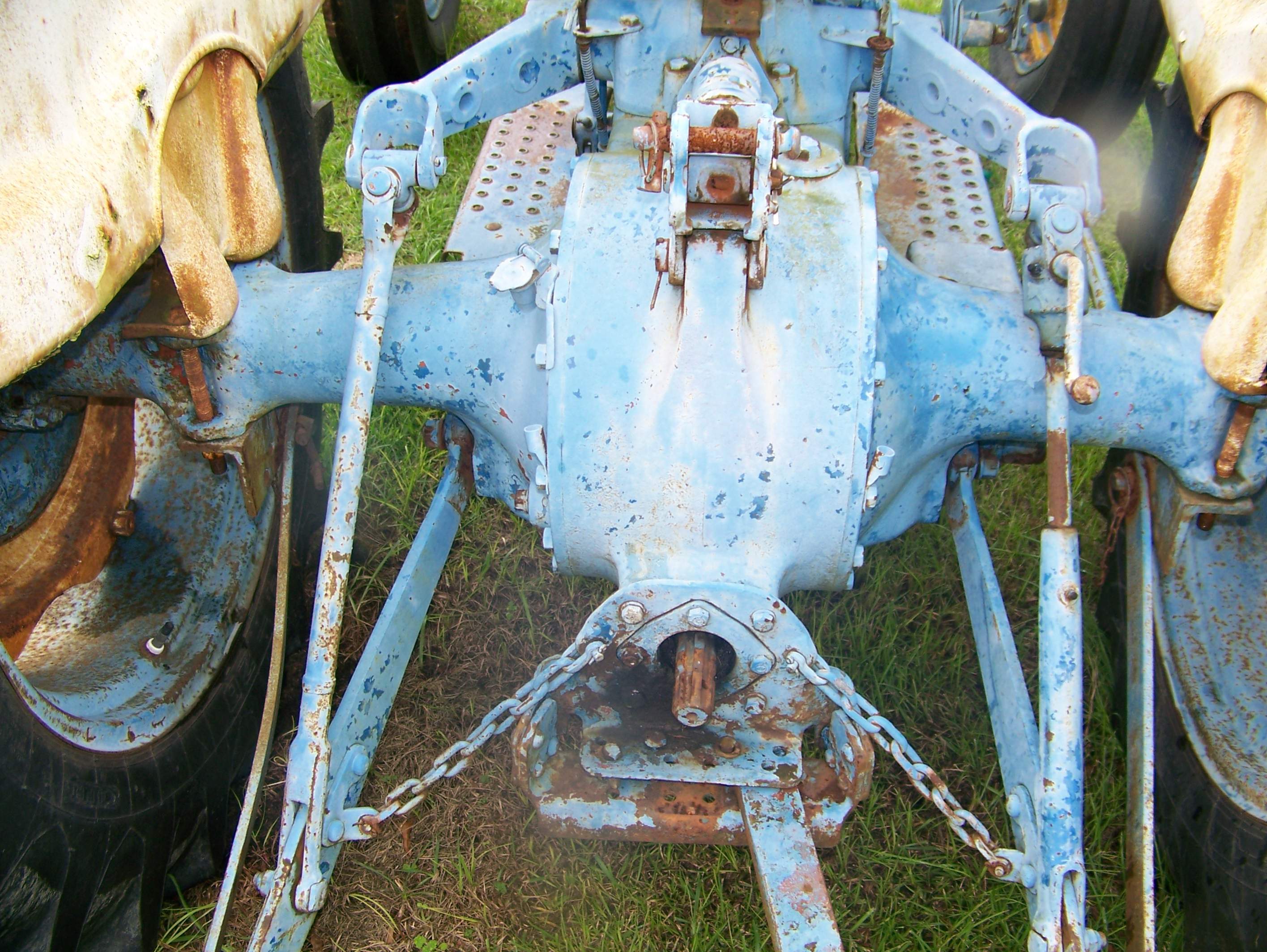

One thing I would check is the 3 point lift. Have 2 big 200# plus guys stand on each lift arm and operate it. If it can not lift them you will need to do some R&R on it. Just got done doing it on a 961. Not a hard job but does take some time and $15 in parts and gaskets.
I would take $2000 and offer him $1800. Show up with cash money and a trailer. If he does not take the $1800 tell him thanks and leave. Let him know you are going to look at other tractors. Make sure he has your cell phone number. 9 times out of 10 he will call you back before you get 5 miles down the road. Before you turn around make sure you agree on a price. If he says he can not do the $1800 tell him you will meet him in the middle at $2000 and be done with it.

ditto on the 3pt. as said.. it's not a hard job.. usually a leaky piston oring and washer.. just grunt work and a 154 GASKET AND ORING KIT WITH ABOUT 100 ORINGS IN IT.. :)

I noticed that the lift had a very minor vibration in it as he lifted it up.
Is that normal?
