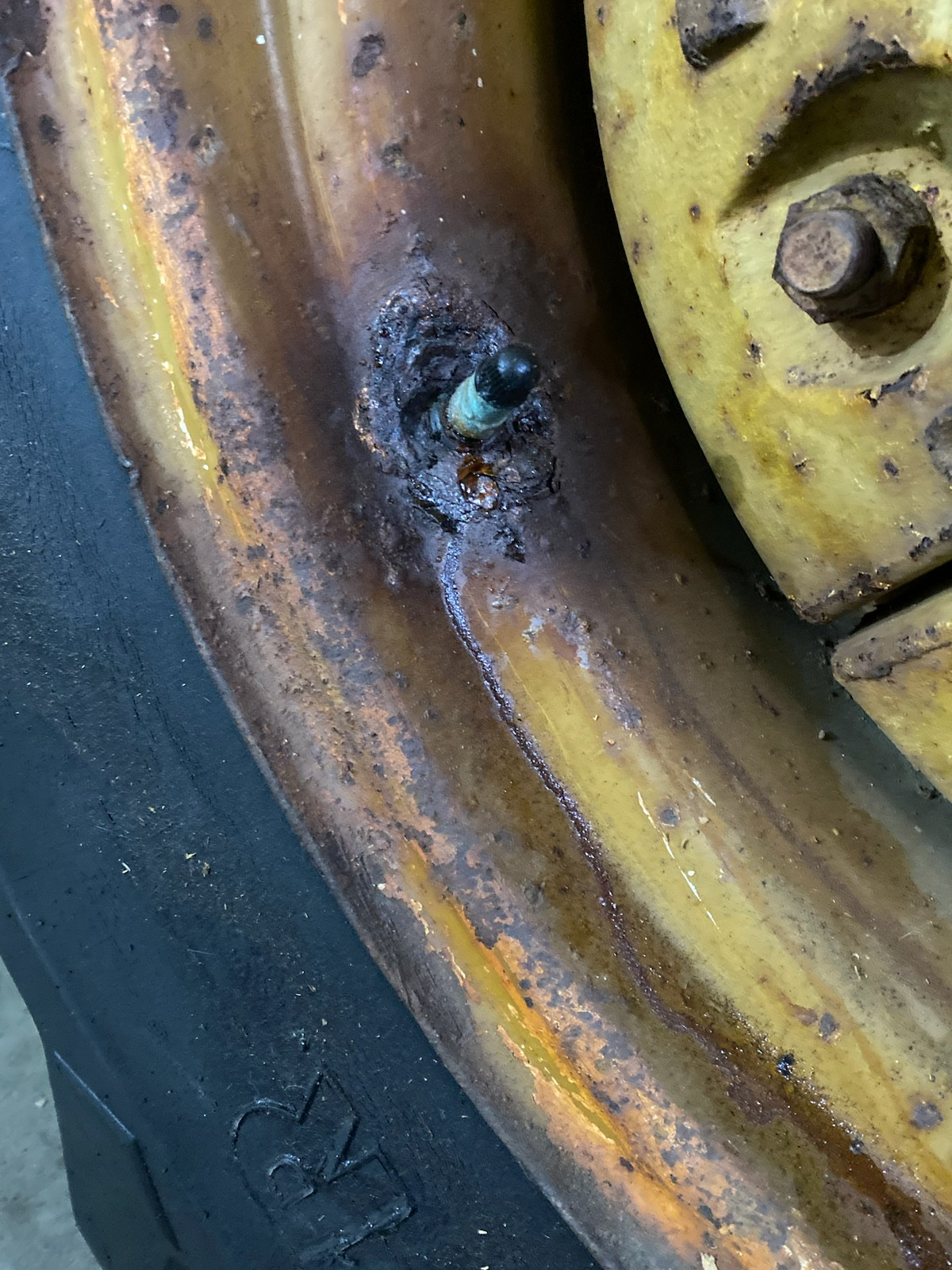

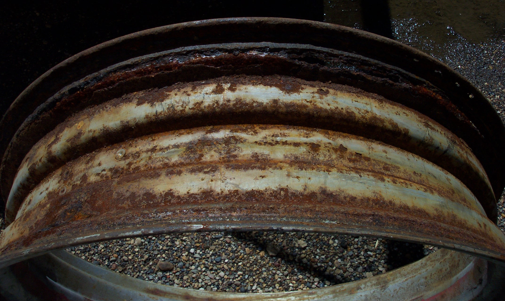

Hello, 1962 IH 3414 filled with calcium(?) leaking around valve stem. How to repair, can it be welded, do they make repair patches ? Thanks for any help, Chuck Schettler Shippenville PA.

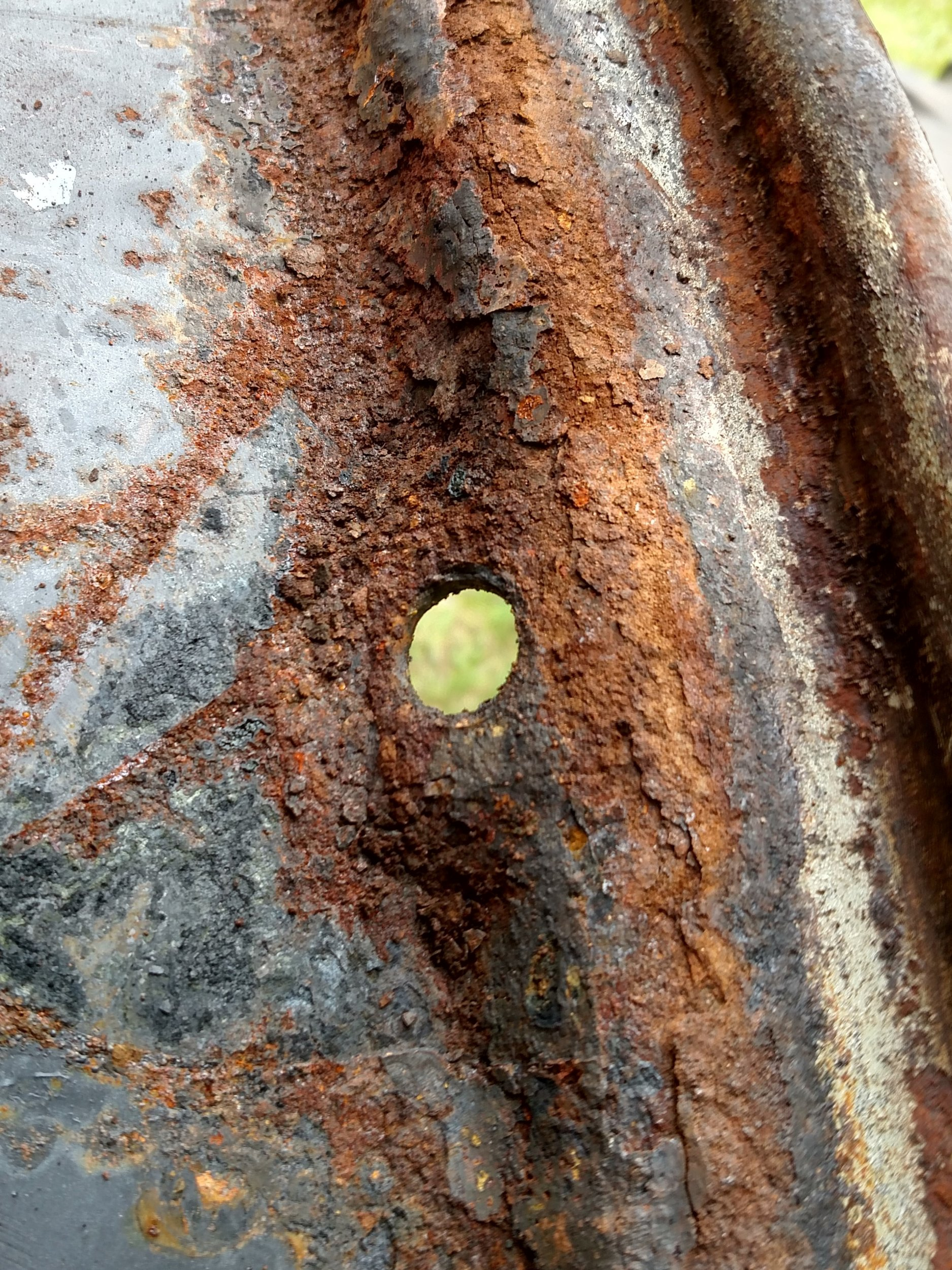

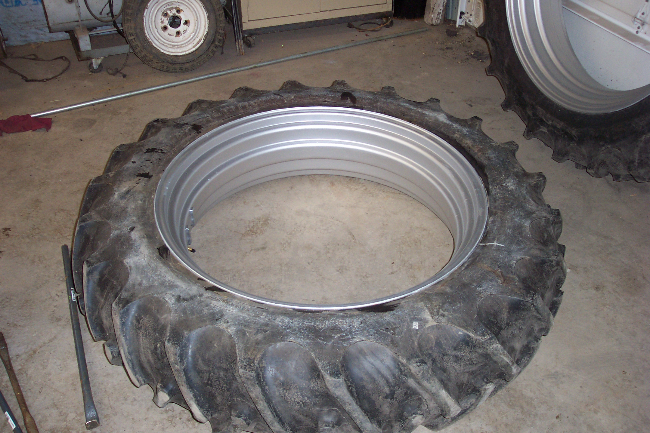

They can be repaired, but be ready for more repair work then anticipated.
I have seen patch pieces cut from other rims and welded in, my last one I used a machine bushing as a valve stem hole and welded and ground smooth along with several beads of weld in different areas including building areas back that disappeared from the weld.

Now the rim on the other side has about a 4" crack visible running from the corroded out valve stem hole.
I think that I will be looking for a new rim, I'm getting to damned old to mess around for several hours welding and grinding again.
The last one was close to 8 hours of repair and wire brushing (grinder) to find and fix all the bad spots, then a couple of days for priming and painting then letting it cure before mounting the tire.

Have drilled a hole on the opposite side of the rim for the valve stem and welded a patch over the original rotted stem hole, not a show piece but it worked.

I was hoping to repair/weld without removing the tire... probably not possible. Now, if someone would make glue on patches with today's glues this might just be possible. Thanks for the replies.

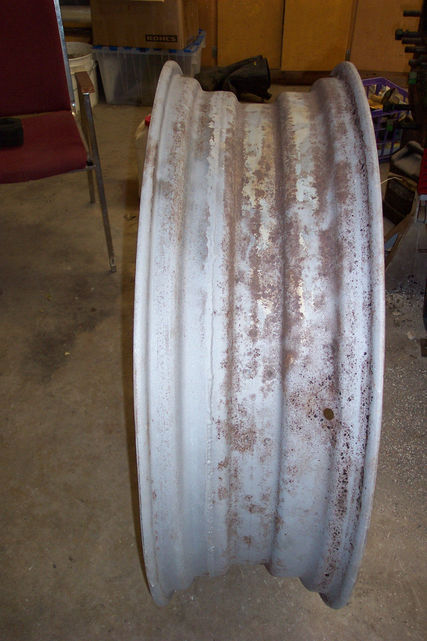

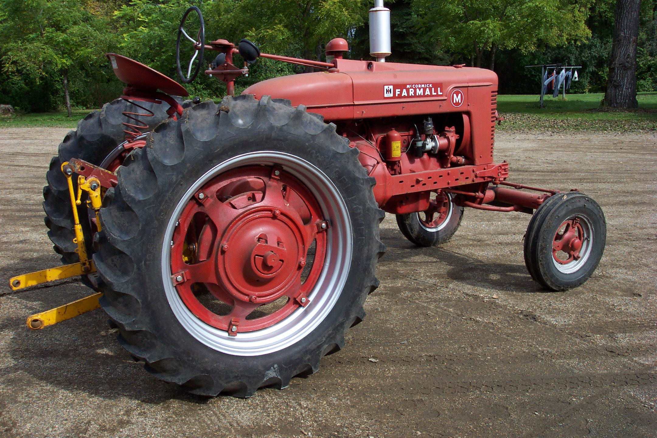

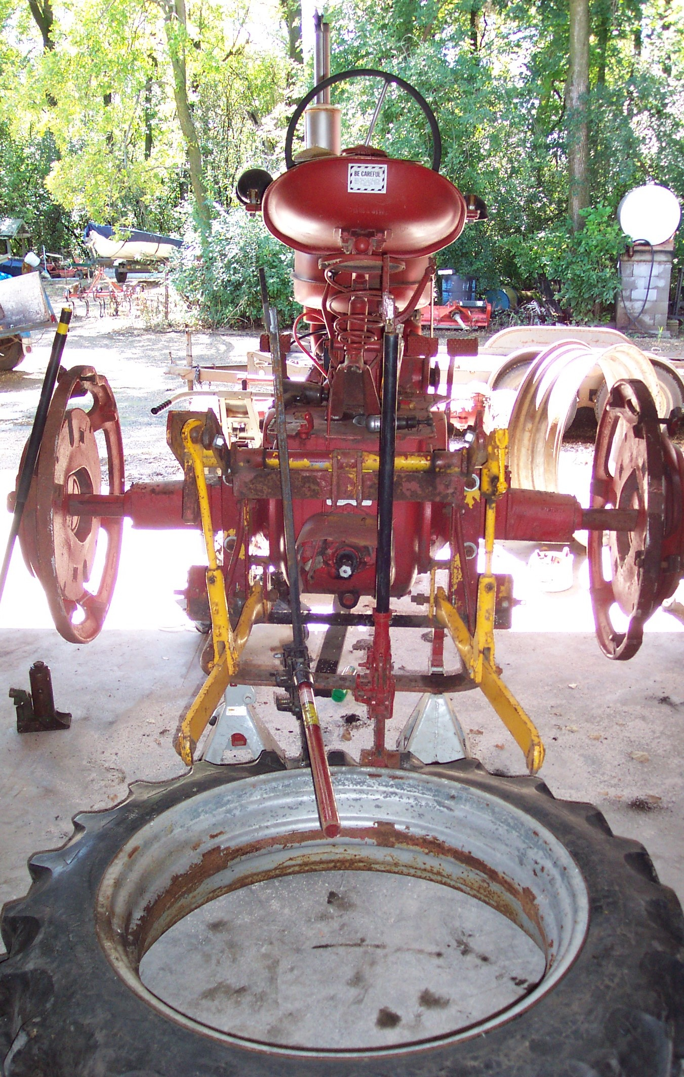

I fixed up my dad's IH "M" that had some serious rusty rims from prior being filled with calcium cloride. Similar to what LouNY experienced. A donor rim was needed for my repairs. Here's what the rims looked like:
Donor rim and one recipient:
Thin spots were built up with the welder or patches welded in place. Valve stem hole was relocated on one wheel. Sandblasted and painted.
New tubes installed....all work done with large tire irons and spoons.....l was younger back then, though.
