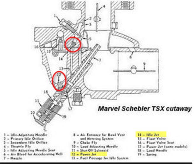

Thanks for all the info gents. It is definitely not a drain plug. it is threaded hole inside the carb. 2016-01-07 08_45_16-carburetor diagram ford 4000.docx - Microsoft Word.jpg See item 12 in the attached picture. I guess I will purchase a jet with a # 8-32 thread and give it a try. There seems to be so much info on MS carbs, but I can't find info on this one. I can always resize the hole if the info someday surfaces.

Maybe this will help.
Click on “jets”, to the right. Then click on “diagram” to find the part number, and then you can click on “jets” to see if they have what you need.

Thanks MMagis, they show 3 different power jets, but are not specific to the TSX-813. I will call them. I appreciate the link and your time!
   / 1964 Ford 4000 4 cylinder repair/restore #16
In the diagram/link that MMagis posted, it looks like item #27, "Seat - Power Adjusting Needle" would thread into the hole you show in your photo, but apparently it is only applicable for "Type B" carbs. Is yours a Type B? If so, it would have the adjusting needle in the top half of the carb body. If not, it would likely be plugged. Either way, with nothing in there, it would sure explain a lot about poor performance!

Thanks for all the info gents. It is definitely not a drain plug. it is threaded hole inside the carb.View attachment 452867 See item 12 in the attached picture. I guess I will purchase a jet with a # 8-32 thread and give it a try. There seems to be so much info on MS carbs, but I can't find info on this one. I can always resize the hole if the info someday surfaces.
Interesting how that's all wrapped up and around that fuel shutoff solenoid. Can you tell if its a jet or a plug in there now?

OP's problem is that there is NOTHING in there now.

By the picture he posted it appeared to be plugged. If it was open the bowl wouldn't hold any gas.

the threaded hole goes from he bowl into the opening for the shaft for the adjusting needle. It is NOT a drain! The tag on the carb says TSX813 63 G. The main adjusting needle shaft enters from the bottom of the carb, not from the inside pointing down as the diagram that I attached on 1/7 9:01am
