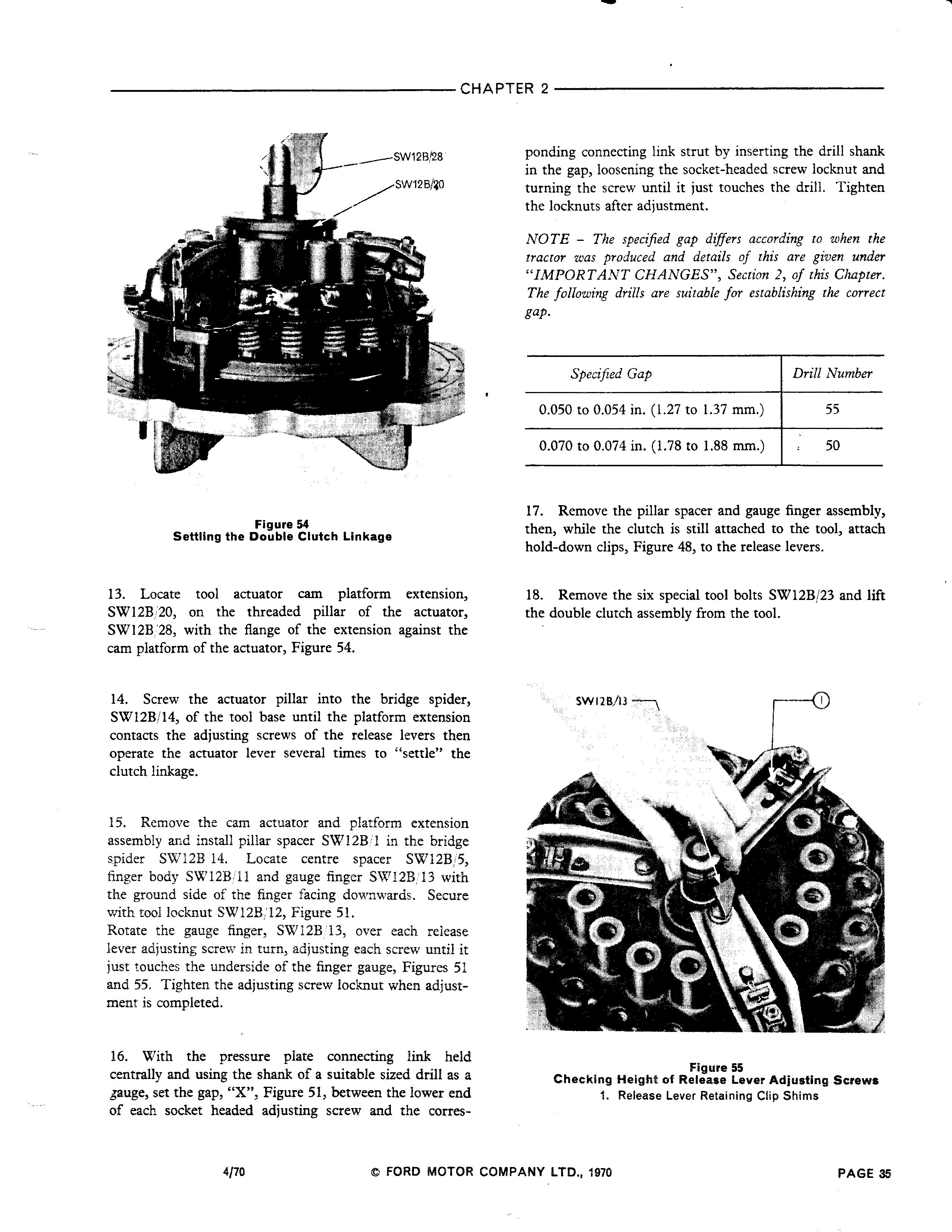

The view in the right lower shows the 3 release levers. The throw out bearing pushes against the 3 adjustable bolt heads closest to the center (1 on each lever). See if damage is obvious when you get around to breaking it down for repairs. When you get to that you may want to start a new thread and maybe someone can help. I might can help a little we have had a few fords around for years and got by so far. No technical help from me just stuff I've run across before. Good luck.

I'll do that, thanks for the info. That will come in handy.
