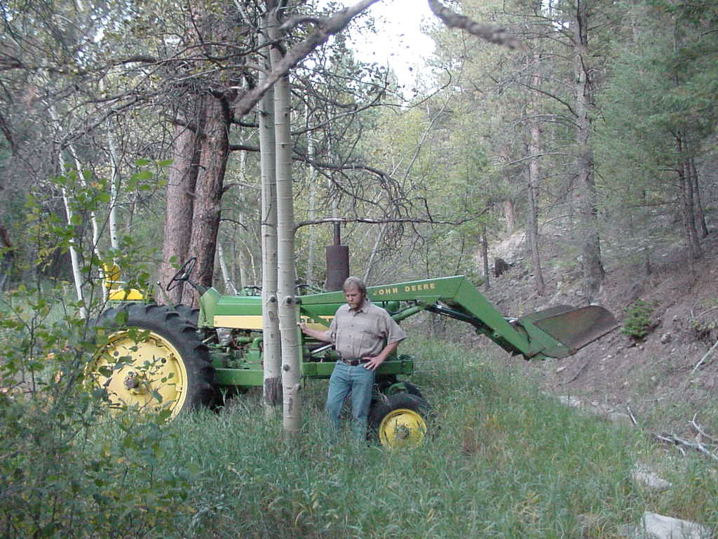

When we got started with rural living we ended up buying an older 1958 John Deere two cylinder tractor. It wasn't what we were looking for - we wanted something new and fancy - but this couldn't have worked out better. We still have it. This is a John Deere model 530 2 cylinder. Makes about 32 HP.... but those are big horses. These later model 2-cylinder gas tractors were pretty good machines. They had all the bugs worked out. We didn't actually want a tractor that old or a gasser, we needed for it to do real work and thought we would prefer a diesel, so we were actually looking for a mid-sixties diesel John Deere 3010 or 3020 with 45 to 55 hp. BTW, those are models that fit your description of what you are looking for. Take a look if one comes your way. Many of those were made, and many still working. In fact, those would be my first choice for what you are looking for.
But we ran across this slighly older 2 cylinder JD almost by accident and found out that something that a lot of people don't know about those late model 2-cylinder tractors is that JD equipped them with a a lot of things that were going to be standard on the next generation of tractors. Real modern conveniences like suspended seats, power steering, high flow/ hi pressure hydraulics, remote hydraulic outputs, quick-attach loader, the easy-adjustable cat1/II 3pt hitch with telescoping arms, modern filters, power-adjustable rear wheel width.... the list just goes on and on. Parts are inexpensive and available; my local JD dealer still carries a lot of two-cylinder era parts in stock. And the manuals for those old tractors are things of beauty themselves. They were designed for the rural person who did his own work.
So those late model two cylinder JDs are special. And it is an easy tractor to work on. If needed, I could rebuild both brakes and the clutch in an afternoon with hand tools for a few hundred bucks. In fact, none of the parts cost much. Maybe that's because all these years later the tractor still works like it should. The tach/hourmeter flat work out at about 12,000 hours. When I opened it up (yes, the tach is rebuildable) the bushings were worn clear thru. I replaced it with a brand new one. That was probably the most expensive repair we've done. Cost about $200. All the rest of the gauges and switches are still original. We don't use the old JD much anymore except for field work - but that is more a matter of being spoiled by the convenience of the new tractors with their cabs and HST transmissions. The old JD still works just fine. In fact, for sheer traction and 3 point pulling ability it will pull with anyone. Comfortable to drive, too. No cab, but it does have a clever umbrella for summer.
Anyway, I just wanted to let you know that your idea about an older 2 wheel drive tractor sure did work for us. We got a keeper for a fraction of the cost of new. A real member of the family.
