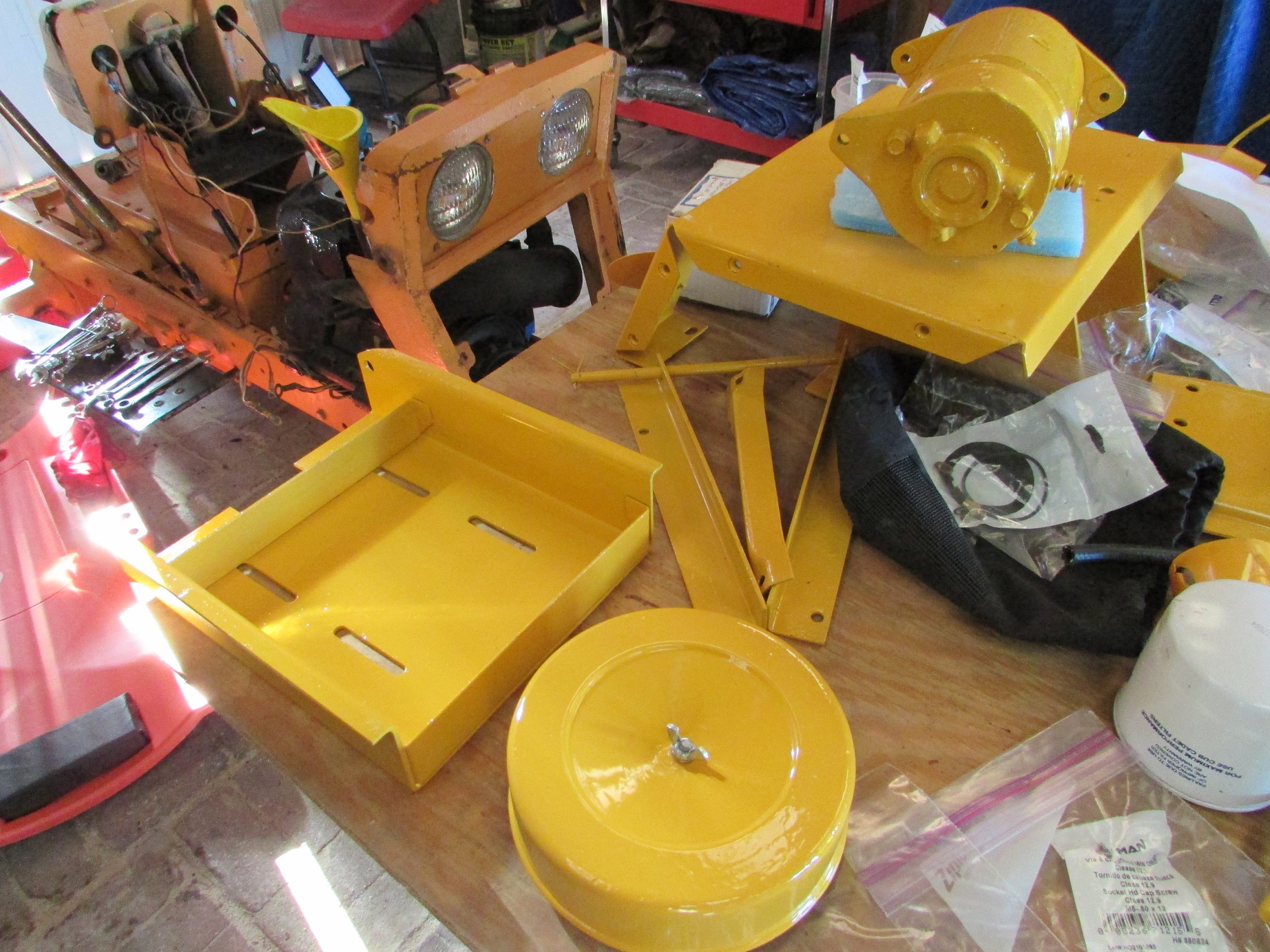

I was missing one tiny 10/32-1/4 screw that holds the air cleaner base on. Napa, two stores didn't have anything smaller than half inch. So, why not try the Kubota dealer, they've been there a long time, and sure enough, in a yellow little parts bag, had been on their shelves for over 30 years, was one little genuine Kohler screw for $1.79. I sure took it and ordered another. So if someone takes off my air cleaner 100 years from now, they will surely be impressed by those genuine oem screws....;)
Kinda wondering if that wheel spinner had been outside for a while before it ever made it to this little garden tractor. I wonder if it's a collector's item, genuine solid aluminum spinner from the 50's or 60's. yeah, putting that screw into the steering wheel clearly showed one prior owner, I have no idea how many people have owned this before, was really a low class act. There will always be a rough spot there though I guess I can fill it in with some rubber/plastic repair kit. Actually, these whole wheels are available in the used market. The steering wheel will look nice once I get the spokes painted in shiny aluminum, or maybe fake chrome.

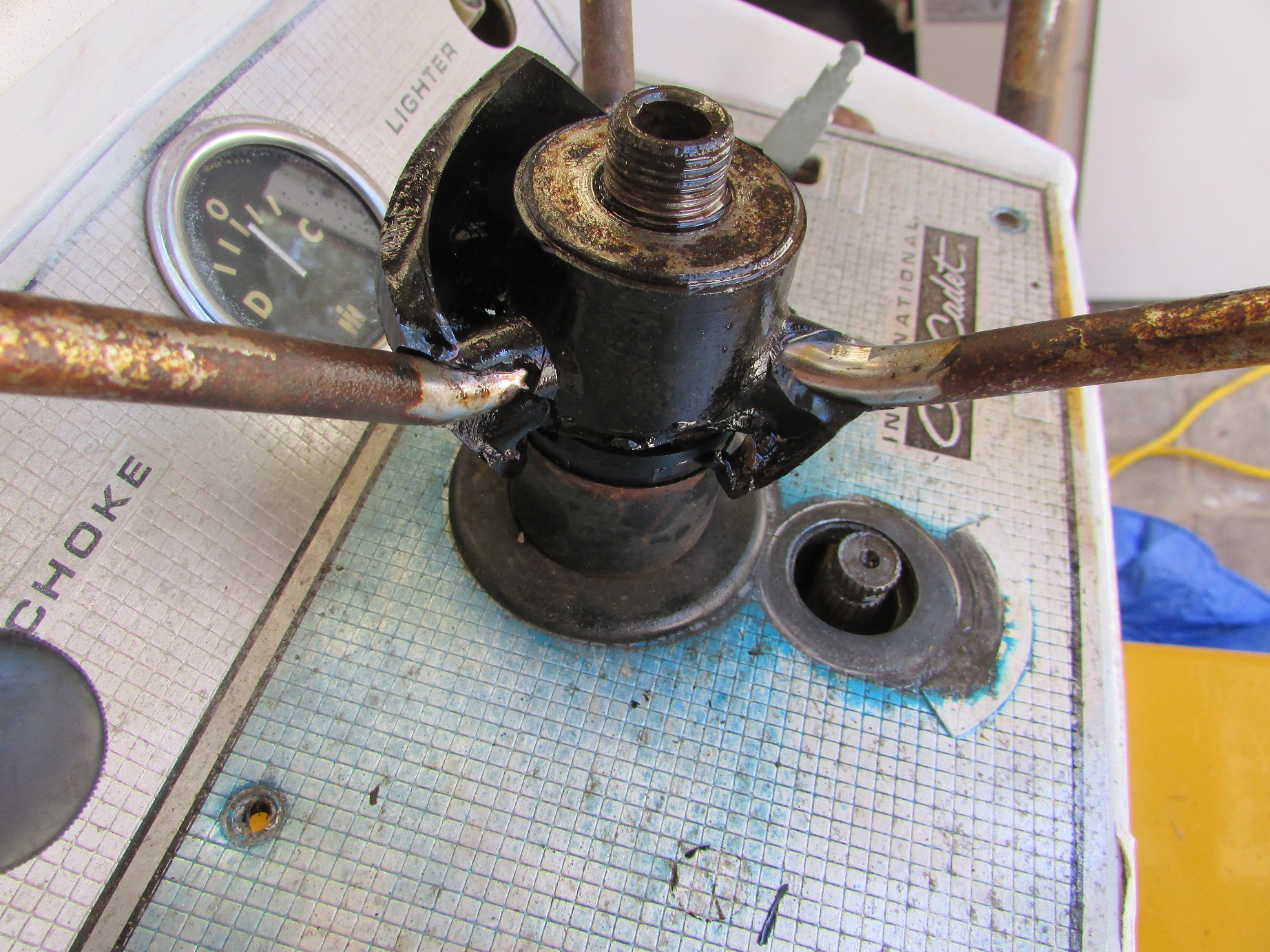

lamblessed, thanks for the link. Good info. Unfortunately my seat is totally off and everything is taken apart; wish I knew this years ago...

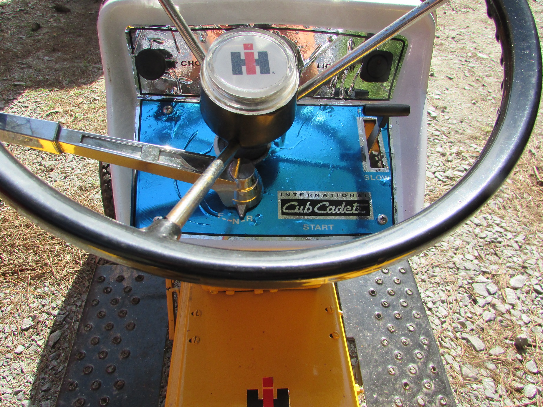

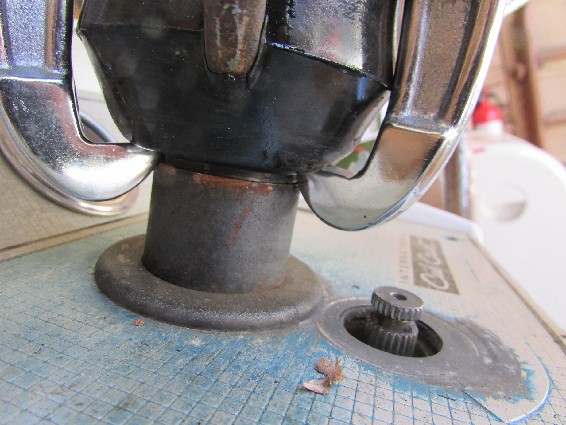

But I do have a large fireman helper who might be able to supply the muscle. But now I'm really confused. What "steering wheel nut" are they referring to?
There certainly isn't a conventional nut on there...maybe there should be. :confused:

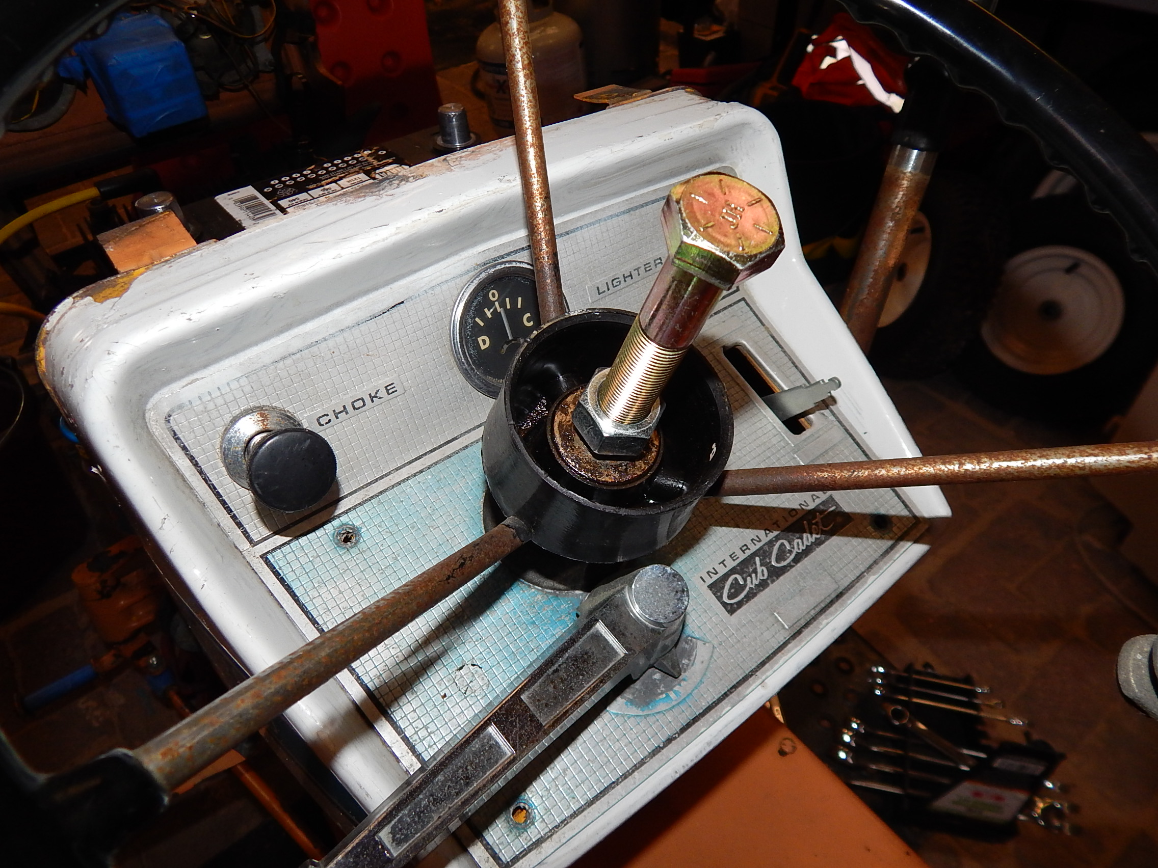

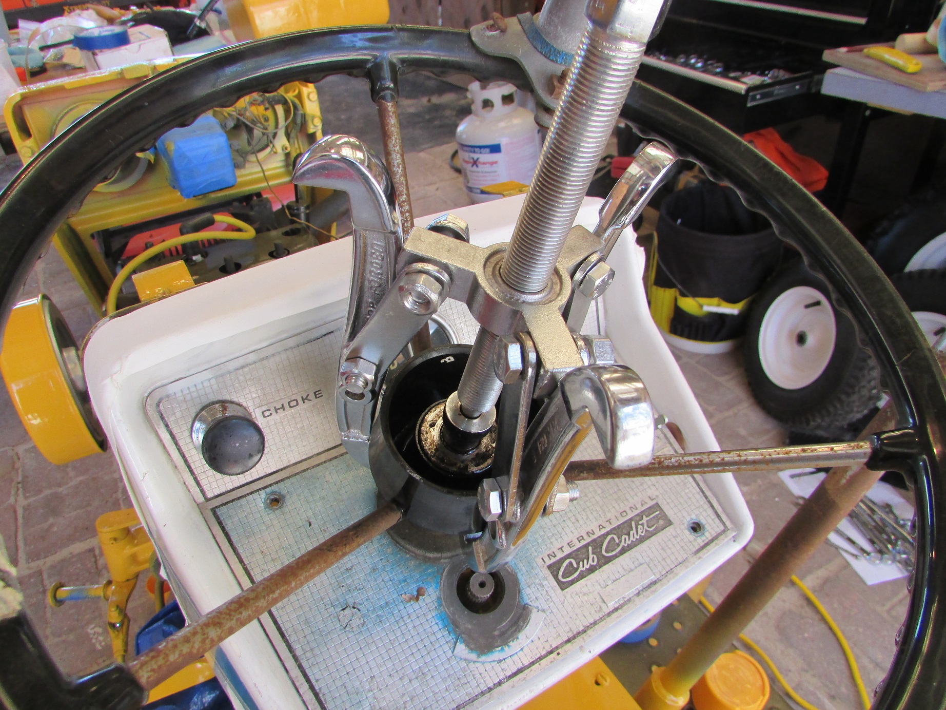

Dave Holtmart - 06:27am Jun 8, 1998 EST (#570 of 890)
Robert Mull, Here is another way for you if you don't have a 3 jaw puller. Go to your local hardware store and buy 5/8 fine thread bolt about 3 to 4 inches long with a nut, remove steering wheel nut and place new nut on covering about half of the threads on steering shaft, screw the bolt down inside the nut so it's tight, sit on the tractor seat with a hammer, place your knees under the outer part of the wheel and push up against the wheel and hit the head of the bolt squarely, may take a few blows to get the wheel to move. Don't place the new nut tight against the wheel leave a little room (afew threads 2to3 ). This is how i remove steering wheels as i don't have 3 jaw puller that will work, have removed several this way even old rusty ones.
Dave
Harry Bursell - 11:04pm Jul 19, 1998 EST (#879 of 890)
Dave Holtmart @570 - this is going back a ways, but wanted to let you know I pulled 3 steering wheels today using your method of a nut and bolt, hammer and up pressure with legs on wheel. It worked slick, really great, etc. I didn't bugger any threads or chip or crack the wheel as I had been with a puller. Hey guys, this is the way to remove your steering wheels. Suggest you print a copy of 570. Thanks again Dave.

   / 1968 CC 125 Renovation #13
load test new batt: the smaller batteries used by L&G powered eqpt (as compared to automotive batts) have some notoriety for weak/dead cells when new - but will show an acceptable surface charge. Best way to avoid is to have new batt load tested by retailer when purchased to avoid an early life failure. Such can be done at no charge by the dealer.
steering wheel nut - the large nut that secures the strg wheel assy to the steering column shaft.
#14
well now I'm thinking the nut that should be there was removed by the prior owner who couldn't get the wheel off either...
going to look in parts diagram and see if there is a missing nut. The shaft is threaded, but there's no nut there...

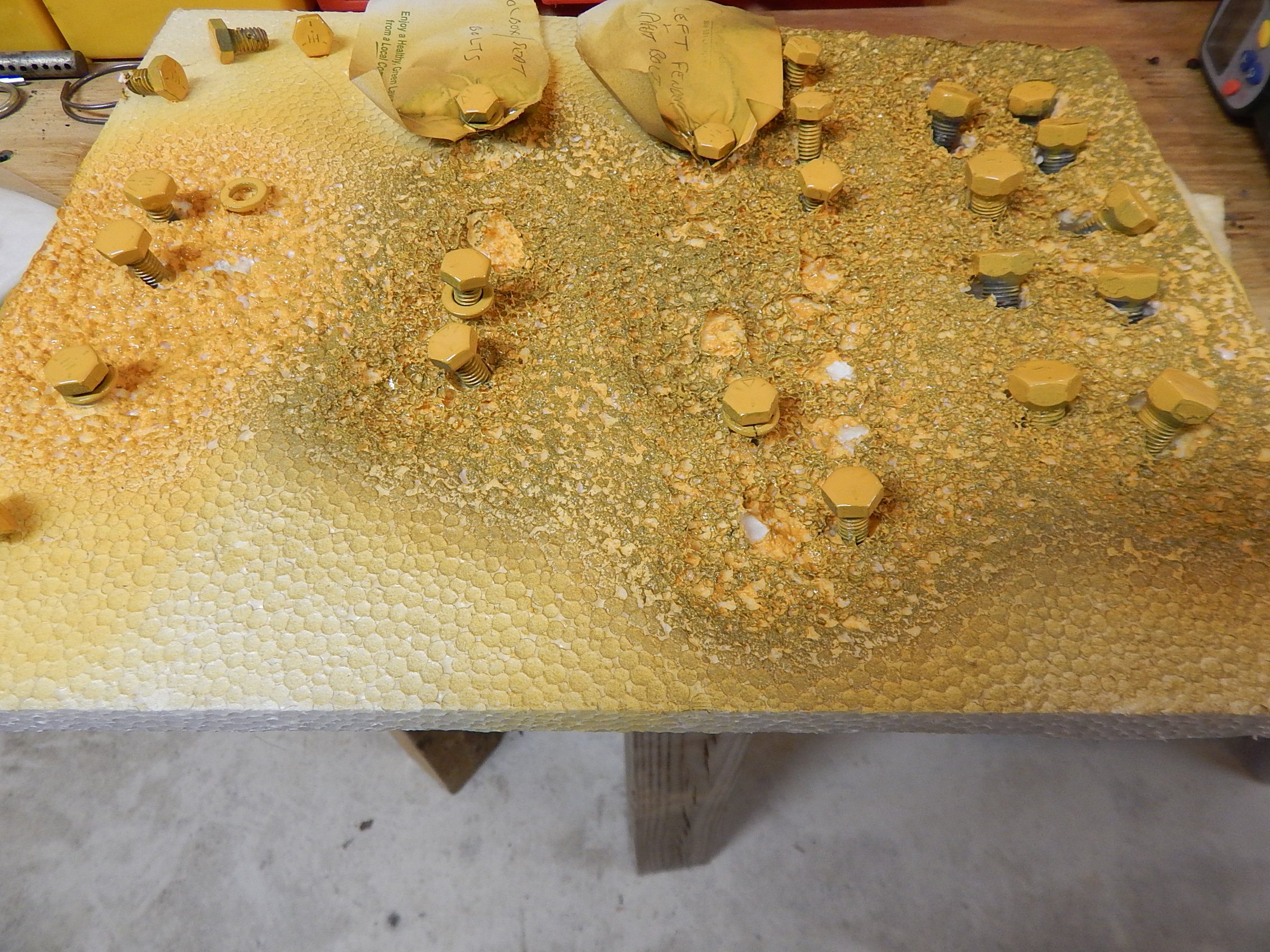

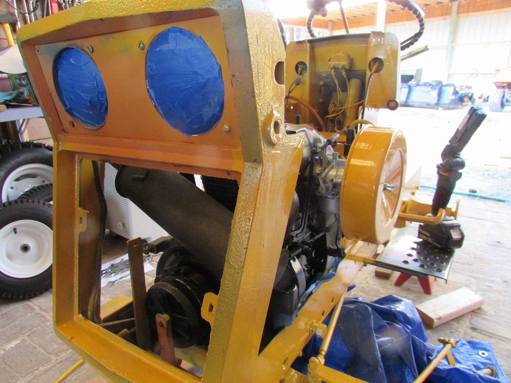

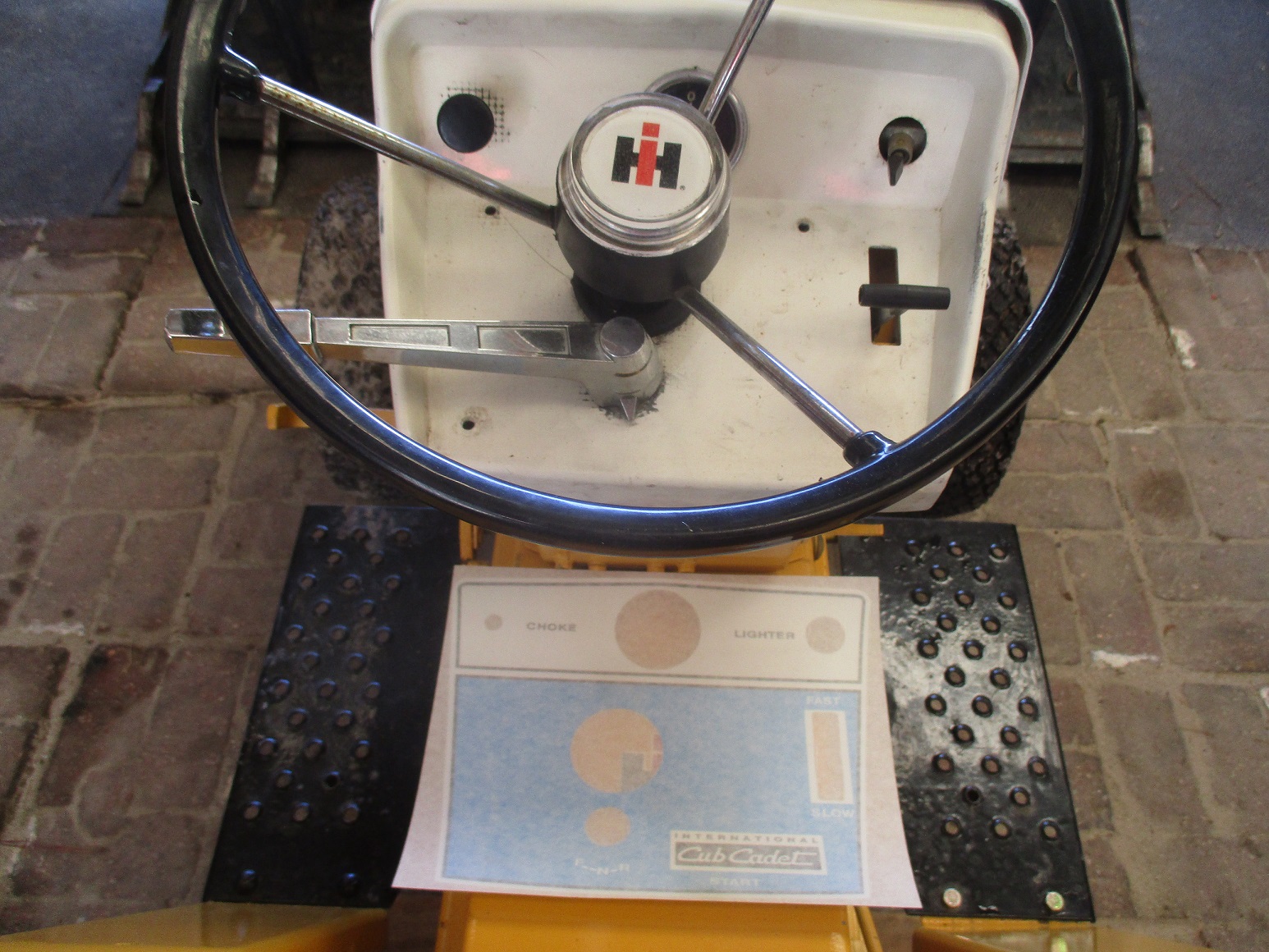

made some progress on priming and painting today. Challenging, had to heat up the parts in the woodshop, take them outside to paint,then bring them back into dry in the heat. Worked pretty well. Funny thing happened when I was painting some of the bolt heads. Usually I poke holes in cardboard and push them in the holes, but I had a sheet of styrofoam from a box and used that instead. Big mistake. The etching primer melted the styrofoam and lots of the screws fell out. I figured it had to be the acid doing it but no, even when using the final yellow paint, it still ate the styrofoam. Something for sure is reactive, going back to cardboard.

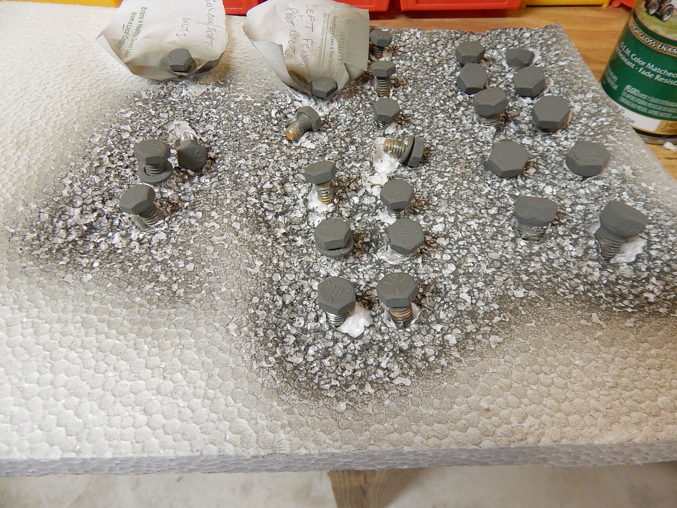

I got the bolt and nut for the steering wheel and sure enough it all screws in as suggested. Will have a big helper next Monday and he and I are going to get that wheel off. Meanwhile, a steady diet of PB Blaster. And lastly, took all those little painted bolts and pushed them into a sheet of cardboard for a final coat. But it was just too cold today to paint and not looking too good for a few more days either. Might even get snow tomorrow, pretty rare for here. This CC will sure never see snow.
Ok, now who knows the trick of getting those bolts in and tightened without wrecking the paint? A wrench might only chip two sides vs a socket that could chip every corner. Usually I have to go back and touch up but that's hard with a rattle can when you have color changes nearby, and you don't want to get overspray. Then all I can do is resort to tiny paint brushes. Better I'm sure to get the bolts on tight enough and then worry about making them look nice, not the other way around.

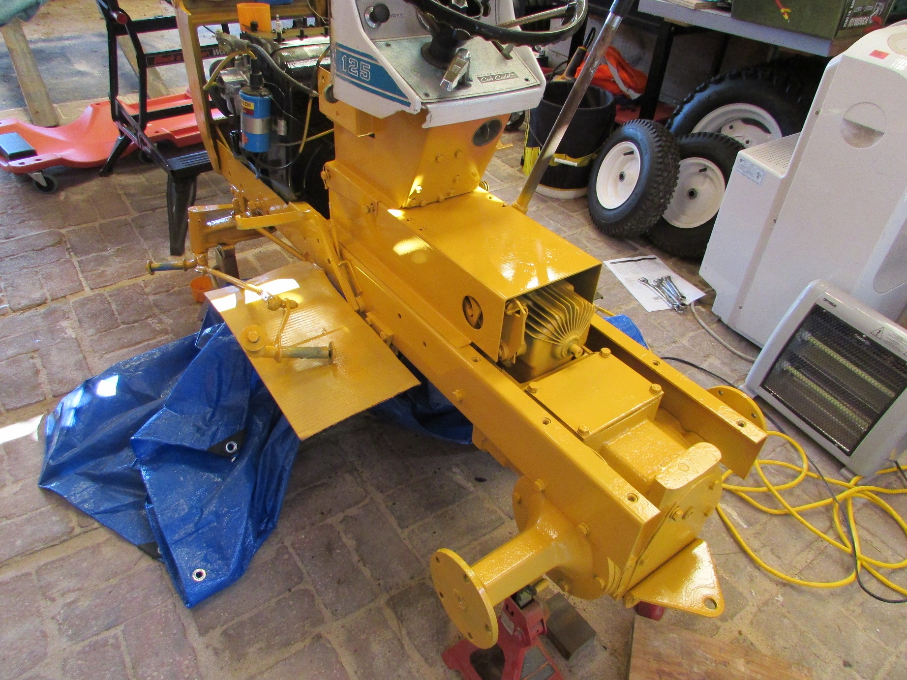

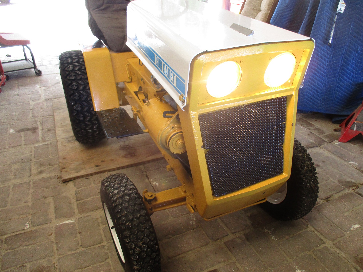

got some additional painting done yesterday, warmed up enough outside so if I heated up the objects in my woodshop, took them outside to paint, then brought them back into the warmth, it worked...Will be Sunday here before I have a sixty degree day but still not sure that will be enough to paint the main body of the CC. I have an IR heat gun and while the air might be warm enough, the tractor isn't. Usually condensation is a tell tale sign. I might put some portable electric heaters on it overnight and then perhaps sunday afternoon see if the metal is warm enough to paint. Usually a min of 65 degrees for this oil paint.

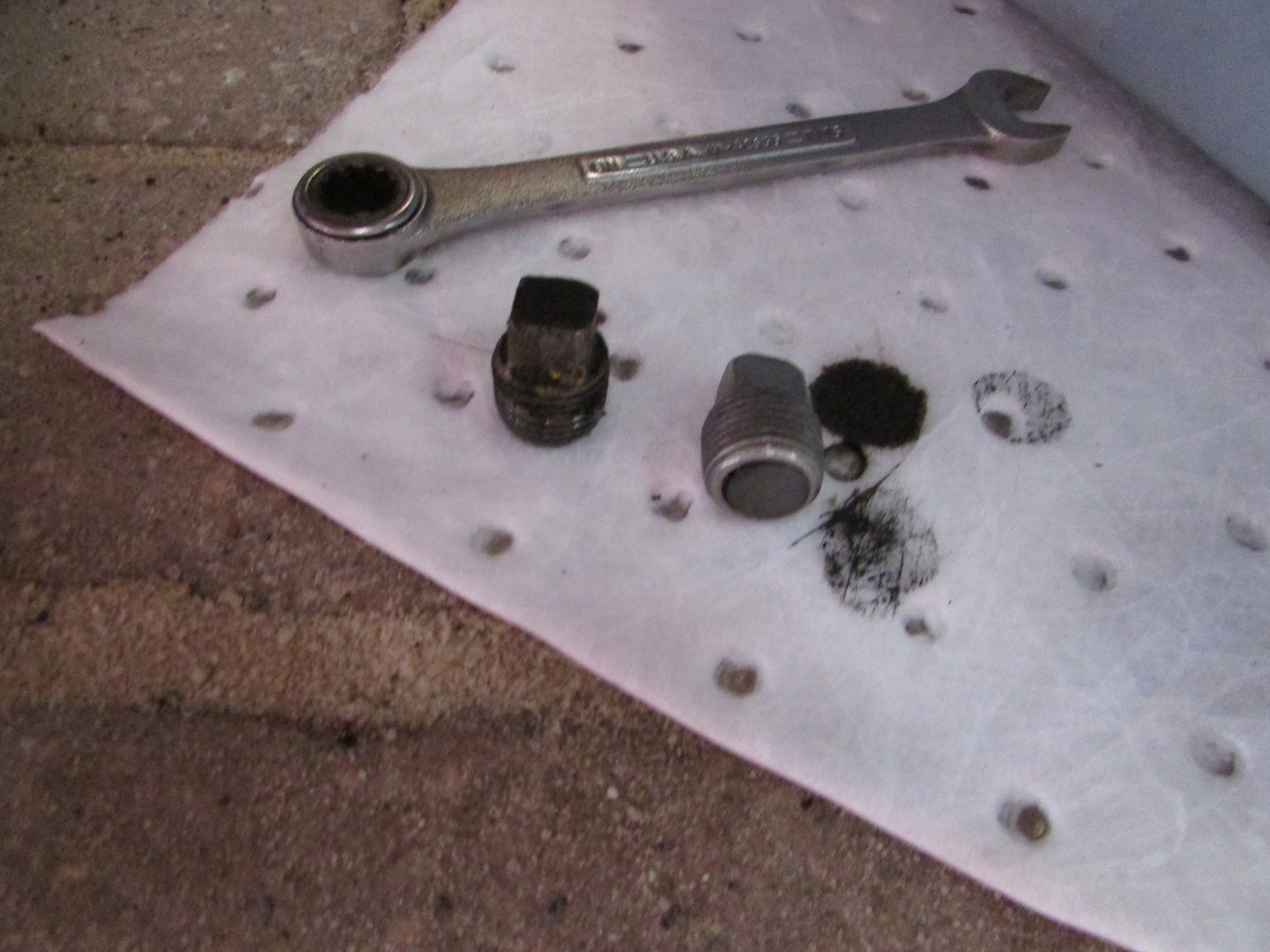

Changed the oil and now wish I had done it three years ago when I got the unit. Dirty oil sat in there that long, not the best...when the engine finally gets running I'll change the oil again when it's warm. Replaced the stock oil plug with a magnetic one.

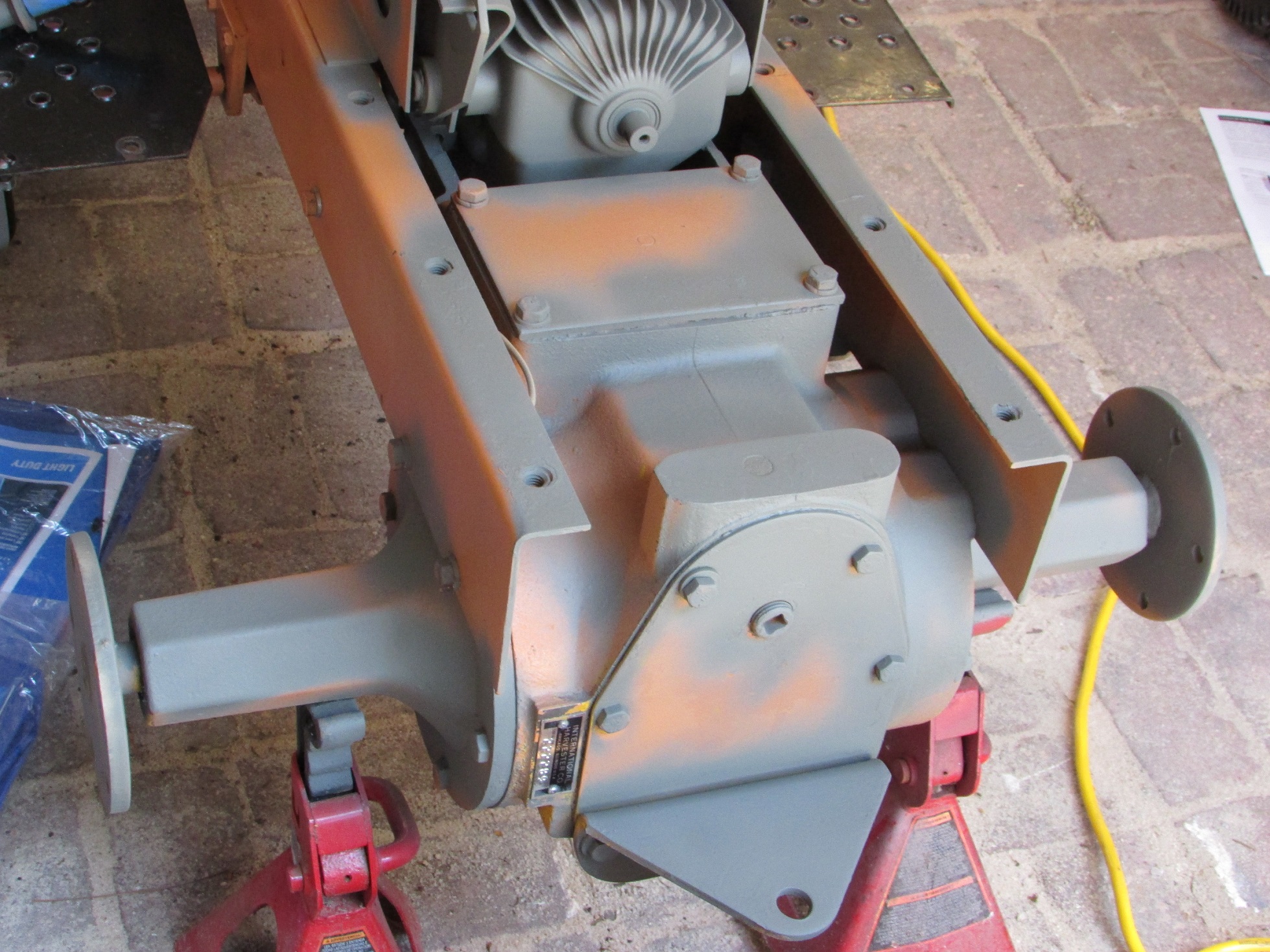

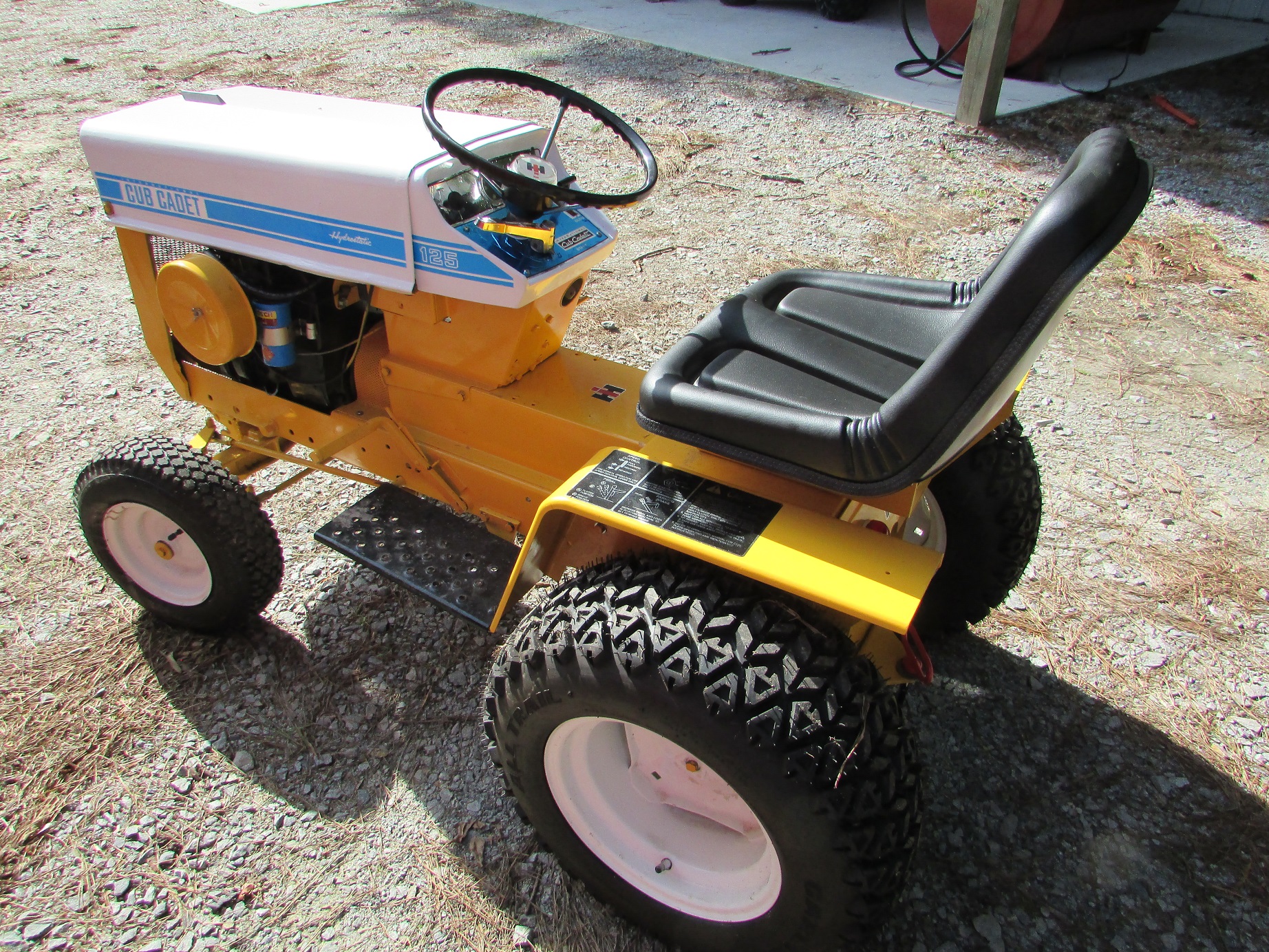

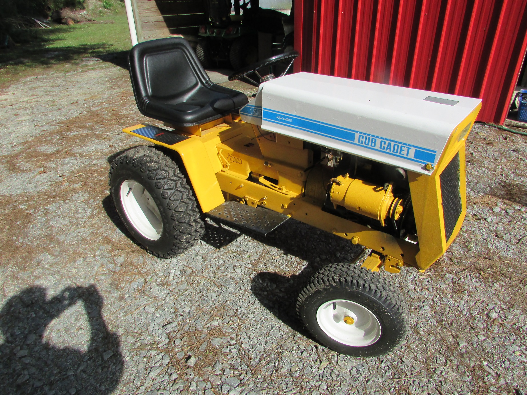

very pleased I got a warm enough day in to get some frame painting done. Still have the front and all the little details to do, but good progress.

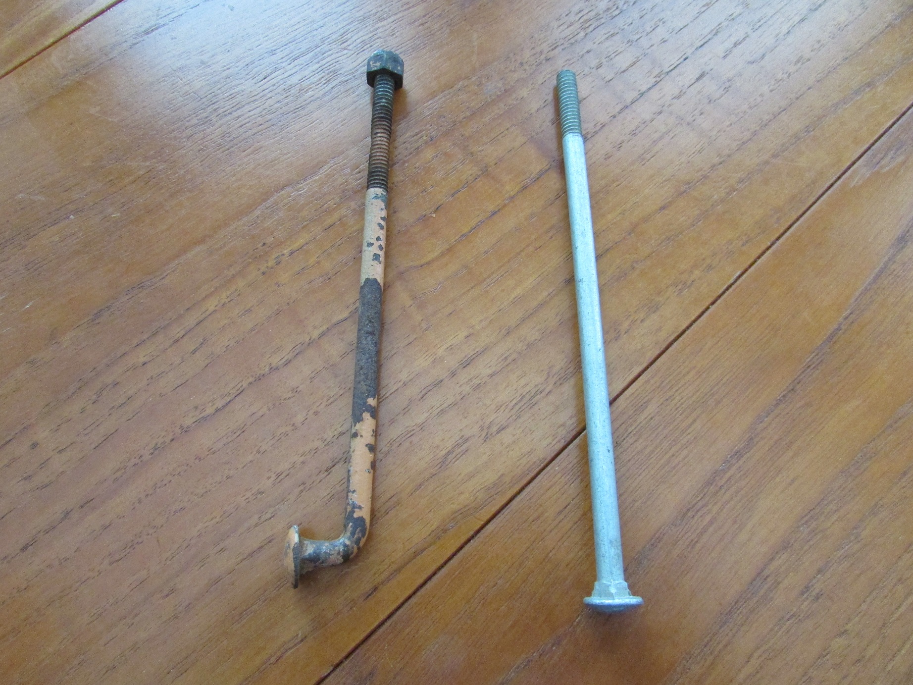

Need to make a new battery hold down post; one got lost. I'll put this in a vise and heat it up and hopefully I can bend it.
Once I heat it up, any suggestions on how to bend this thing without ruining it? I'm thinking of a jig of some sort with vertical posts, like a bending jig.
The bend is right up near the head too.

You should be able to just heat the one area with a torch and use pliers or vice grips to bend the head 90 degrees. Another way is to slide a box wrench, just big enough to slip over the threads, onto the bolt and use it to bend the head. Obviously keep the wrench away from the area you're heating until you're ready to bend it. The torch would take he temper out of the wrench.

Bob thanks, my challenge is that flared head; I can't get a grip on without deforming it. So I have to grip just below it and not much
room to maneuver. Maybe if I put it in the vise, heated it up, put that wrench on the bolt part under the crown, and beat on it carefully...,
perhaps it will bend nicely. I was also thinking of drilling two holes in steel, mounting bolts close together and building a simple bending jig. Without welding, not sure
I could get the verticals close enough together to work. I bet HF has a tool for this for five bucks...going to look this up.
update: HF has dozens of benders and they all look like they won't bend close to the flared head easily.
I'm headed to HF tomorrow for a steering wheel puller, will look at what they have and take my original along and see if it fits in any of them.
