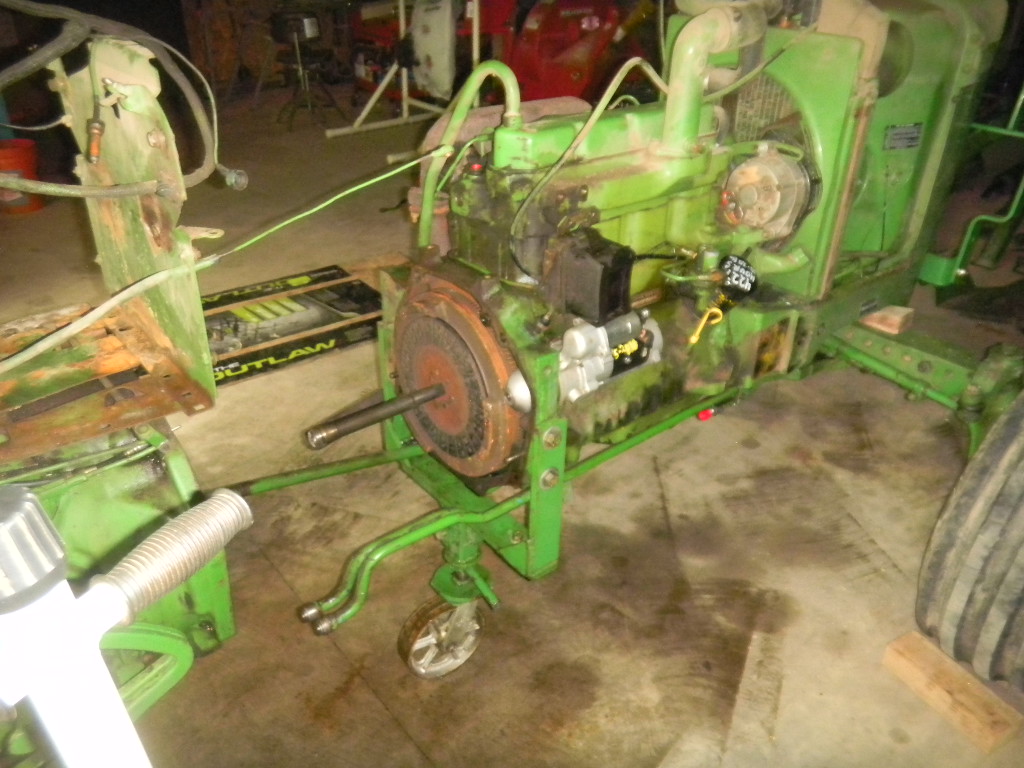

Since both of you mention rolling one end away from the other... What sort of supports were you using to hold up the end that was moving? The SM only shows stationary legs to hold up the back and for the front they are assuming you are taking it apart, including using a sling to lift out the engine. I'm puzzling over what I could use to hold up that much weight while also rolling.

Perfect. So if I can put solid supports under the back 1/2 and use a gantry crane with a sling under the engine, it should allow me to move the front end forward. How far apart do you think they would need to go? I'll need to plan for where to set all of this up and I don't want to find out I didn't leave enough room after everything is apart.
I built a splitting stand/support with a large, steerable steel wheel. It also uses an ACME thread for height adjustment. I made it to bolt where the side frames bolt to housing the clutch housing bolts to. This was for my JD 2030
