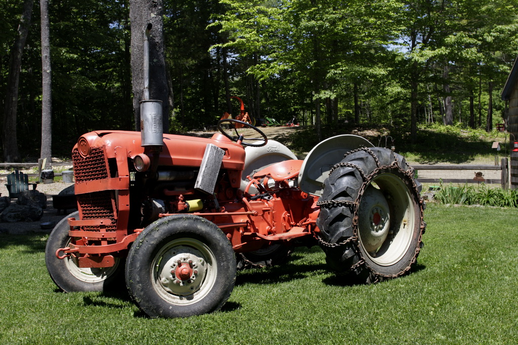

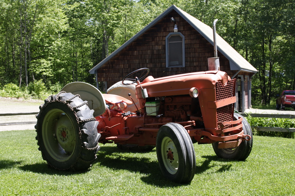

Hello,
This is an update. I did pass on the pile of junk iron at the dealer and finally pulled the trigger on a 1959 641 from a private owner. The tin is in sad shape but the motor starts and sounds great, PTO works, 3 PT hitch works and the tractor seems to be in nice shape mechanically. Thanks so much to all that chimed in on my original post.
Now to my first few Ford questions. The fuel shut-off valve on the bottom of the tank leaks very bad so I am in the process of removing it to take a look at it. I have read online that this valve seems to be a chronic issue. I need suggestions on where to purchase parts like this and also suggestions on where to buy a user manual and shop manual.
Thanks,
Bob W
   / 1972 FORD 4000 #24
if it is a screw in valve you can usually rebuild them with 2 orings. if it is a lever vlave, just replace it.
If you don't feel like prying the stop rivit out of the old valve and putting an oring on the stem and then tapping hte small hole for a machine screw to provide a stop for the stem.. then replace the screw on unit too.
Many of us fix them as the price is 25-60$ vs 25 cents of orings.
I&T fo-20 shop manual covers general maint and service. if you want to rebuild the tranny or engine.. i'd get the more spendy ford shop manual. for all else.. the fo-20 suffices if you are slightly handy with a wrench.
there are owners manuals online.. places like N Tractor Club
Many parts can be had from sites like 301 Moved Permanently
and many many parts are available thru a CNH dealer.
sparex, A&I, tisco are the leading aftermarket makes of most of the parts.
ignition parts can be had at napa and similar stores.
