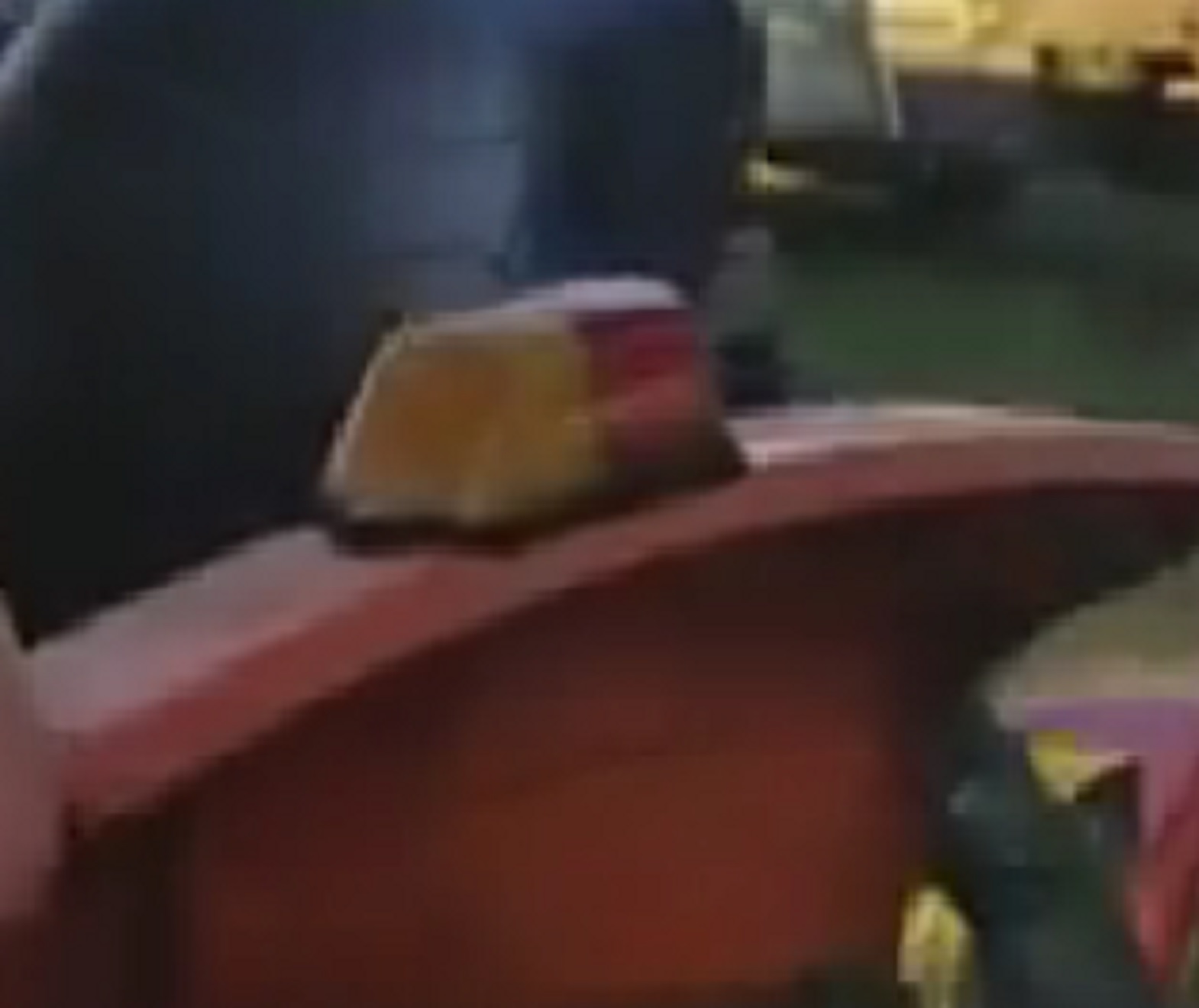

New to forum.....looking for the last list of parts for family tractor restoration. In need of the following (new or used):
32240-34222, lens gasket (2)
32240-34272, lamp socket (2)
32240-34170, cord with socket (2)
32240-34290, ring (4)
Kubota says these parts are discontinued so I'm desperately hoping someone has a lead on them. Any help would be appreciated.

Can't you just make a gasket out of an old inner tube and and epoxy in an 1156 or 1157 socket?
/ 1972 Kubota L210
Thanks Airbiscuit. Problem is there痴 a rubber boot that fits around a metal base plate holding the socket. Then there痴 a lens gasket that sits on top of the plate, the lens then two screws, washers, nuts. Without that metal base plate I知 kind of sol. And no luck with Coleman. Been searching salvage yards too, no luck so far.
/ 1972 Kubota L210 #7

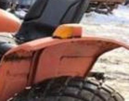

Is this what we're talking about?
Is your lens intact? Could you fab up a base of wood or fiberglass?
/ 1972 Kubota L210 #8
/ 1972 Kubota L210
#9
Yessir, that痴 it. Found two lens at Pillar Equipment and should have them next week. Worse case is to fabricate the metal bases out of galv metal or aluminum using the lens as a template I suppose. But if I can find the parts needed I壇 grab them in a heartbeat. With my L210, I知 starting with having nothing. Back in ?5 or so, my dad and I took turns ripping those assemblies off under some low hanging branches.

Why don't you post a pic of the L210 in its current state?
/ 1972 Kubota L210
#14
Well, hope they uploaded. Like the rest of us, she痴 showing a little wear and tear. But runs like a champ.
So, I just had to do that on my Kubota L3010. One of the rear lights was kind of broken. Rather than buy a whole new unit, I repaired the housing with epoxy glue and plexiglass. I bought a new lens ($17). Couldn't get the bulbs out so epoxied in new 1157 sockets. It is now good as new for about $20! If I had it to do over again. I would have bought sockets that also had a pigtail for the ground wire. I struggled a bit soldering one on to the socket base.
/ 1972 Kubota L210
#16
All good suggestions. I was able to track down two lens still in original boxes along with other various pieces. Waiting to hear back on some salvaged pieces which should complete each light assembly.
