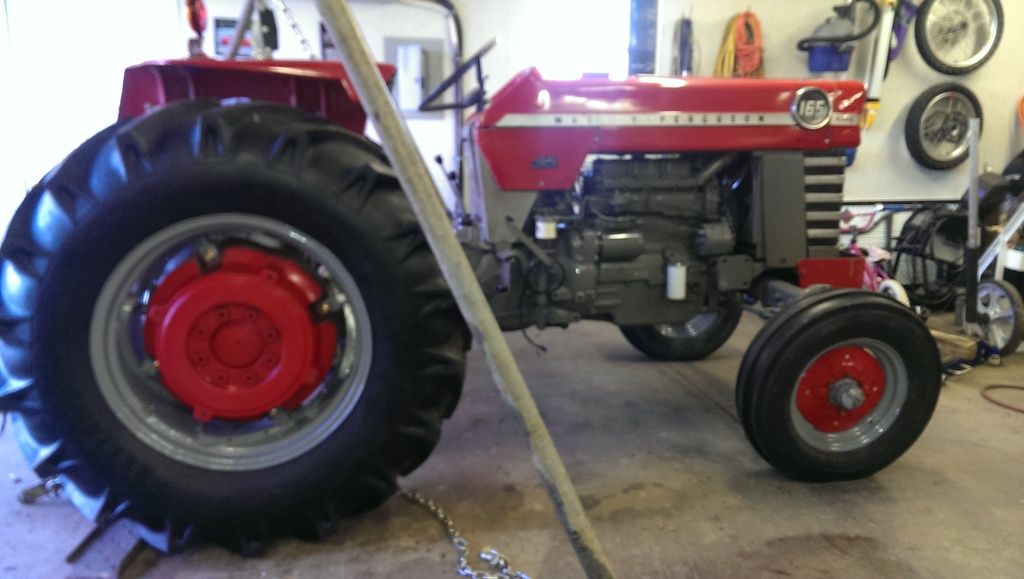

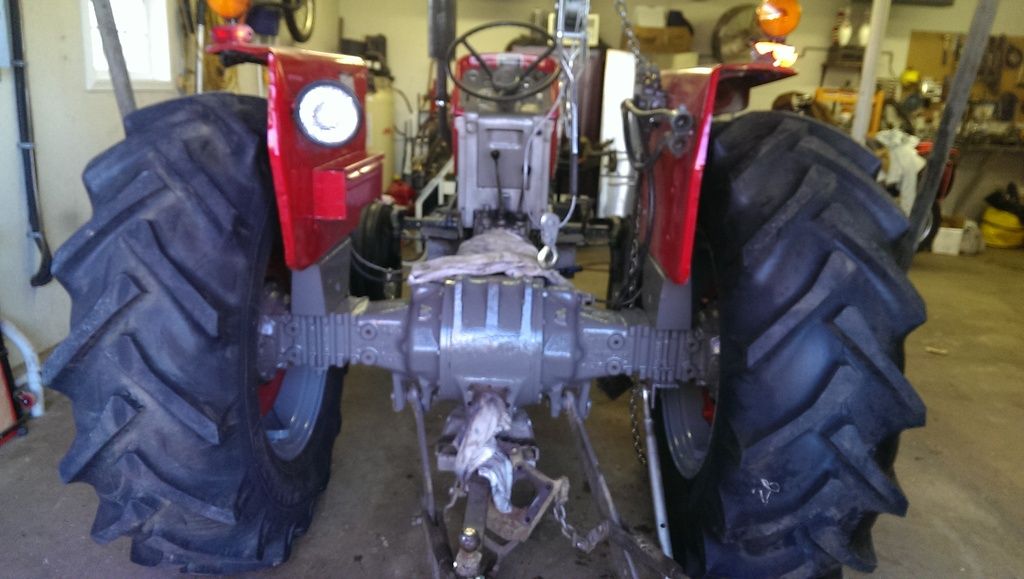

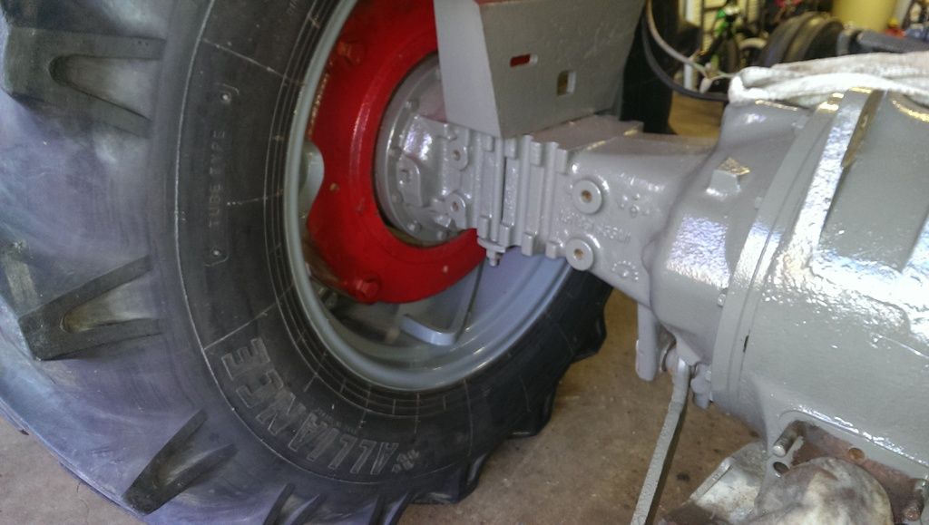

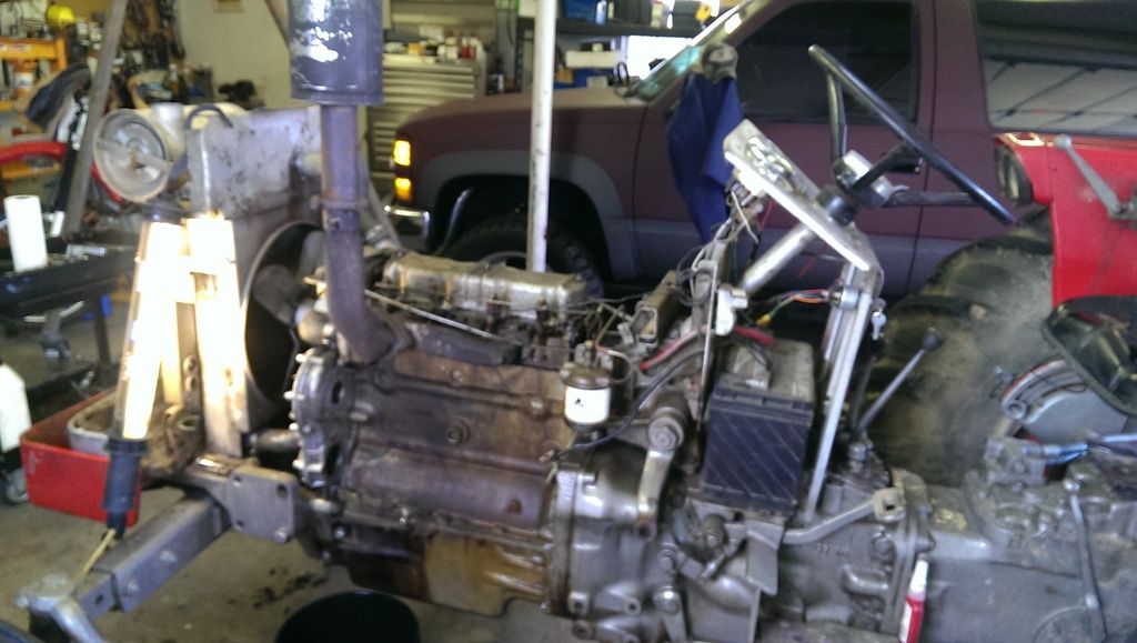

   / 1973 Massey Ferguson 165 Hydro lift issues
Couple pictures for you.
Doing some paint work while I am at it.
This rim was in pretty bad shape, had to weld up some rust.
Heavy axle
