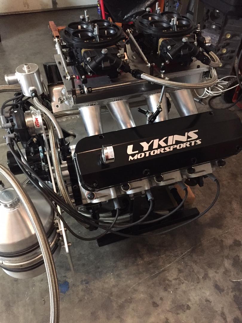

Is that naturally aspirated, single carb, cast aluminum intake and on gasoline... Or alcohol, charged, injected, sheet metal intake?

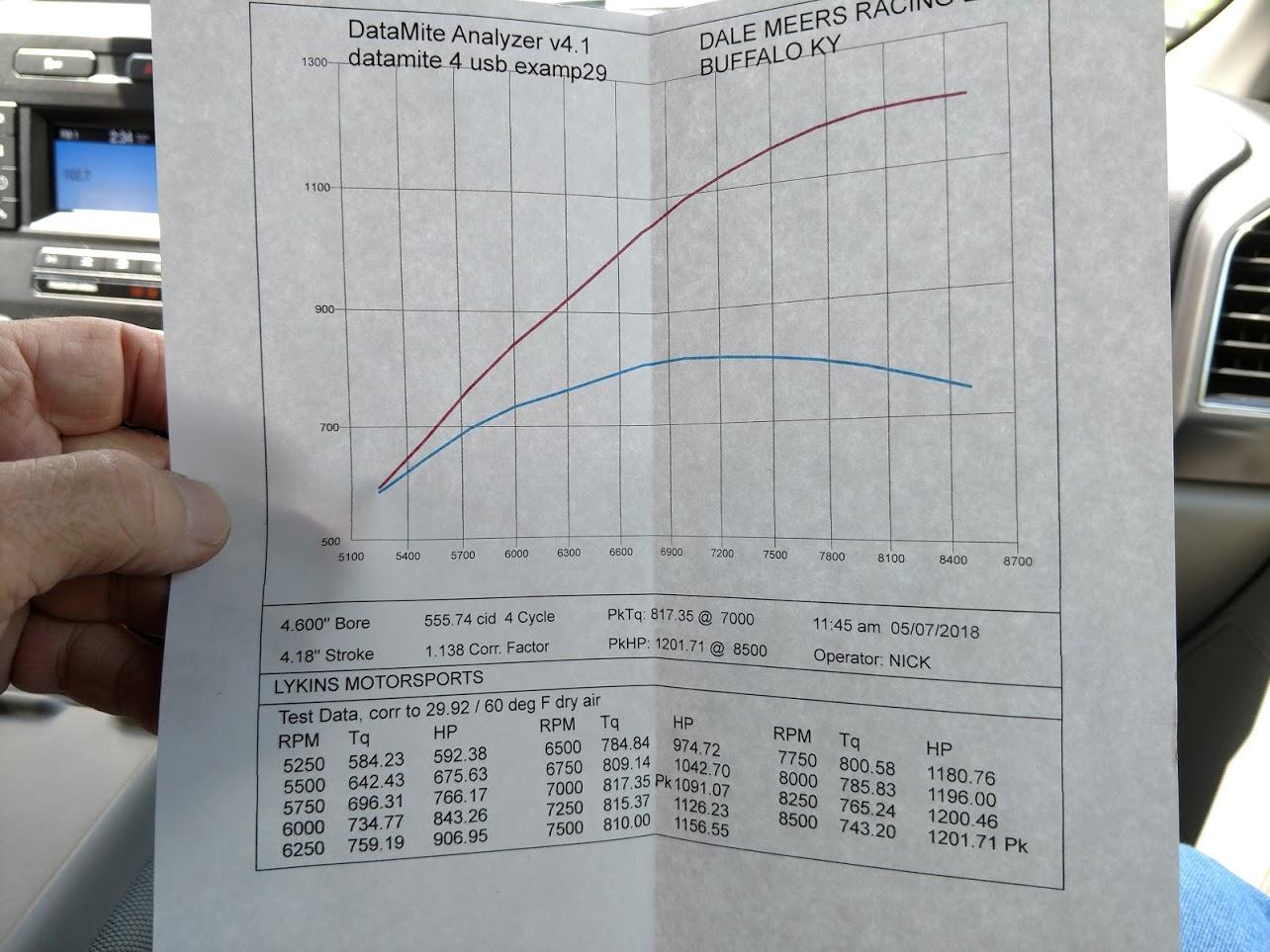

Since I am not pulling anymore I have lost track of the builds these guys run. It is the Pro Stock class, so 565 limit, N/A engines. Most are running sheet metal intakes with 2 carbs, dry sumps on gas. The blue GM won the class but I don't know how many trucks were in the class. There were 84 hooks total. I will know more when United Pullers posts the info.
Dyno sheet and picture of my brothers 556 BBF.

I’d like to see someone put that ^^ in a MK5 cobra.
