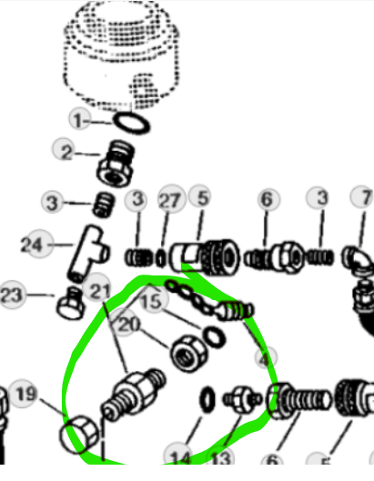

I have the above listed tractor with a FEL, and would like to add a rear remote to it. Currently, the FEL's hydraulic hoses are connected to the tractor like this:
My question is, after purchasing a kit (valve, coupler, etc), how does it all connect up so I could have both my FEL and the new remote connected and working together? Are tee fittings applicable here, and I can just hook up to the existing in/out along with the FEL?
Any help is appreciated. Thanks in advance.
   / 1978 JD 2130, adding rear remote #2
You can connect scv pressure line with a "special tee" similar to photo below. Parts item 21 from JD is part # AW16707 @ $48.50 & item 13 is C19280 @ $24.91. It's probable that these same type parts are available from a good hyd fitting supply business.

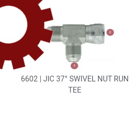

When I added a loader to my JD 2030 I bought the super expensive "tee" from my local JD dealer. A simple JIC 08 (1/2") run tee would have worked.
Current price is listed as $5.67 plus shipping
