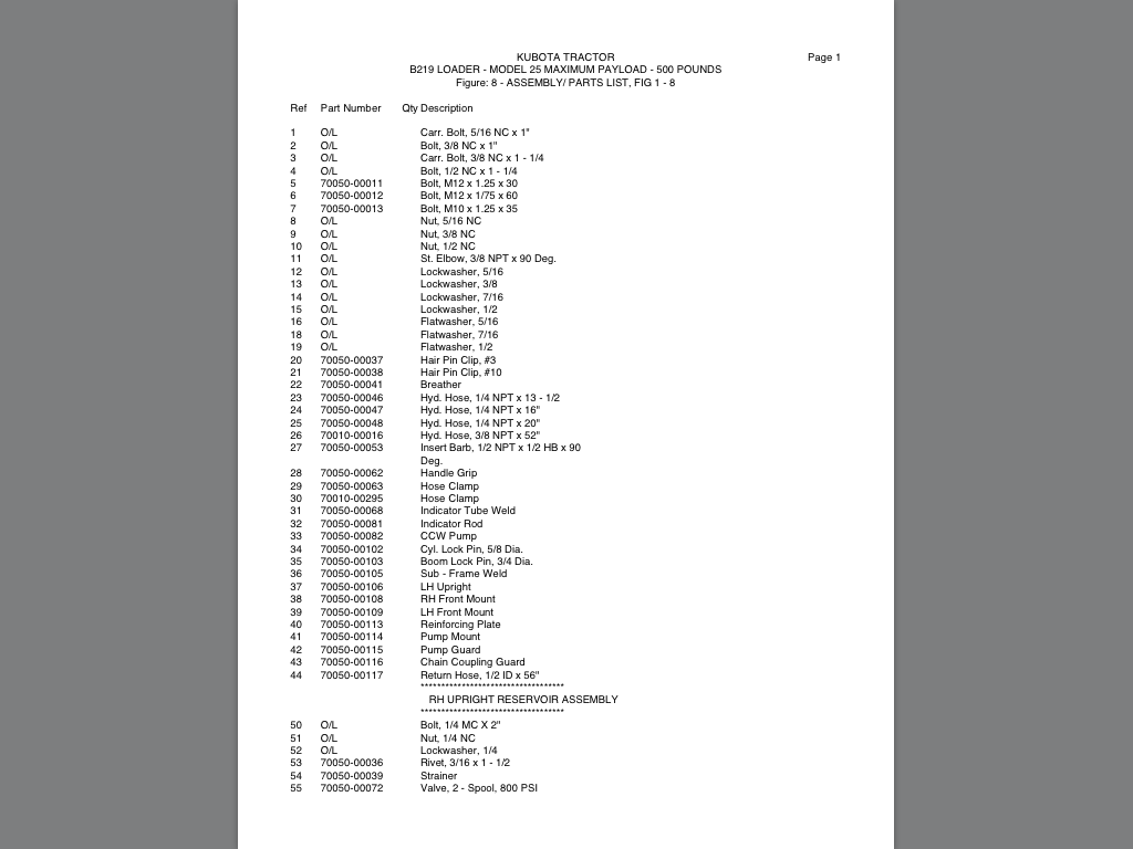

I am trying to find a replacement part for the control valve operating my B219 loader on my gear driven 4wd 1978 Kubota B7100. The detent cap for the bucket float valve has sheard off and a section remains in the body that I have struggled to remove it appears to be seized. I have searched around the forum and have found several older articles talking about a replacement, however the links have yet to work. Can anyone spool me up on what type of controls I should be looking for and an exceptable replacement that would require minimal modifications? I am new to hydraulics and have heard terms slung around like open or closed control systems and honestly have no clue what I'm dealing with. I have completely removed the control valve in an attempt to persuade the cap to move with no avail, so I can provide any type of information that might be required to help out.

   / 1978 Kubota B7100 with B219 loader control valve
So after doing some more digging I think I have found what I am looking for, the old valve did have a float option, it is part number 70050-00072 I will attach the parts diagram for anyone else who might look for it in the future. I have managed to find out that it was replaced by part number 70050-00191 which has been discontinued sigh yea I know right but after further digging I have found a place with five in stock and am in the process of getting a quote, yea me. Here is the link if you need one as well. The valve is a 2 spool 800 psi valve.

Hi all - I am new here and have a Kubota B7100 with a B219 Front End Loader. I am looking to replace the Hydraulic Control Valve for the loader - I want to go to a joystick control. The manual shows it as Part #70050-00072 and the description is "Valve, 2-Spool, 800 PSI". It looks to have been replaced by part #70050-00191 after looking around online.

   / 1978 Kubota B7100 with B219 loader control valve #9
Thanks! I will say that the tractordata.com info is specific to the tractor hydraulics, and not the Front End Loader B219. At least that is what I think. That said, I left a message for my local Kubota dealer and he did call me back and was very helpful. He confirmed that the original valve for the loader (Part # 70050-00072 replaced by 70050-00191) was an "Open Center" valve and that it had a max flow of 7 GPM when new (but mentioned that was often overstated). I just wanted to post this here in case anyone else was looking for this type of information.
