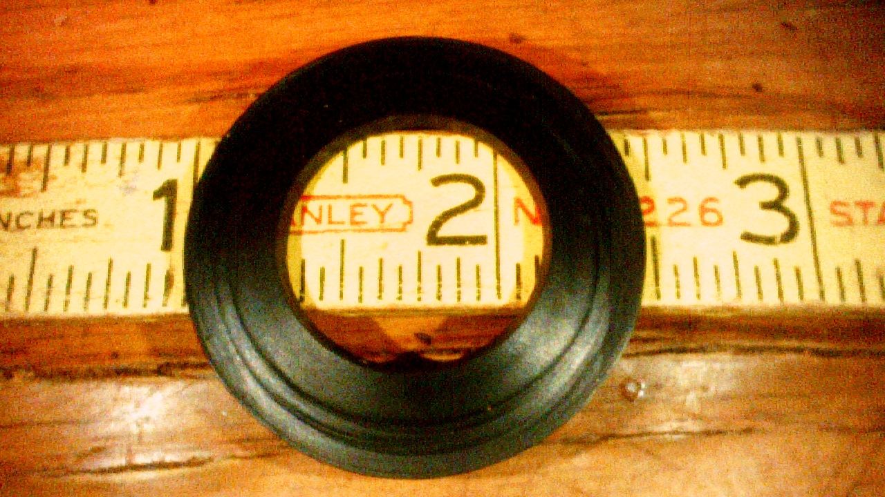

So after cleaning the cylinder head and intake manifold with my trusty mason jar paint sprayer filled with gas I find this
laying on the ground. Scratching head...
It had to come out of the head, either intake or water.
So I look at the Air Filter chain, nope.
So I look at the Radiator Cap, Yup, somehow between 1979-2009
a cap gasket went through the system and lodged in the head.
Maybe the spring and keeper are in there somewhere..
Fun stuff this :p
