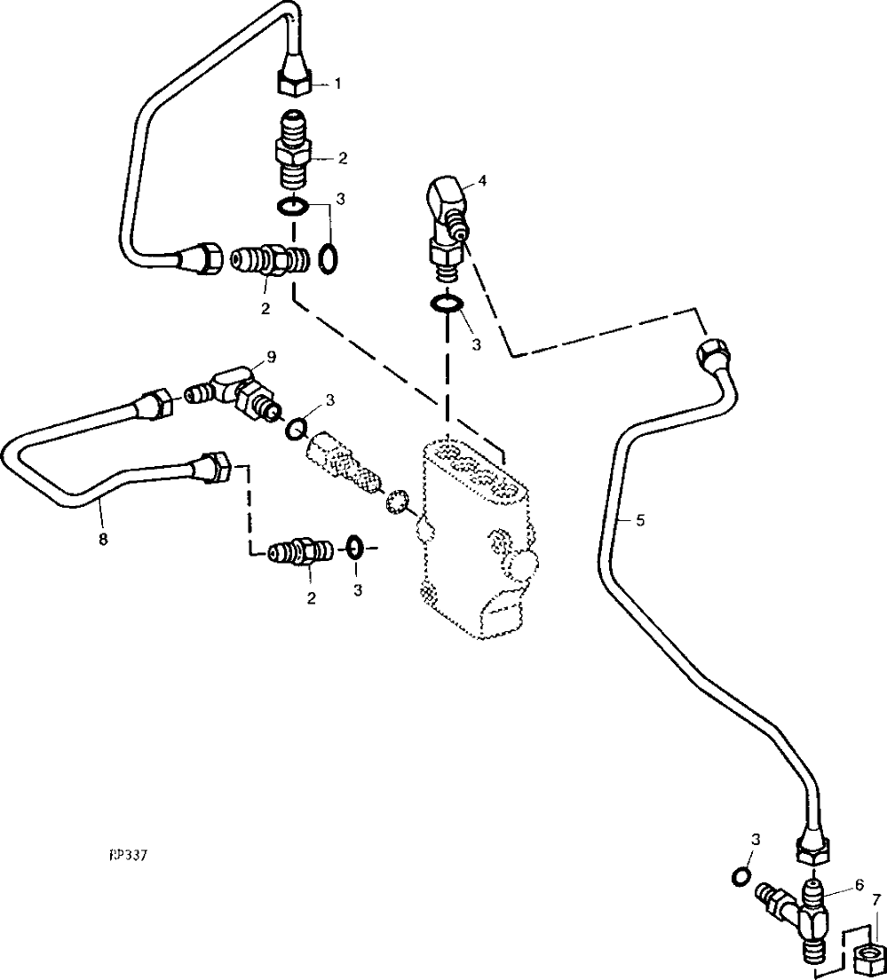

If the 3pt lever goes back to neutral, what is the purpose of the friction adjustments on the lever.
What kind of spring action do you have with friction disk?
Answer: The spring loaded friction disks are designed to hold 3 pt control lever in it's set position. Without spring loaded friction disk the control handle will vibrate from set location. Here's you an example of a spring loaded rockshaft(3 pt)friction controlled mechanism on one of JD all time leading best selling tractors(4020) Take notice of parts keys #35,39,40 & 41. Also notice adjustment screw(parts key #23) with lever stop(parts key #31) that is designed to return 3 pt control lever to same location so that 3 pt is returned to same operating depth after being raised. You are aware of the presence and operation of the feedback rod on some later model tractors aren't you????
   / 1980 John Deere 1050 75 fel Hyd issues q #32
J_J
Your own B9200HST has spring cup washers on the 3 pt control handle. Parts key #40 1st photo. Your tractor also has stops(parts keys #140 & 150) to limit how far forward the 3 pt control lever travel for a 3 pt hitch depth limit.
