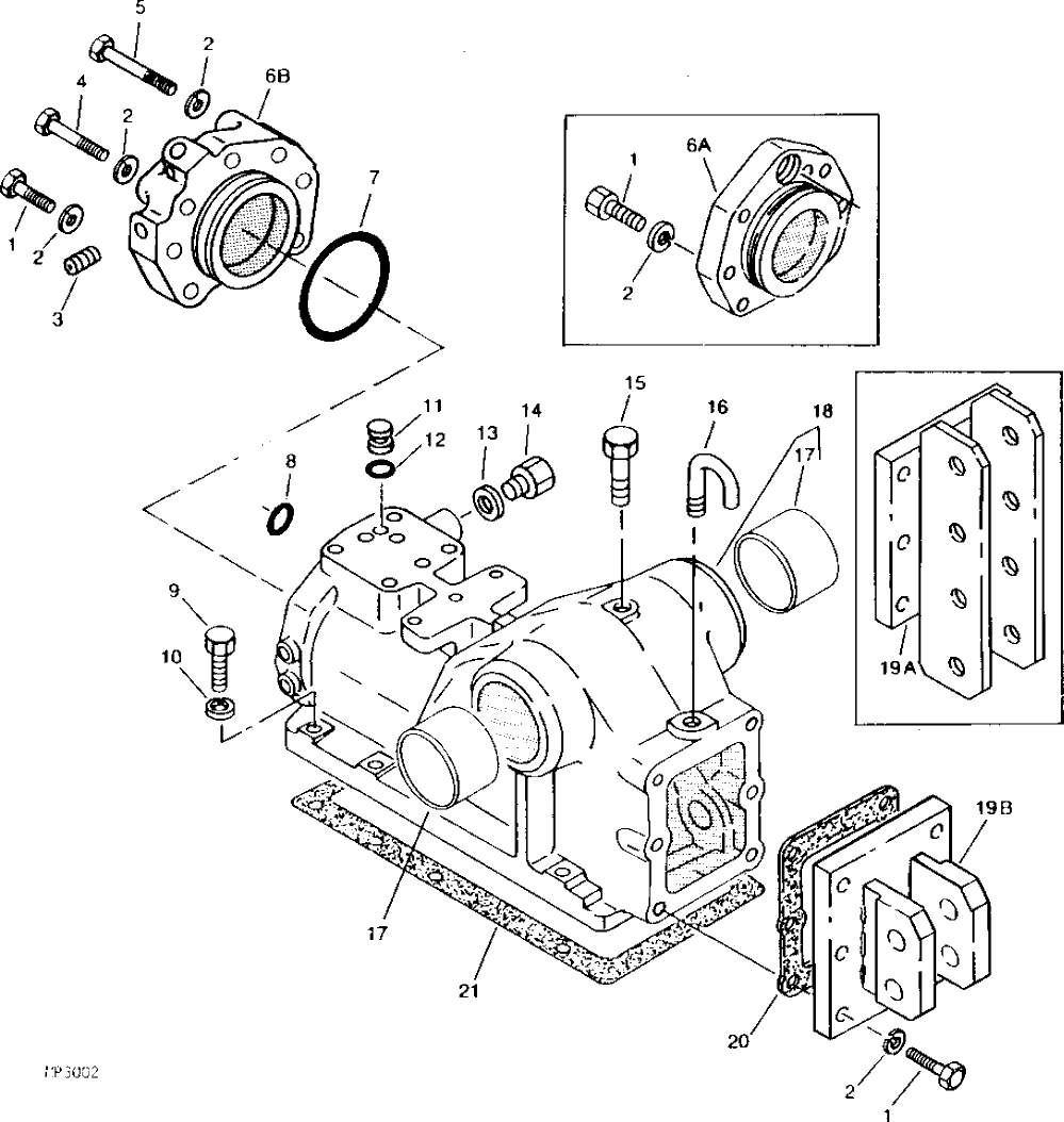

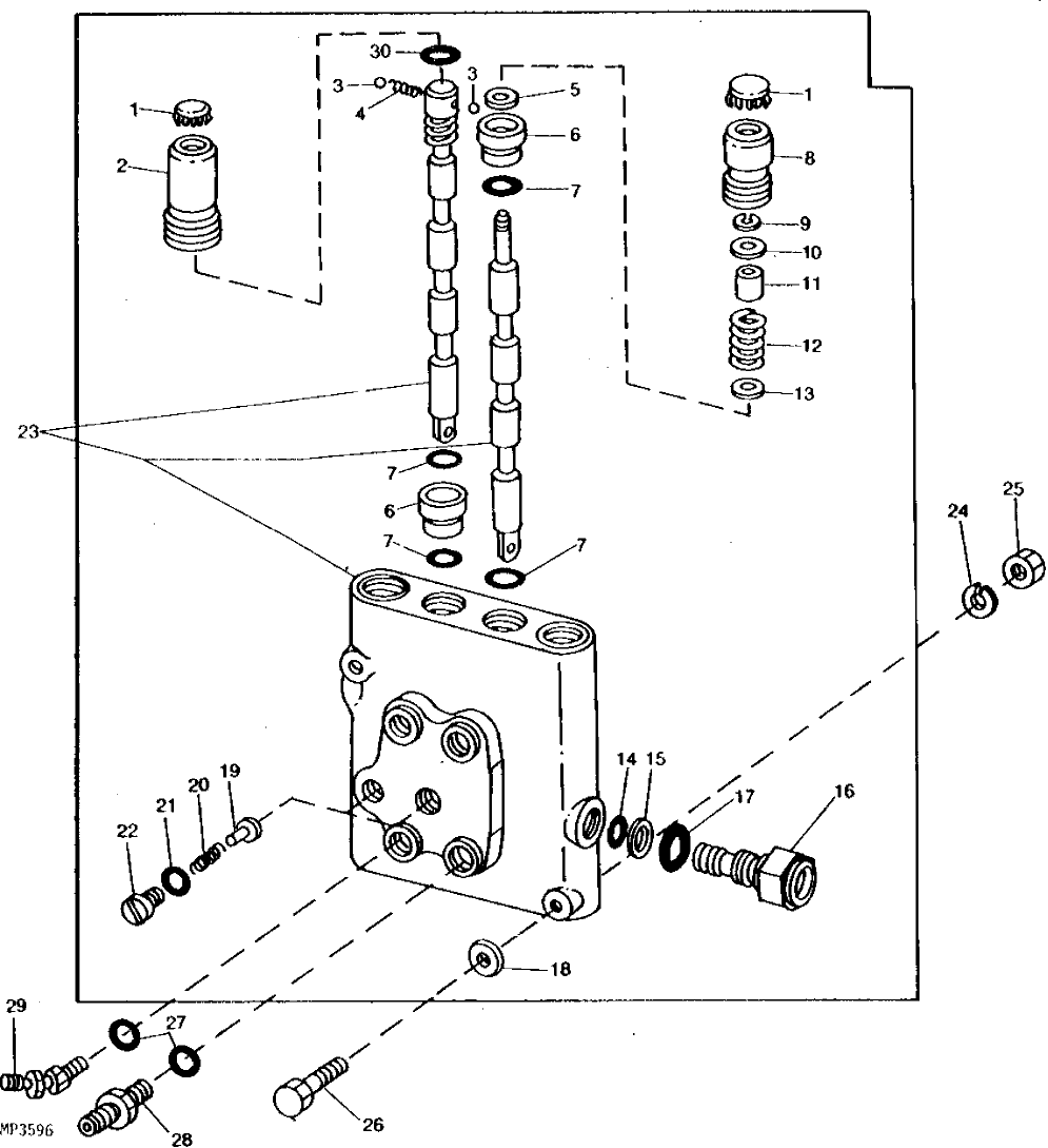

I just checked and there's no 2 spool hyd valve listed in the model 75 FEL parts catalog so is you loader controlled by tractor SCV's? I posted a 1050 tractor hyd line schematic for factory scv.
TX Jim in the loader kit parts does it show the 3/8" pipe plug? Also it sounds as if the feed back isn't set right.
   / 1980 John Deere 1050 75 fel Hyd issues q #12
What brand valve does your tractor have? Valve in photo is a Cessna. Also what's your tractors serial number?

TX Jim I'm talking about the 3/8 plug that goes in the rockshaft. I had the 950 and it had to be used in it.
   / 1980 John Deere 1050 75 fel Hyd issues q #15
Is parts key #14 the plug you're referring to?
   / 1980 John Deere 1050 75 fel Hyd issues q #16
No thats not it. The one I'm taking about went in the back under a plug to give it PB. I'm trying to remember just where you had to put it, it has been a long time ago.
