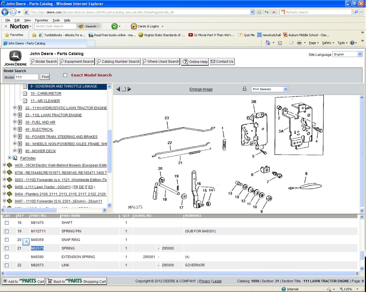

All, I'm new to the forum and am hoping I might find an answer to my question. I have a 1985 JD 111 with a Briggs engine, there is a very, very small long spring that is placed on the governor linkage, it has broke and I'm not sure why it is even needed. Attached is a picture from the JD website that shows the spring I'm referring to. The spring slides over the linkage. If someone knows more about this spring I would appreciate the education on it. Thanks in advance.

Maybe to keep it from throbbing? ??
Does the engine work ok without it?

I see, the engine doesn't work ok, and it is maybe worse after the carb kit.
Get a new spring from JD and when you get it, ask them to show you how it attaches. Then see how the engine runs.
