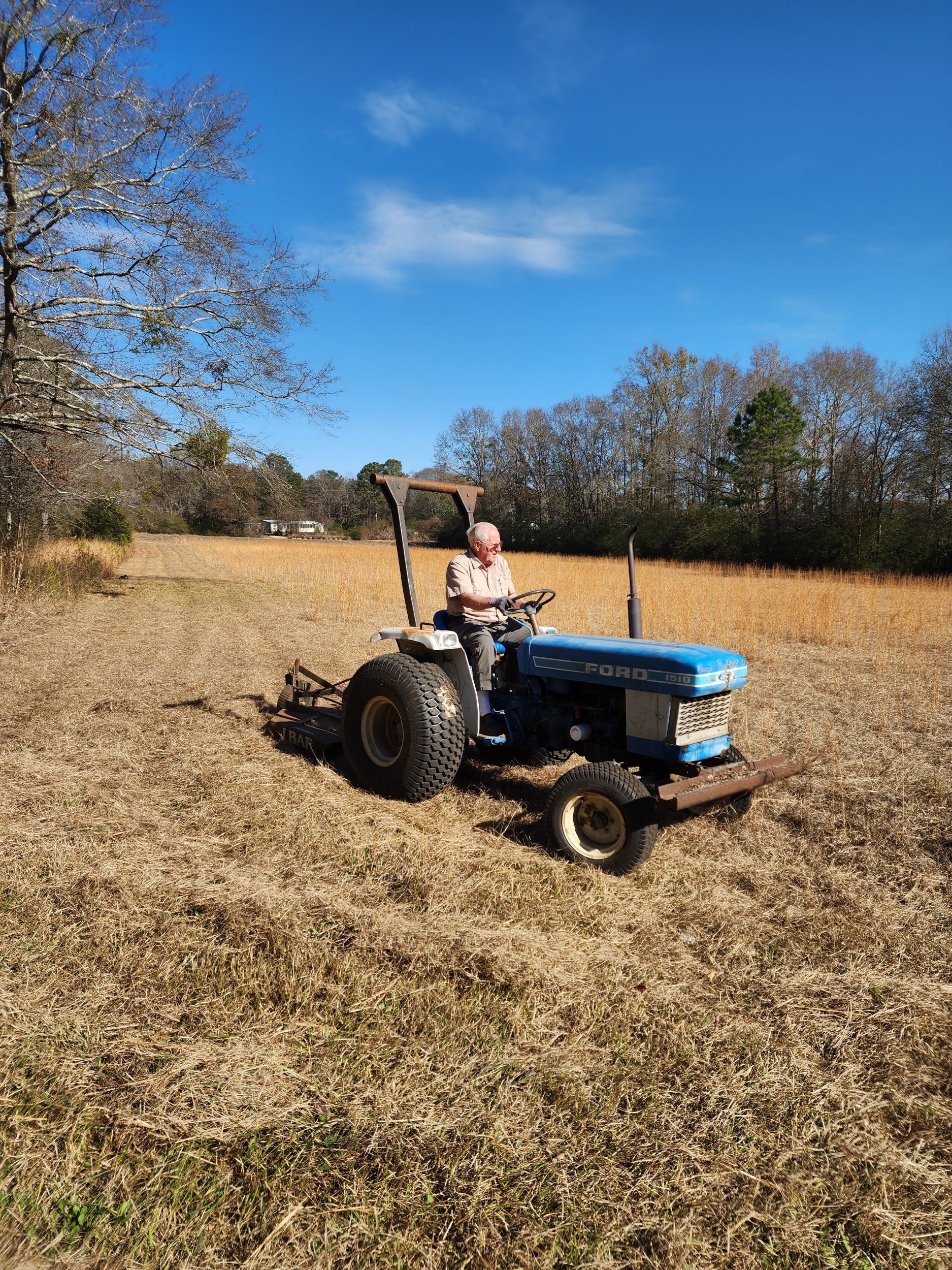

Put it to work today I let the screen get full once but we caught it before it ran hot. Once Dad got on it I didn't think he was gonna stop. :giggle:
