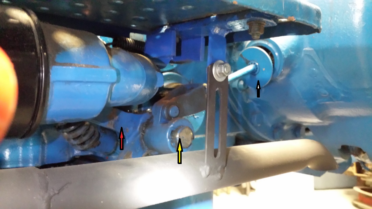

Yep that's what I'm talking about. There is also a rod that goes to the rear diff. It looks to me like that should move but it doesn't. I was just curious about what it did. Something to do with the PTO maybe (just guessing).
Thanks again for the help with the clutch. I'll keep an eye on it and make sure it stays properly adjusted.
Dave
   / 1990s Ford 3930 slow moving.. #15
Are you referring to the rod that's fastened to the cast arm on the end of the clutch pedal shaft under the floorboard?? This rod goes into the rear diff housing? That's the left brake rod.
Look at the attached picture. There are 3 arrows.
The red arrow is pointing at the clutch pedal assembly. My exhaust is in the way so you can't see the lower part of that assembly where the rod is fastened that runs forward where you adjusted earlier. This assembly coasts on the shaft which allows the clutch pedal to be moved with no impact on the position of the shaft.
The yellow arrow is pointing at the shaft that runs thru the tractor housing. If you look at the end of that shaft you can see the keyway that fastens the brake assembly to the shaft. This causes that assembly to move when the shaft rotates. This rotation is controlled and activated by pushing on the left brake pedal with your right foot.
The black arrow is pointing at the rod that goes rearward and into the rear diff housing. This rod activates the wet disc brake for the left wheel. When the brake pedal is pushed the shaft turns, which also turns the assembly on the shaft (yellow arrow), which also pulls on the rod (black arrow) to activate the brake.
Clear as mud right?? :)
