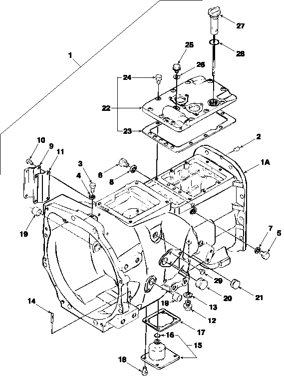

do u have a shuttle shift if not u wont have no filter. i really dont think the trans has a filter on the shuttle shift tractors either. because they have a manual shuttle. just on the tractors to has dual power
   / 1992 Ford 3930 shifting problems
#12
No, no shuttle shift. It's just the basic 8x8. Nothing special on this one.
   / 1992 Ford 3930 shifting problems #13
It's there. They have a lube pump.
   / 1992 Ford 3930 shifting problems #14
It's #15
#15
I called my NH dealer today and told them I wanted to come get that filter you mentioned. They told me that they didn't know what I was talking about. I could'nt explain it any better than what you told me, but I know now from that diagram and with said, I will be there Monday to retrieve it :thumbsup:
   / 1992 Ford 3930 shifting problems #16
i know i have bought and sold many of them and also have worked on them and never seen a filter in anyone i had
   / 1992 Ford 3930 shifting problems #17
I believe there is also a transmission cooler on this model. If so, you might want to disconnect one of the cooler tubes, start the engine, and check for oil flow. There has been instances of pump failures on early models.
   / 1992 Ford 3930 shifting problems #18
Benny, has there been any update? Have you tried the filter? Checking for a stuck clutch? Any thing help at all?
Thanks.
   / 1992 Ford 3930 shifting problems #19
Any chance the pilot bushing is dry and turning the trans input shaft?
Or did you find out what was wrong?
Jim
   / 1992 Ford 3930 shifting problems #20
well Benny -I just got on this site--so i'm late with the fix -but this is what you do--
You know that big peddle on the left--the one you push down to disengage the clutch?? find it? ok look on the left side of your tractor -down around the clutch area- see the lever there?? find it? thats the cluch lever. ok got it-- now look for the rod that connects the two--- find it?? see the nuts and treads on each end by the clevises? ok now for the BIG FIX-- 1 unpin a clevis--you pick which one--2 loosen the nut and turn the clevis till you shorten the rod a little ---3 tighten the nut and hook it back up--ok --got it--4 now start your 3930 and drive around and shift the gears -- ok got it?
