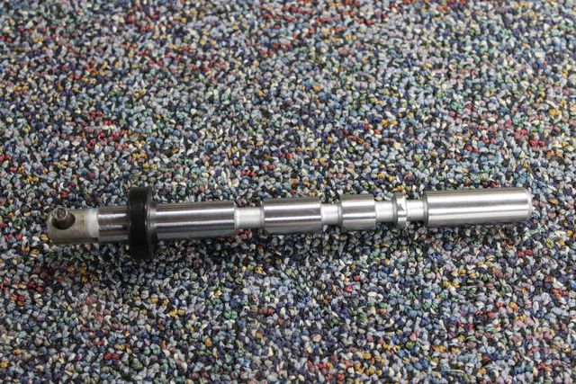

I can't seem to get on eParts this morning from home to see if there is stock of SBA340293452 in New Holland's parts system that any New Holland dealer could order.
But WILLIAMS FARM MACHINERY INC in Charlotte, MI has two, according to the dealer parts locator. 517-543-4770 is the phone number.
I have no connection whatsoever with Williams Farm Machinery.
After reviewing this thread (again) it looks like I am giving you the same info that you have gotten elsewhere regarding the availability of the non-regen spool.
   / 1995-1715 Ford Hydro Problems with 716B Snowblower
#12
Thanks for the help. I AM going to take a pic of the spool I have now and send it to WILLIAMS FARM MACHINERY INC. In the mean time I have asked Blue Tractor Parts to take back the spool.
Thanks again, I hope this all comes together soon, even though our winter has been mild I know there is one BIG snow storm coming before spring.
#13
I got pics from Williams Farm Machinery...........they look just like mine! Mine is the one with thw spring on it.
What am I doing wrong??!!??
