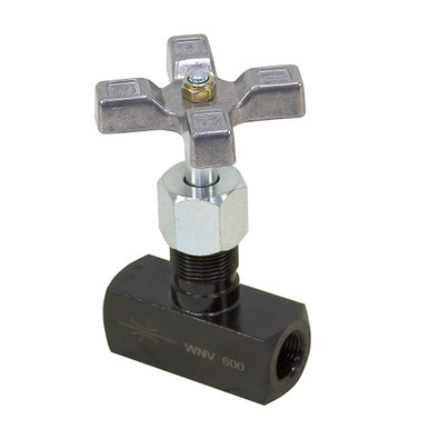

My loader is a LA450A model and the Lift Lower control is VERY touchy. It has always been this way. If you want to lift or lower the bucket gently it is very difficult to do so. I find it way to touchy too sensitive, Is there a way to adjust the sensitivity of the movement? I do not run Kubota UDT oil I use Tractor Supply Transmission grade hydraulic oil. I have had UDT in the tractor back when I first got it in 2008 or so but that did not make any difference.
/ 1995 KUBOTA L2950 LOADER QUESTION #2
The LA482 loader on my L3010 is like that. A idle it is easy to operate heavy handed but at higher RPMs anything more than a very light touch is to fast. The hardest thing for me is after putting around at near idle for a while and then doing something that requires higher RPM is getting back to the light touch. I often get a rude reminder the first lift or drop. I have considered putting flow restrictors in the lines to the lift cylinders, which would help you, but so far have not - it's been 25 years so probably won't.

Sounds like flow restrictors are what you need then

I suspect that the FEL control valves on those machines are just cheaply made, lacking small ramps on the lands of the spools.
My neighbor got a new Branson 2610H 3y ago and the FEL boom control sensitivity is terrible.
Flow restrictors may indeed be the only economical fix. My old JD 4300 loaders came with boom restrictors from the dealer.
