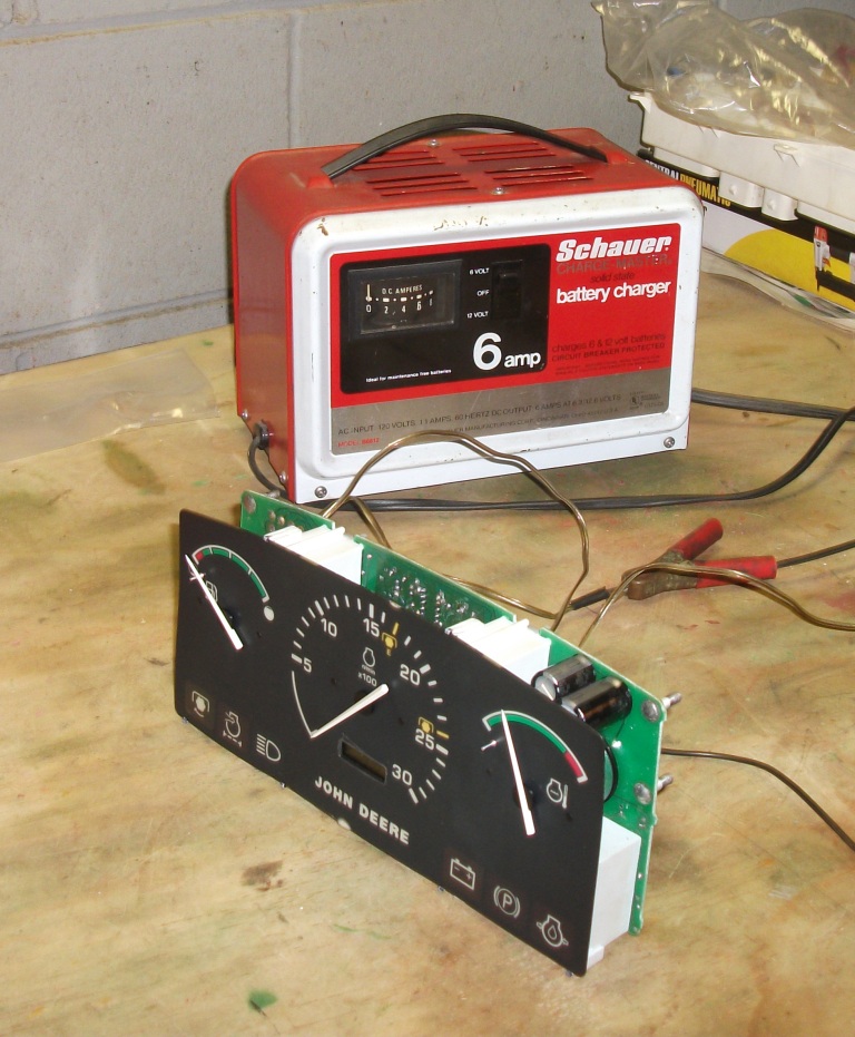

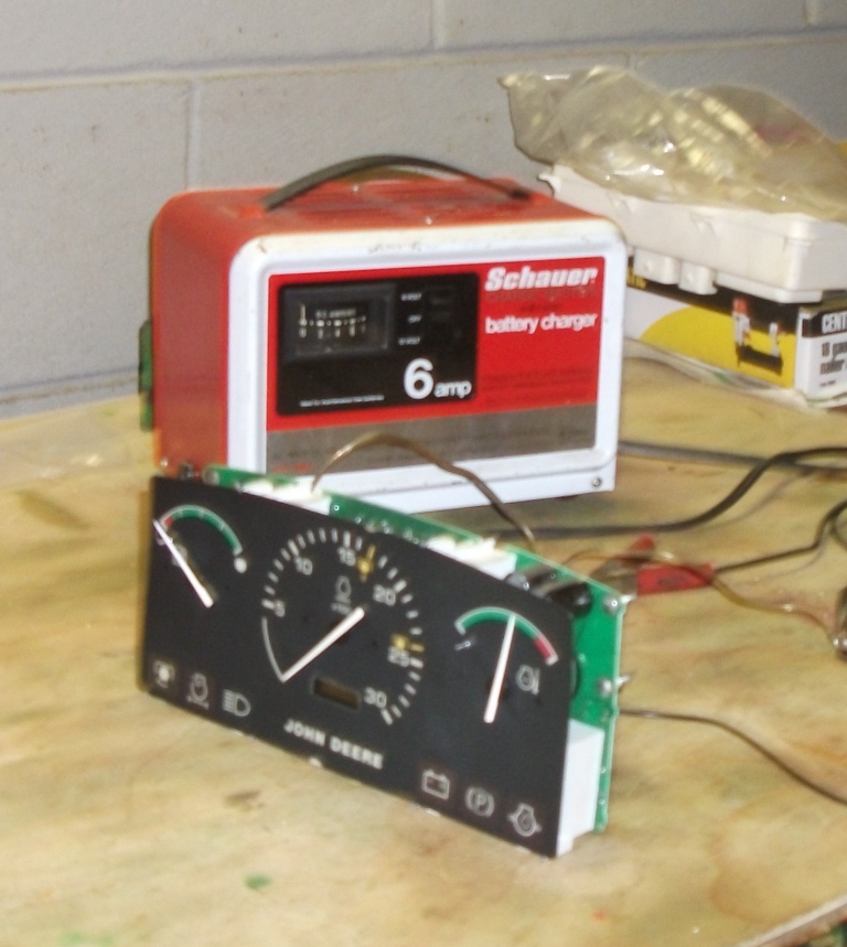

Not suggesting you do this, but here is some pictures of my old cluster. I am using my battery charger as power source and a resistor as the temp. sender. In picture 1 the resister is a 100 ohms and in picture 2 the resister is 50 ohms.
