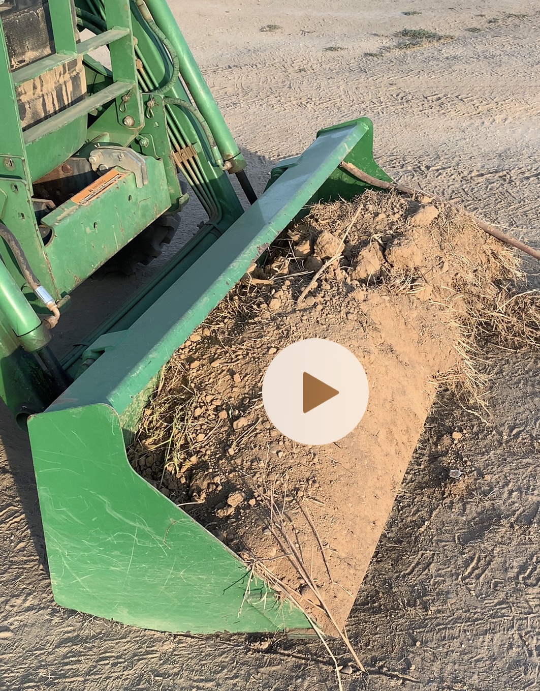

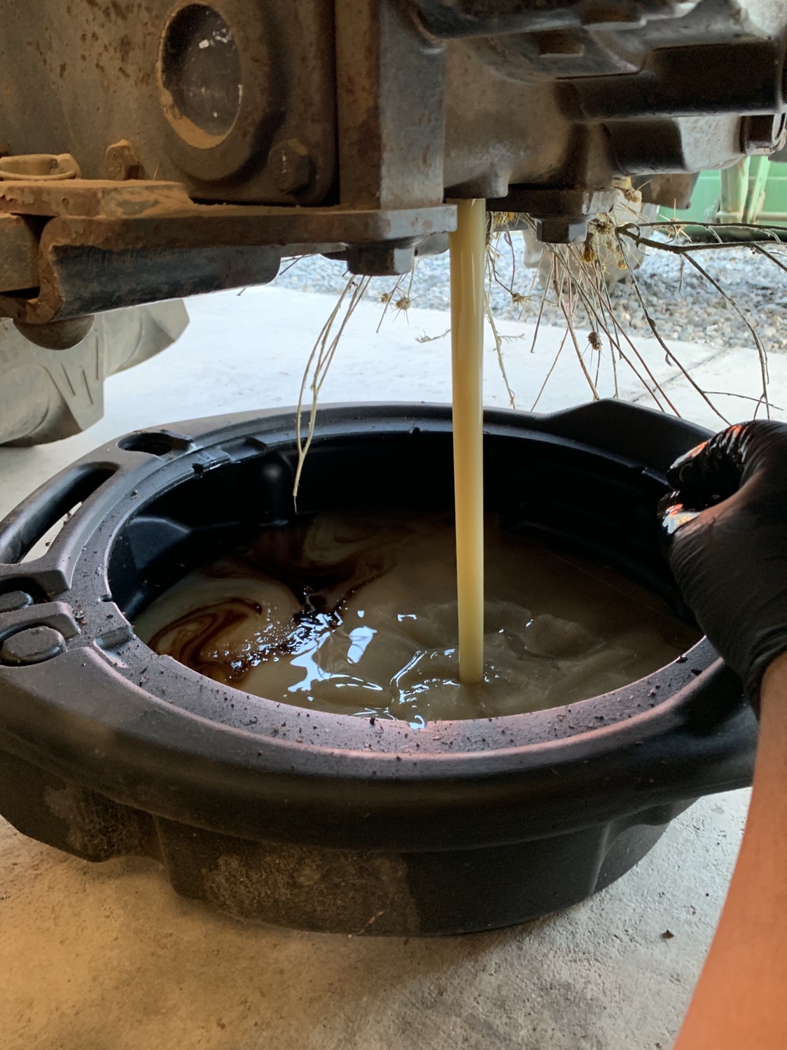

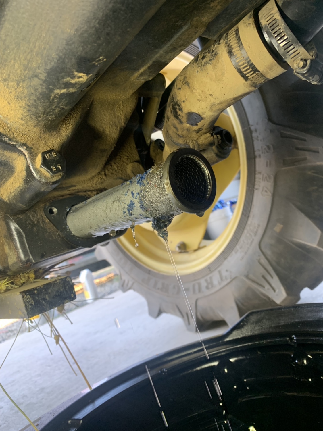

Update, I replaced hydraulic fluid, filter and cleaned the screen underneath which was covered in gunk. Also did an engine oil change and filter for peace of mine and replaced the seals on the cylinder. The dog gone thing still doesn稚 pick up a small dirt load. I知 confused. Any other things I can try?? It also drops about 3 a minute when the bucket is up high. View attachment 614678View attachment 614679
Is it the FEL bucket (Curl) dropping while sitting? - that would likely be a leaking (U) seal(s) in the curl cylinders. When the FEL control is centered the relief valve is not in circuit.
BUT- oil can bypass bad seals and fill in behind the piston as the rod extends
If it is the lift cylinders that are moving when parked, That sounds like the control valve is leaking, since even with bad U seals the rod (should) not compress into the cylinder because fluids do not compress.
3 inches a minute is a pretty good leak somewhere

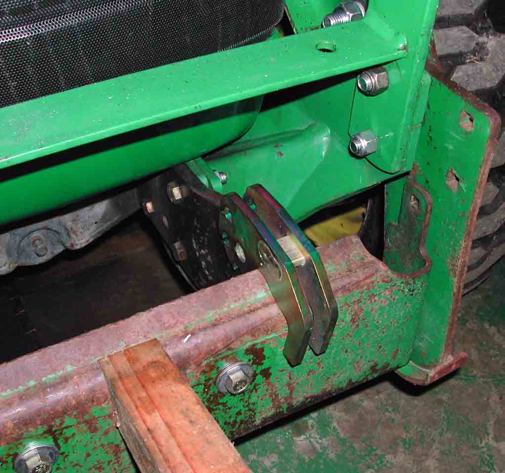

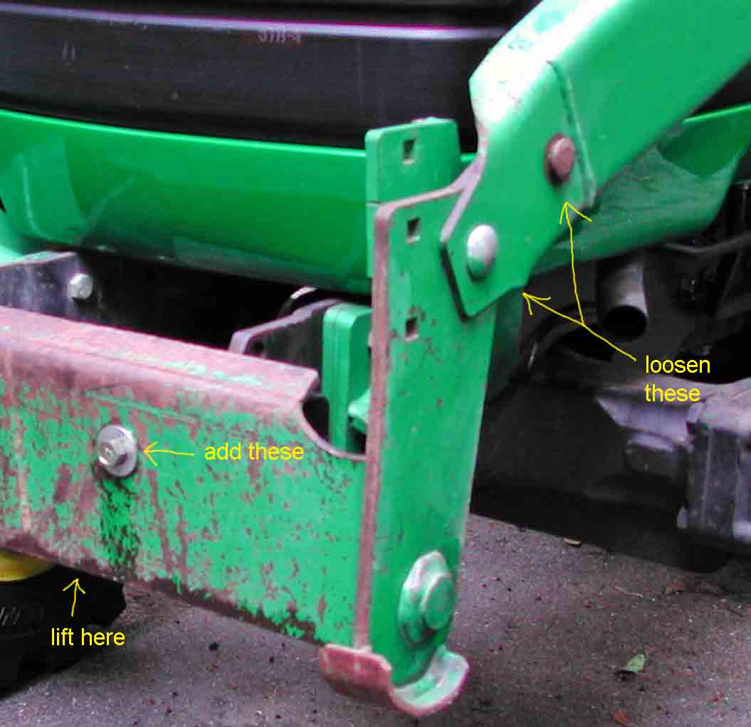

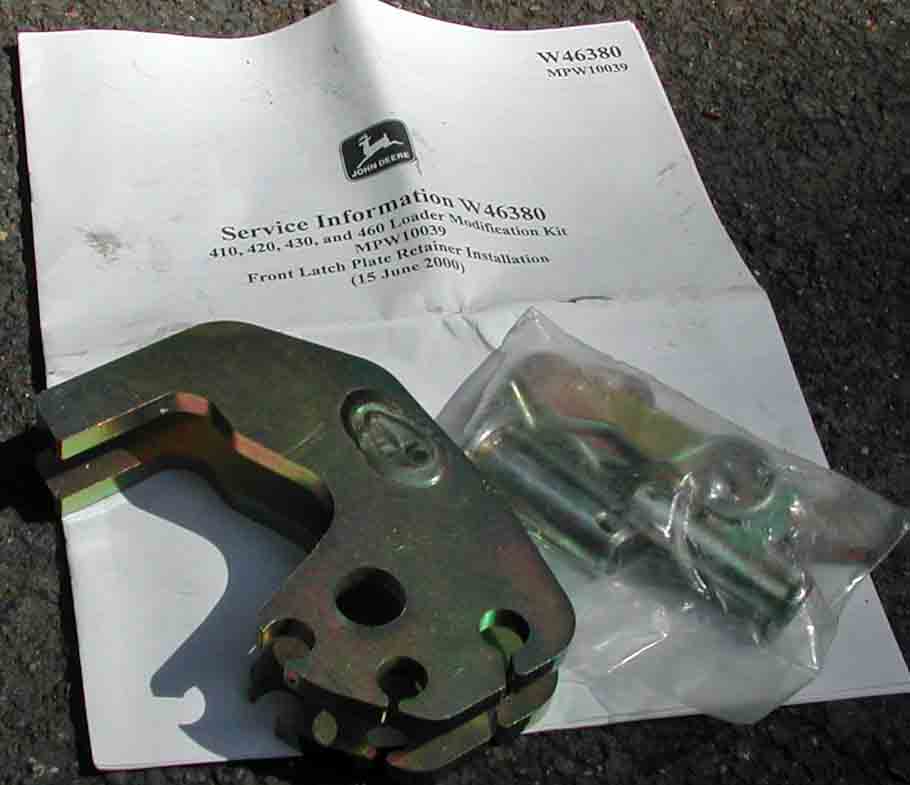

and can you show me exactly what your talking about when you talk about the FEL mount? not sure exactly how its suppose to look like.
The front plate hinges downward when you mount/dismount the FEL. A retrofit latch came out in 2000 because they were coming loose at inappropriate times, apparently. Did yours come loose?

It does have that hinge on my tractor. Does it not look right ?? and oh what are you going to auction off?
   / 1998 John Deere 4300 with 420 Loader problems help!! #18
Out of the first four pictures you posted there is a closeup of this assembly in the third picture. The safety that John Deere provided is not readily visible and if you look closely at the left side of the picture the hinge that holds the loader onto the tractor looks like it's about to slip off. Obviously with the safety on it can't but I missed that when I first looked at the picture. In the above picture everything looks fine.
   / 1998 John Deere 4300 with 420 Loader problems help!! #19
It looks OK in the photo. Your earlier one did not look quite like that.
The bandaid "latch" is not necessary if you put a bolt or 2 thru the holes. I think the idea was to avoid wrenches when you mount/dismount the FEL.
