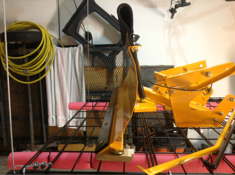

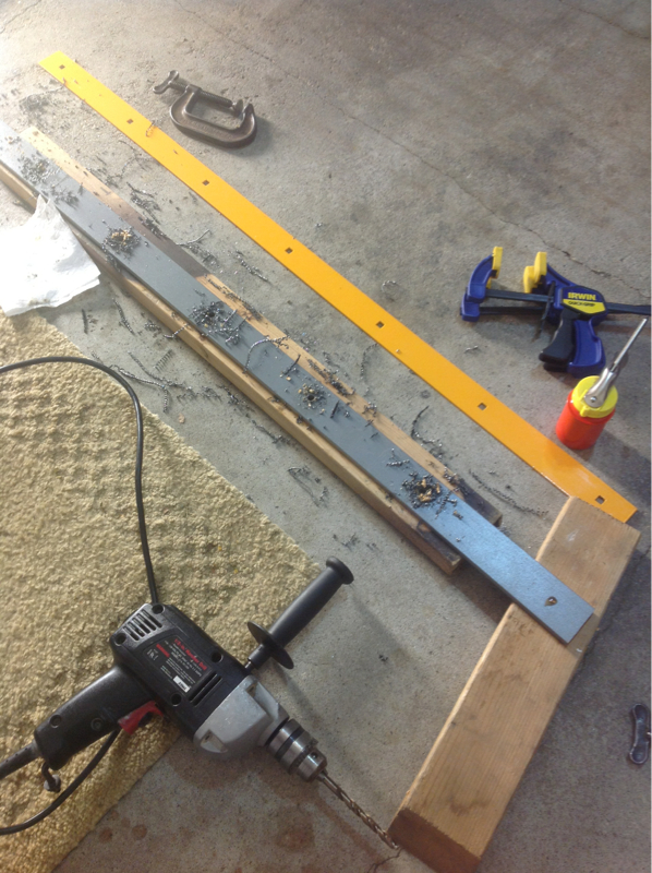

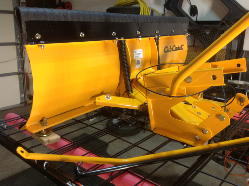

I have completed the modifications to my snow/dirt blade I purchased for use on my 2011 Cub Cadet GT2100 garden tractor. The blade in its stock form was ok but I noticed a few things that needed upgrades & modifications for my intended use. I had a prior post about the loose blade angle catch mechanism which helped but I have posted photos of my other mods here. First I had to replace the thin wear or scraper bar, the factory bar was only 12 or 10 gauge metal, I usually plow 5 driveways, our circle and part of the street, all 30+ year old uneven and cracked concrete, I would wear through or bend that stock wear bar up in one snow storm! Plus, I will use it for grading dirt so I found a piece of 3/8" x 2" bar stock and cut it to length, then I used the factory bar as a template and drilled the holes using a carbide bit and cutting oil, it took a while using my 1/2" hand drill but I eventually got it done (see photo). After I had it drilled I ground off the rough edges & painted it black, then I purchased 7 stainless steel cap screws and locking nuts and attached it to the blade, the holes even lined up! The next issue was the moldboard height, from the factory it is only 14" heigh (see photo) well I know from past experience pushing only a few inches of snow can quickly pile up higher than that when clearing large areas, my old John Deere 210 blade had an 18" mold board and I had snow over the top of that before so 14" wouldn't cut it. I started with a 4" heigh piece of metal from an old storage rack shelf, cut it to length (46"), made notches where the trip spring bolts are on the top of the blade & drilled out 5 holes to attach it to the top of the blade. I intended to use this piece to mount a rubber snow deflector to so I mocked it up and used the factory wear bar to sandwich the rubber (an 8" high piece of old truck bed mat) to the 4" bracket, and again used the wear bar as a template for the backing bracket and rubber, drilled the holes. I ground off the edges of my backer bar & painted it black like the wear bar and after waiting several days for the paint to cure, I put the bar on top of the blade and attached the rubber. Well, it certainly was higher but the 8" tall rubber was really floppy so I loosened the bolts, bent the rubber over backwards and tucked it in behind the backer bar and tightened it back up. This would work well, it added 6" to the blade height and the rubber when folded over on itself was rigid enough to enable me to push and stack snow in piles. Now with a 20" heigh blade, loaded tires, 2 link tire chains and my 210lb @$$ on there I am ready for the snow to fly! Please take a look at the photos of the completed project & leave comments or questions.

Hey nice job on the blade! The truck bed mat was a great idea. I might do something similar with my blade

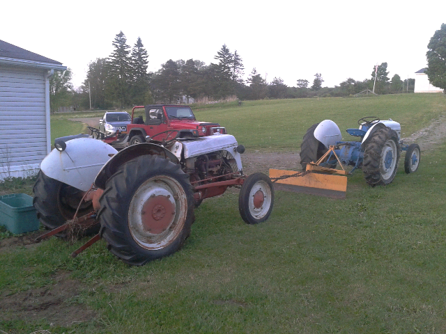

I have a cub 108 with the blade, Jacobsen gt14 with the snow blower and a ford 9n with a blade and chains. I'm still waiting for snow here and i'm in the snow belt by buffalo NY! Still not a flake on the ground here. Usually by now we have 2 feet!

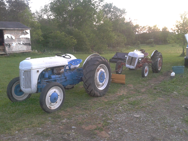

My cub is the 3 speed gear box, however I was lucky enough to get one with a underdrive on it! Man that thing can crawl! ill tell ya the new cubs aren't as tough as the old ones for sure, but man are they a smooth nice riding machine! I don't have to let any air from the tires when I put on chains, they have slack in them but I pull the slack out using clever placement of rubber tie down straps. Do you have to air down the tires? This is my first time uploading pics to this forum so here goes...

Weird said application crashed and added the photos anyway.. those are my two 9n's. Blue one runs and red one is the project.

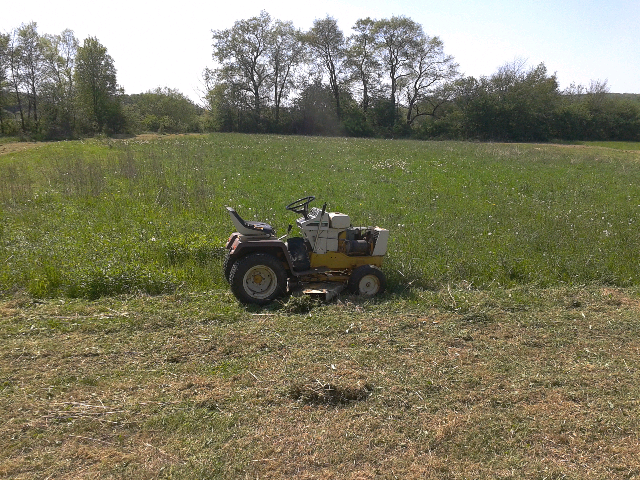

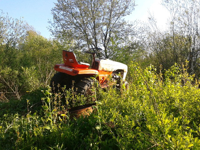

that cub mowed that two acre field with 2 or 3 ft deep grass. Unbelieveable.. then the jacobsen is just one I cruise down to the creek on behind my house.

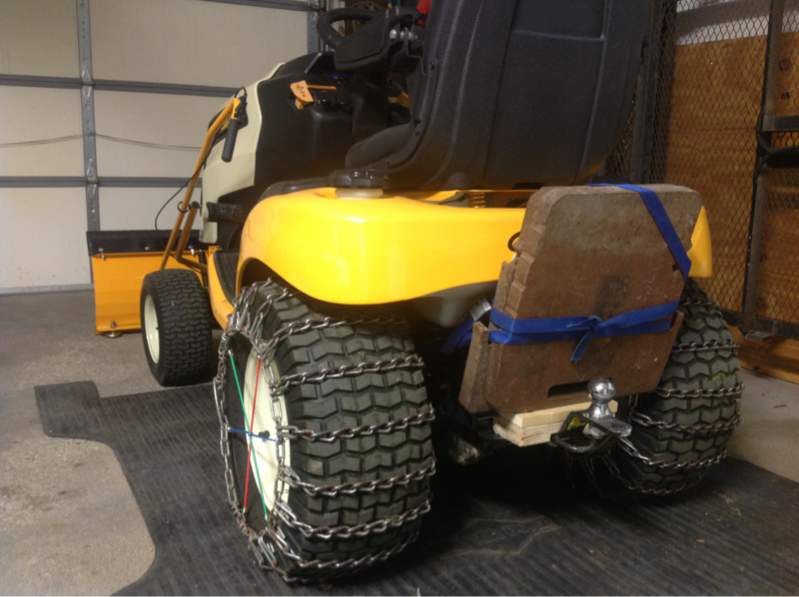

Here is a photo of the chains on and my "creative" way of attaching 2 old 100lb farm tractor suitcase weights, snow is in the forecast for Wed. I hope so!

I like the weights! How much is that about a hundred pounds? In my opinion airing down the tires won't do much for tractoin with the chains on due to the carcass of the tire is so stiff it won't alow contact between the chain rungs... I think your better off keeping the pressure high to keep the chains tight and preventing them from slipping on the tire. that's my theory anyway. Weatherman here is calling for snow squals and flurries this weekend apparently so I've got my fingers crossed!

The weights are about 100lbs each, there are 2, I also have the tires filled with RV antifreeze (60lbs/tire) so hopefully with that and my 210lb @$$ on there I will be good to go. One of the negative things about the new Cub garden tractors is the absence of a differential lock option, well see how it goes but my old 210 didn't have it & did fine. The weatherman is now saying Wednesday evening-night we will get 6" + with high winds for 2 or 3 days so sounds like I'll be able to give my setup a good workout!
