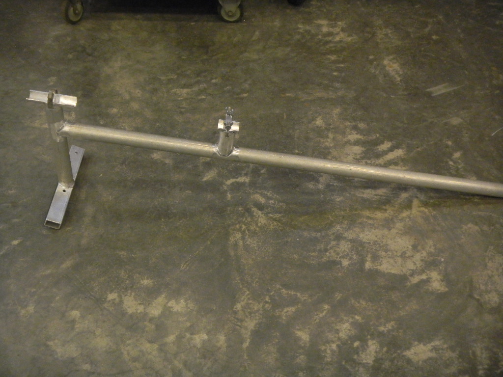

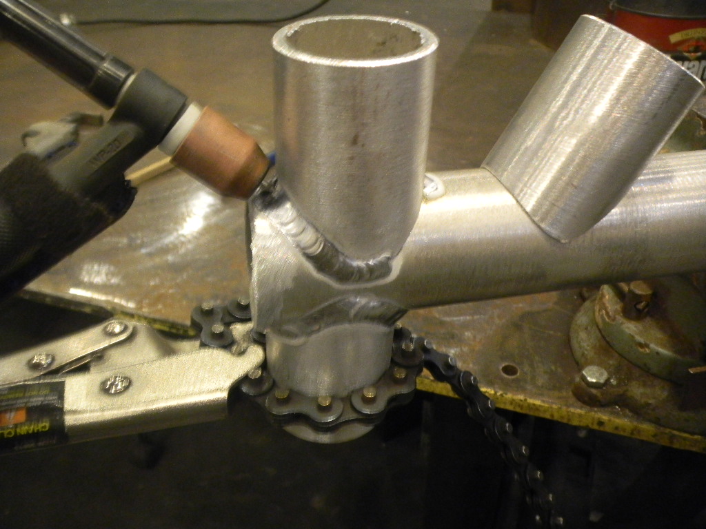

The other day I had to build a support arm, built it out of aluminum. Not as strong as I use to be for some reason:mad:. Used a 1 7/8-inch hole saw to cope the ends of the aluminum pipe. When I started to weld, man did I ever struggle! I made my way through the project, but was no where near satisfied with the quality of welding! Don't get me wrong, I've never been much of a Tig weldor, I'm more of one of those guys who pulls the trigger, running 350 to 400 + amps, splicing beams together.
Anyway I coped some more pipe, and did a little practicing. After burning my fingers a few more times I remembered I should be using a pipe wrench, or this chain vice grips, so I don't have to rest my hands on the hot base metal. Did make it a little more comfortable to weld, and didn't burn my hands!:laughing:

Good looking weld you put on that. You are correct about being comfortable. Any stick weld you make you should be sitting if you can, use two hands to weld with and have one elbow against something to help with the steadiness. With the tig rig you have the advantage of being able to walk the cup and that helps a lot, but you should always walk the cup around on a dry run first to make sure you are comfortable as you roll your wrist or move your arm position.
I have never had a steady hand but I made a lot of good quality and good looking welds by being comfortable. I always tell new people learning to weld that if they want to be good at it they should make every weld as good looking as they can and they will get better and better. Of course, now that I am older and lazier I don't follow that advice myself anymore :laughing:
