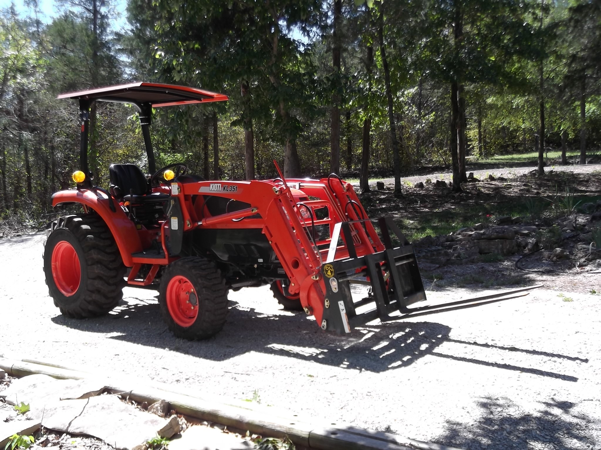

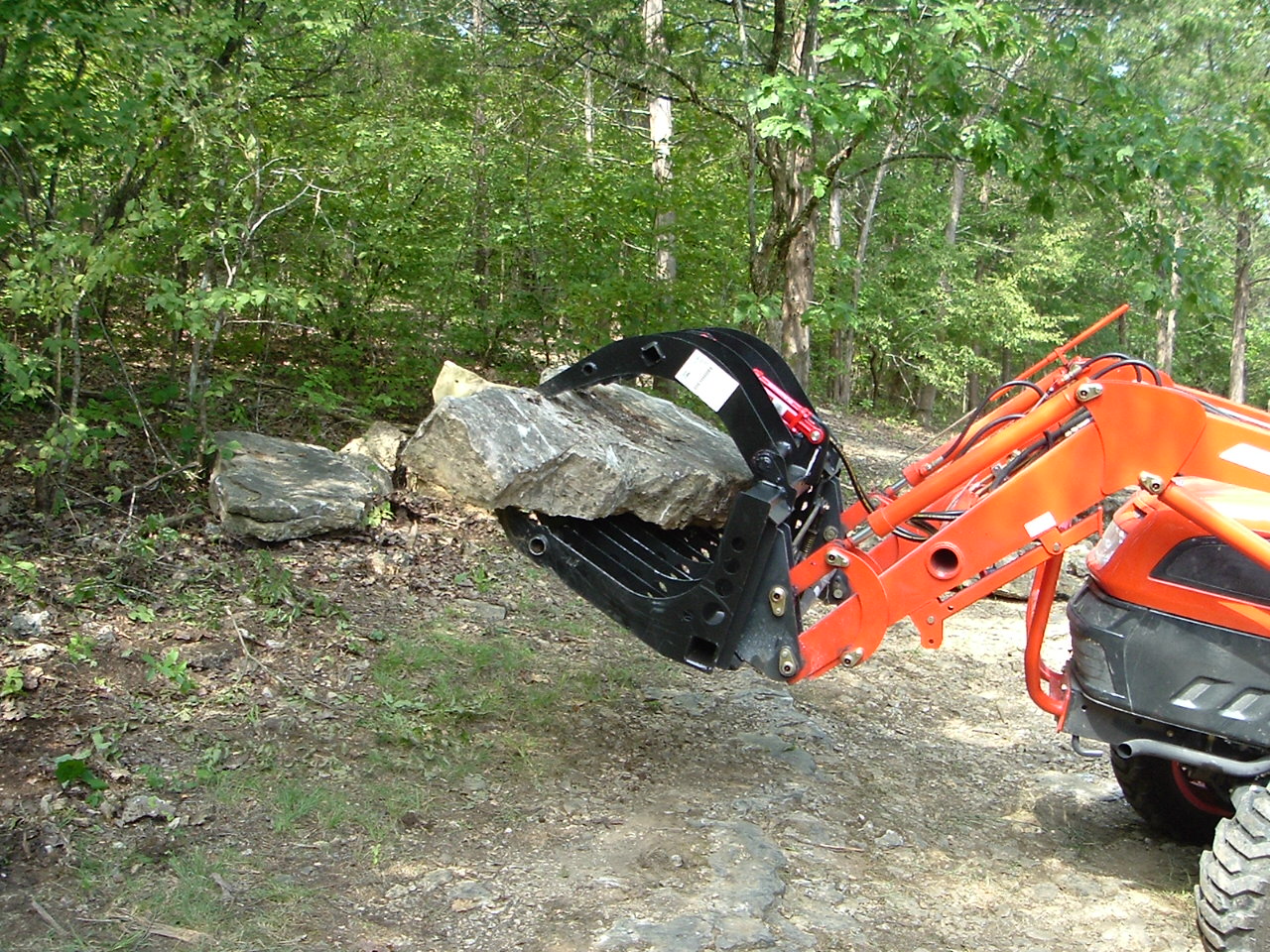

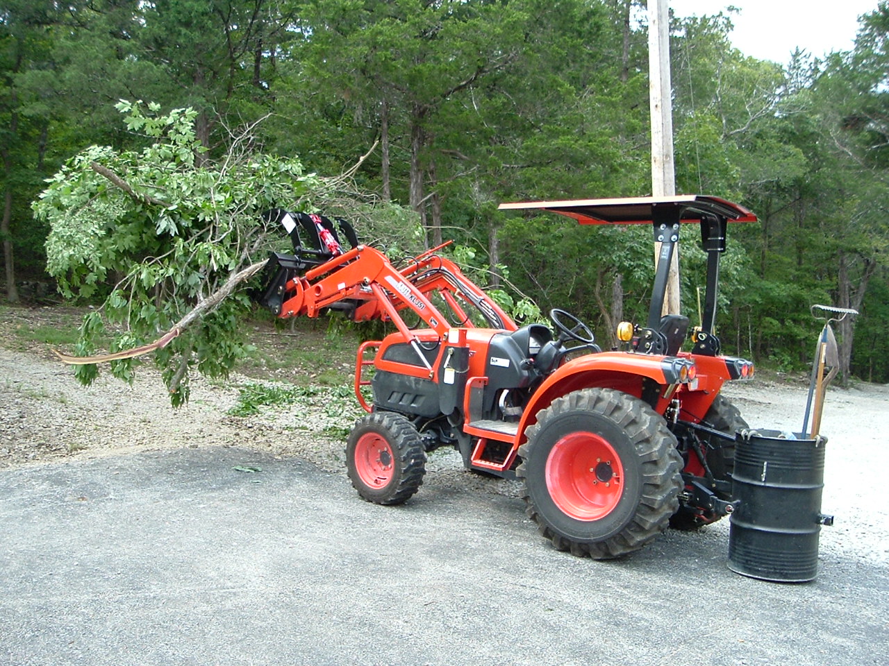

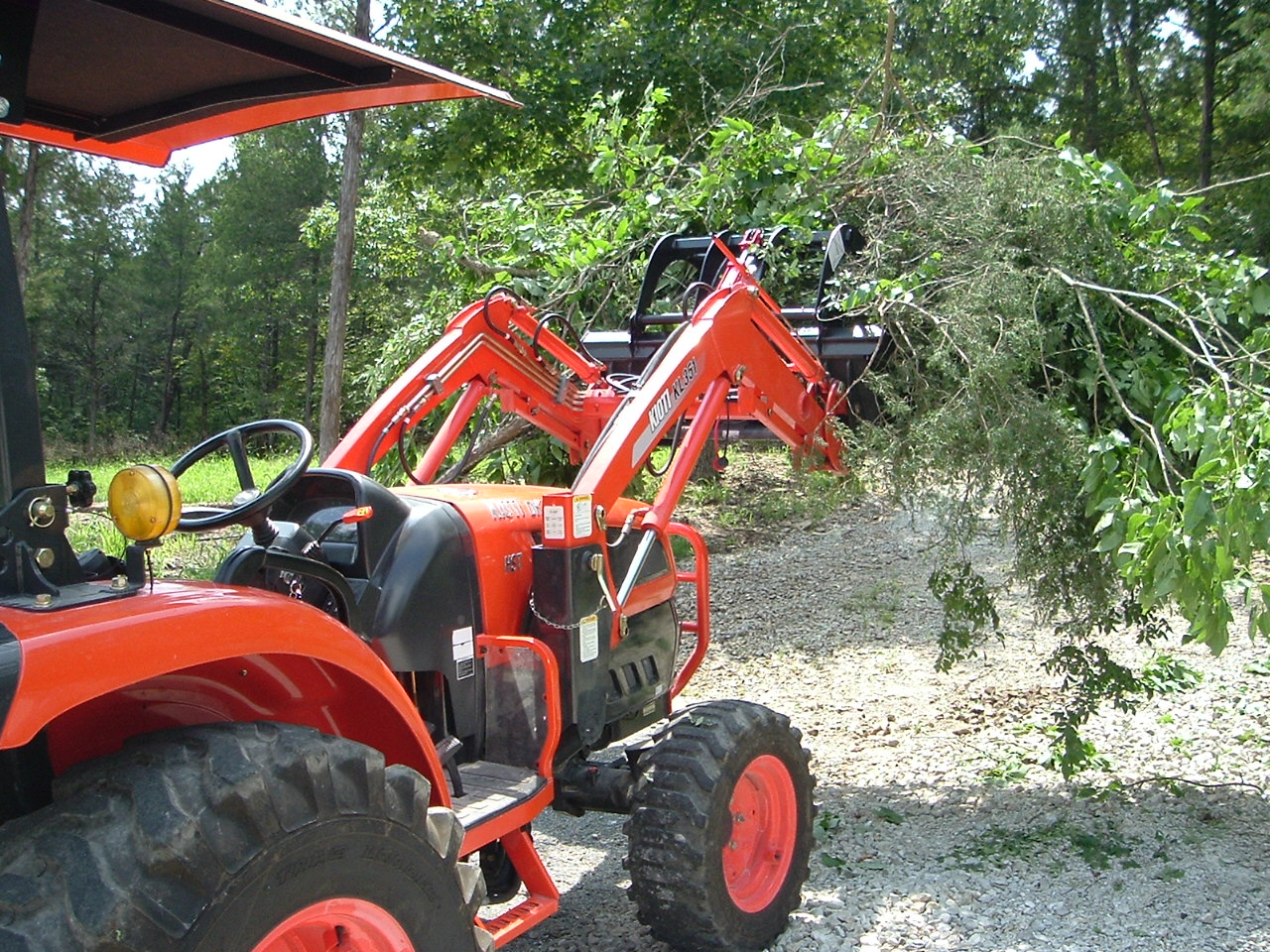

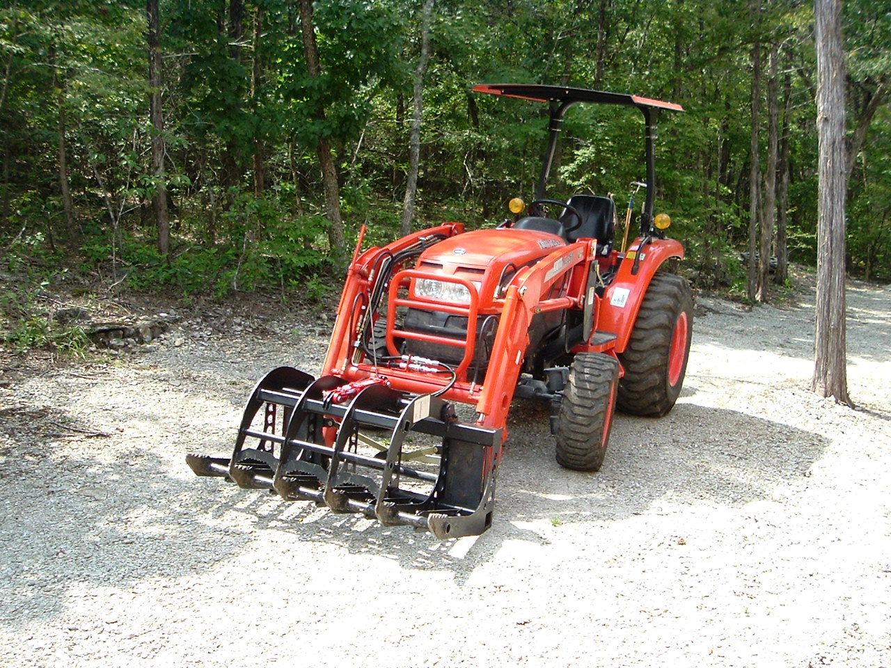

I think anything from 35 to 50 horsepower would be great for you. I also think if you got a grapple you would never be without one again on your property and doing the things you need to do like picking up limbs and clearing brush etc. I have one, and it is dang useful, and I don't have near the amount of work to use it for that you do. A set of pallet forks can be handy too for moving things on pallets. If you don't have a cab, a canopy can be nice to keep the sun from cooking your brains. Mine is steel and handles small limbs pretty well. Just go slow (with all that wonderful control a hydrostatic transmission gives you. :) ) and watch what you are doing around limbs. You would not believe the difference a canopy makes when mowing out in the sun for hours. I found I could easily work in 100 degree heat with the canopy as long as the sun was not beating down on my body and head all day. here are some pictures of my little Kioti DK35se hydro equipped tractor and some attachments. In my opinion (and yes everyone has one) is that it would work fine for your needs.
DSCF0554.JPGDSCF0550.JPGDSCF0551.JPGDSCF0548.JPG090812 007.jpgBranson-20120417-00021.jpg

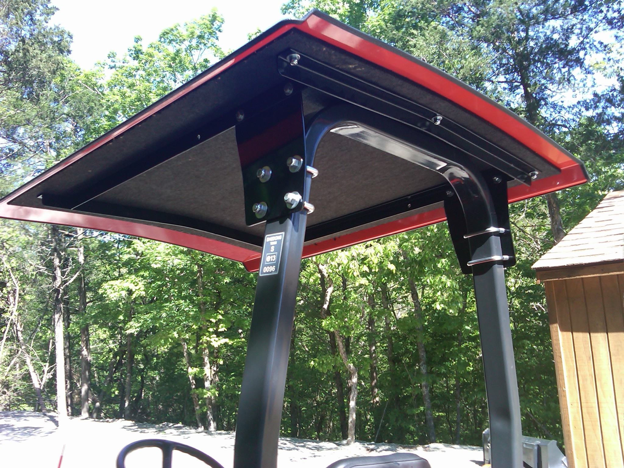

*I like k0ua's comment on getting a metal canopy. I have always planned on getting a canopy, but because I am frugal (cheap) I had earlier priced plastic ones. But he is right, the woods work might tear up a plastic cover but not so much a metal one. I have a plastic canopy on my Mule and it has suffered some abuse just cruising around under my landscaping trees. As we used to say when I was working for a living, At the end of the day, it only costs a little more to go with the LOW bid...
