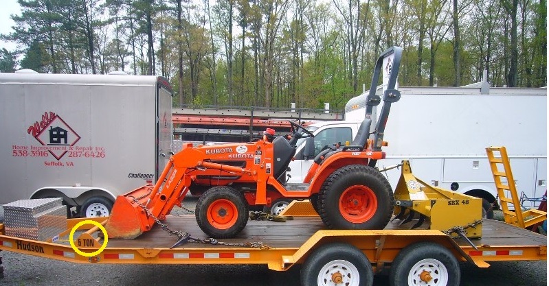

$25K out the door is about what I've spent on my B7610 (23HP), my M4700 (50HP), my trailer and some implements.
2007 B7610, 245 hrs, LA352 FEL, Bush Hog SBX 48 box blade, '07 Hudson HSE Deluxe - 5 Ton 18' foot dovetail trailer for w/ 2 chains and load binders $11.5K from CL in 2009

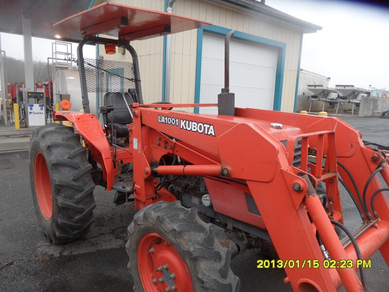

M4700, 1400 hrs, LA1001 FEL $11.5K from auction Jan 2013

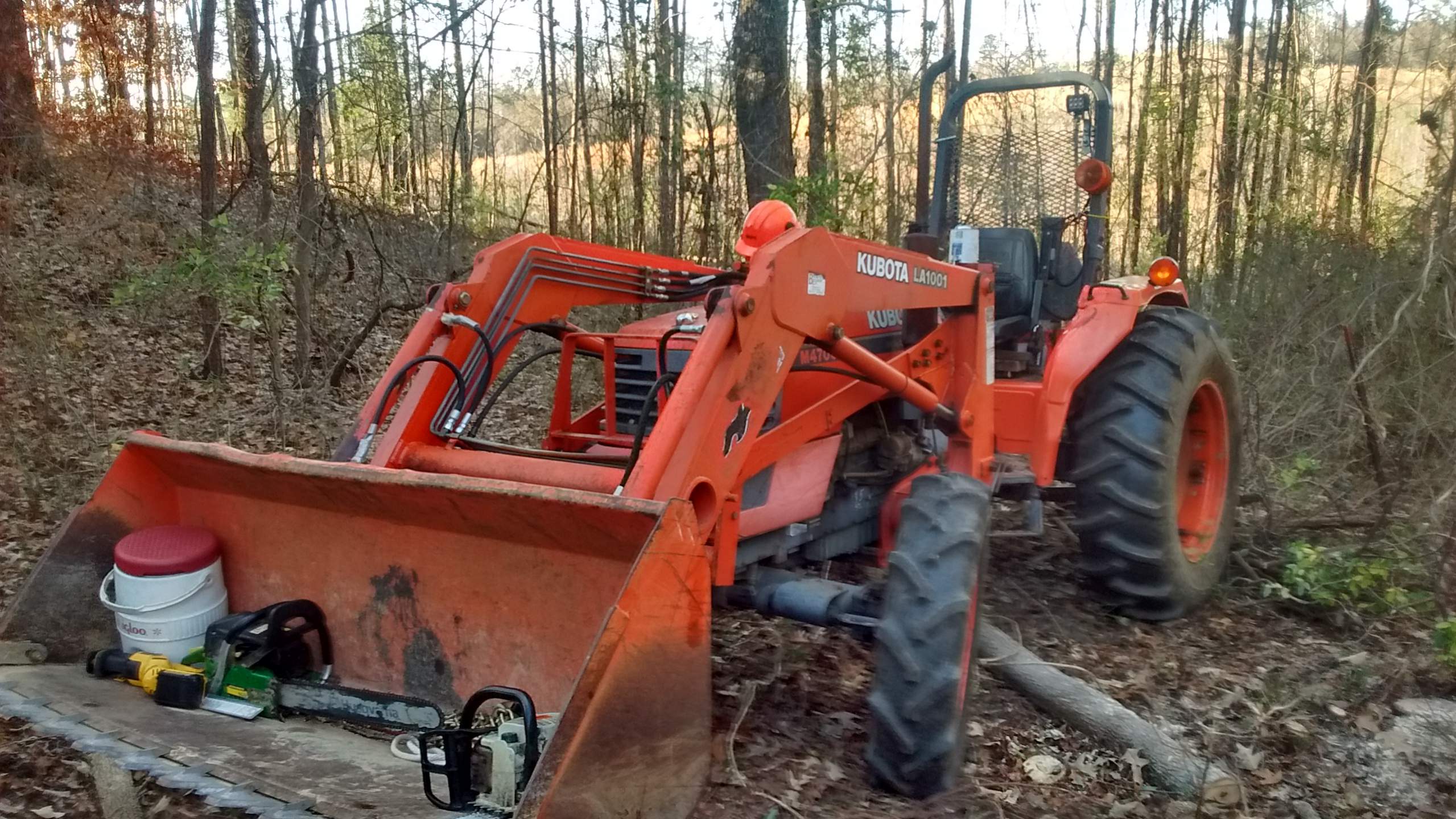

For getting through the woods pay attention to CLEARANCE, the SCUTs are close to the ground. My B7610 is close to the ground, but at about 8".
My M4700
attachment.php
is good for the woods.
