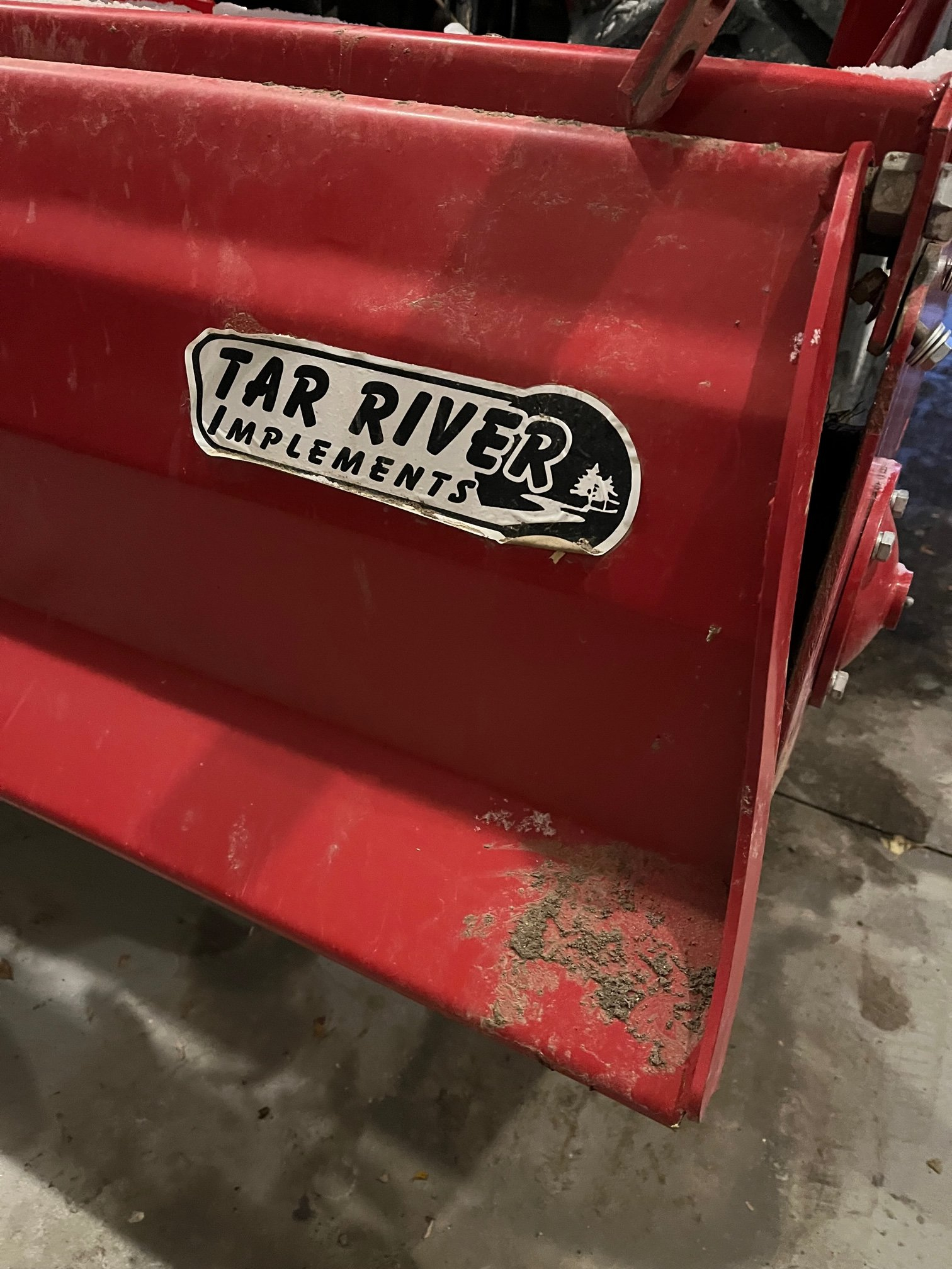

1st year of tractor along with tiller is in the books, and it was a big one. It was a pain for me to put it on, so i left it on most of season. It took a beating because of that, but also very handy to use often. Im missing a few parts I need to put back on and any other end of season you'd recommend?

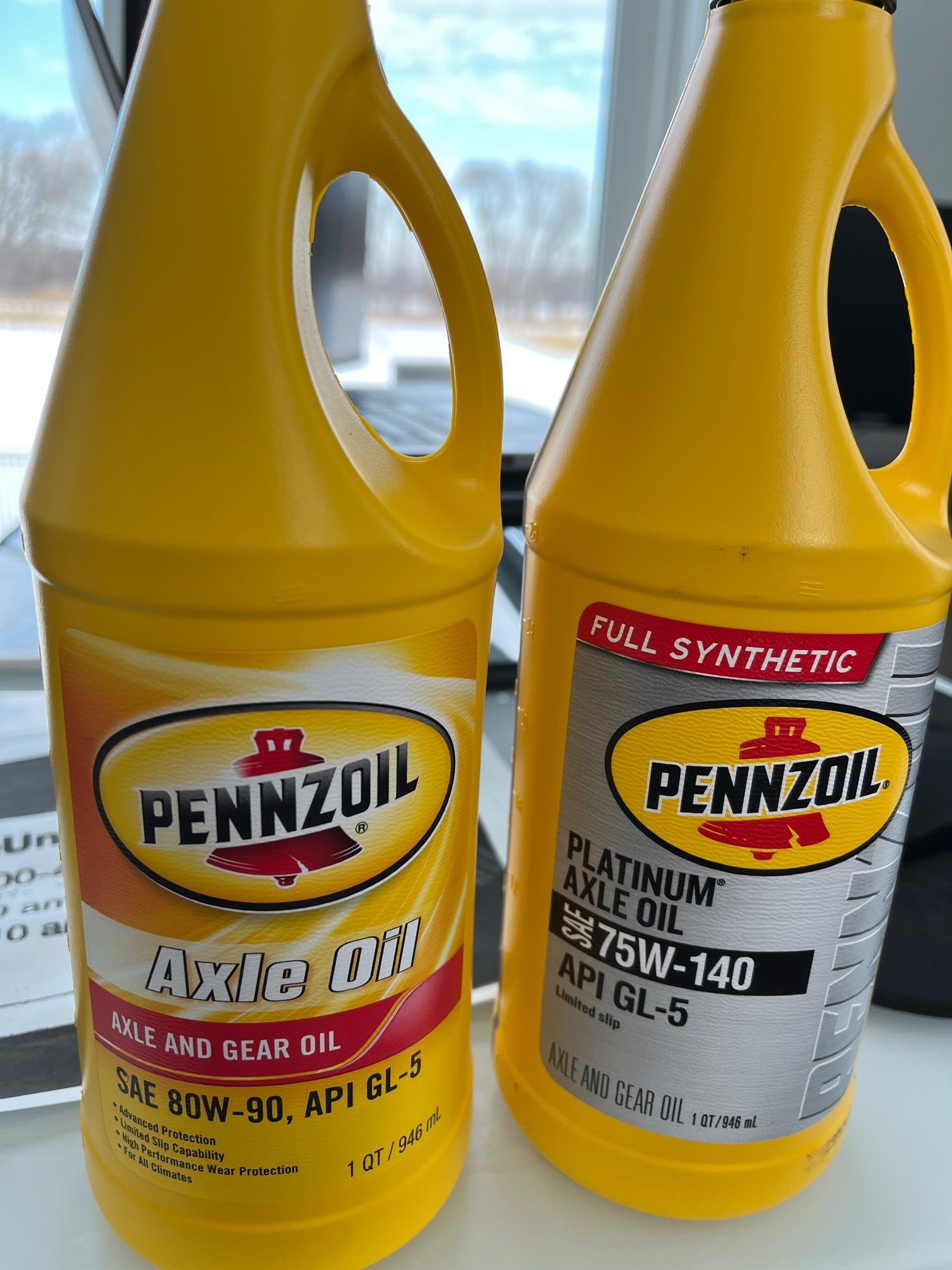

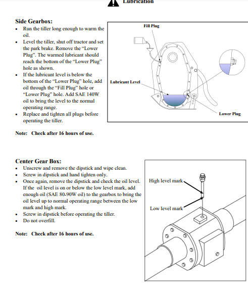

Looking at manual attached, it says side and center gearbox. I went to hardware store and got these two bottles. Look like the right stuff?

The most important points - 1) that both gear boxes have lube. 2) that it is the correct amount 3) that it is the absolute correct weight. Either jug should provide proper lubrication.
