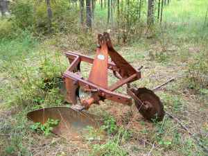

Ford 101, two bottom 16in. 3-point plow, with new shears.
Any idea what this is worth? It looks to be in fair shape from the photo. It most likely is too much plow for my Kubota L3130 though. Yes, it is missing one of the coulters.
Thanks.

without seeing a picture, my initial guess would be $300 to $400. Not having coulters is really not an issue. Most don't have them. My three bottom Ford 101 has none and it works great. Is the trip protection shear pins or spring mechanism?

Here is a picture.

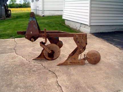

Would go for around $200 around here. I paid $100 for this trip plow and it was only missing one cutting wheel. Picked wheel up at swap meet for $15. Philip.

The spring trip 101 plows are worth more than the shear pin plows. If it does not need any metal replaced Retail would be $300-400 on a shear pin and 400-500 on a spring trip version. Ken Sweet
/ 2 bottom plow Ford 101 #6
Hard to tell from the photo but it doesn't look to be a spring trip. There are several more bolts on the cover plate for a spring mechanism.

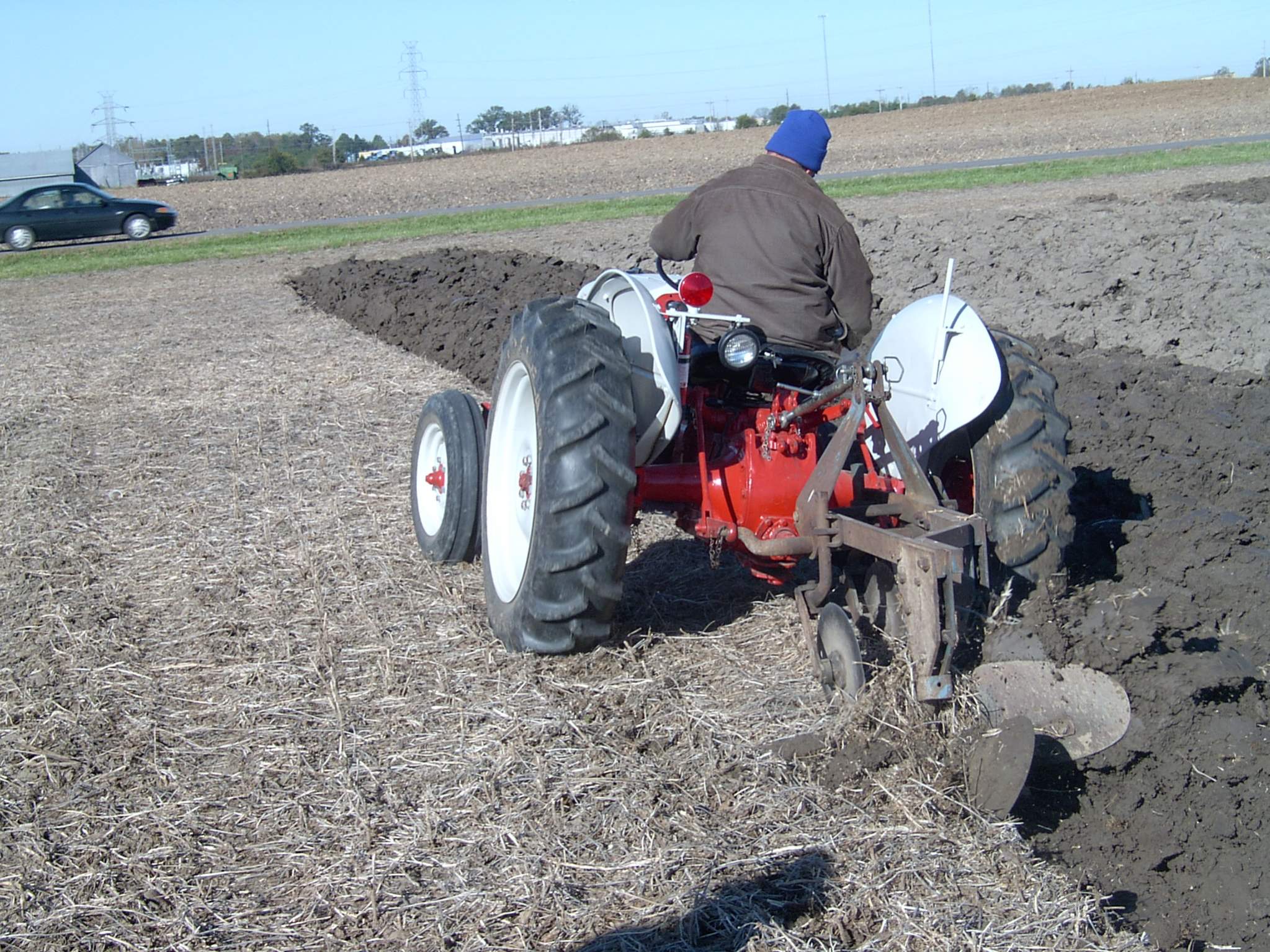

I paid $400 for this one and it needed landslides, shins, and shares.

That is a nice job on the landslide rebuild. Is that a straight cat 1 cross drawbar used for the hitch bar? Ken Sweet
/ 2 bottom plow Ford 101 #8
No, it is a Cat 2 drawbar. The measurements were taken from the original and the Cat 2 welded on as closely as possible.
The adjustments on the Kubota M7040 with T&T make it easy to set up.

If your 3 bottom is setup like the 2 bottom in the picture (about level across the hitch, pin to pin) Then in order to get the plow to run correctly, you may need to screw in your tractor right leveling box assembly quite a lot. The plow should be level with the ground, left to right and front to back after the right tires drop down in the furrow on the second pass. Ken Sweet

Thanks folks, lots of good information. I will take a pass on this one, but know more about plows now.
That's what the Top and Tilt is for. Works great for adjusting the plow to level.
The photo is of the three bottom plow just the third bottom is out of the frame.
